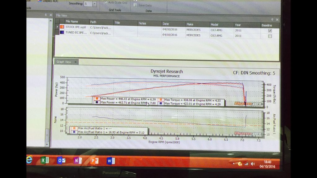

My car made 440ish with just headers
The two graphs are PPP with headers and sports cats 446whp
And with ec v5 tune and headers 462whp
