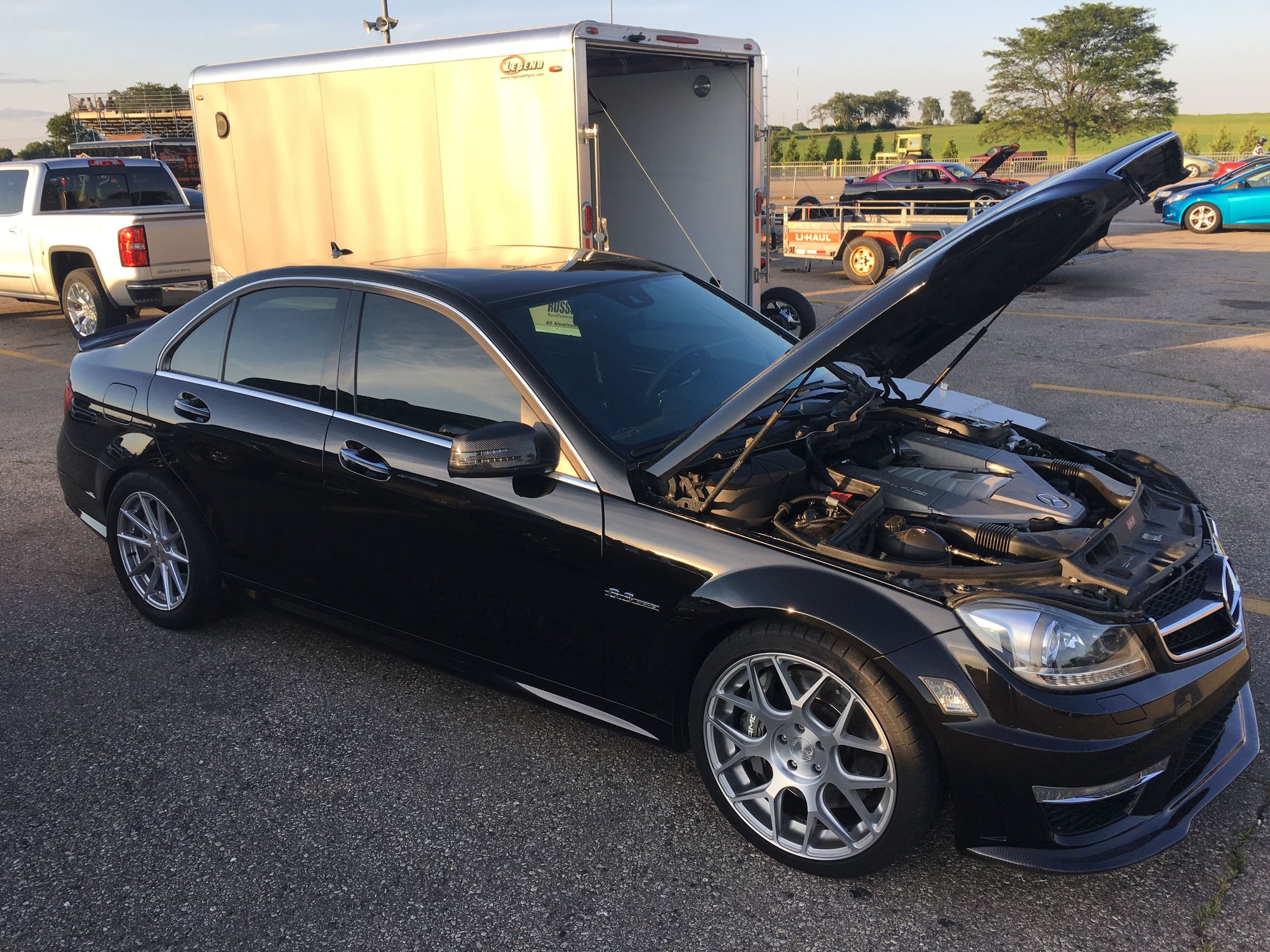

Tsw Bathurst 17x9 et 50 weight 17.8 pounds rim only with a 275 Mt ss radial on the back no rubbing, no trimming, no spacer fits perfect.
