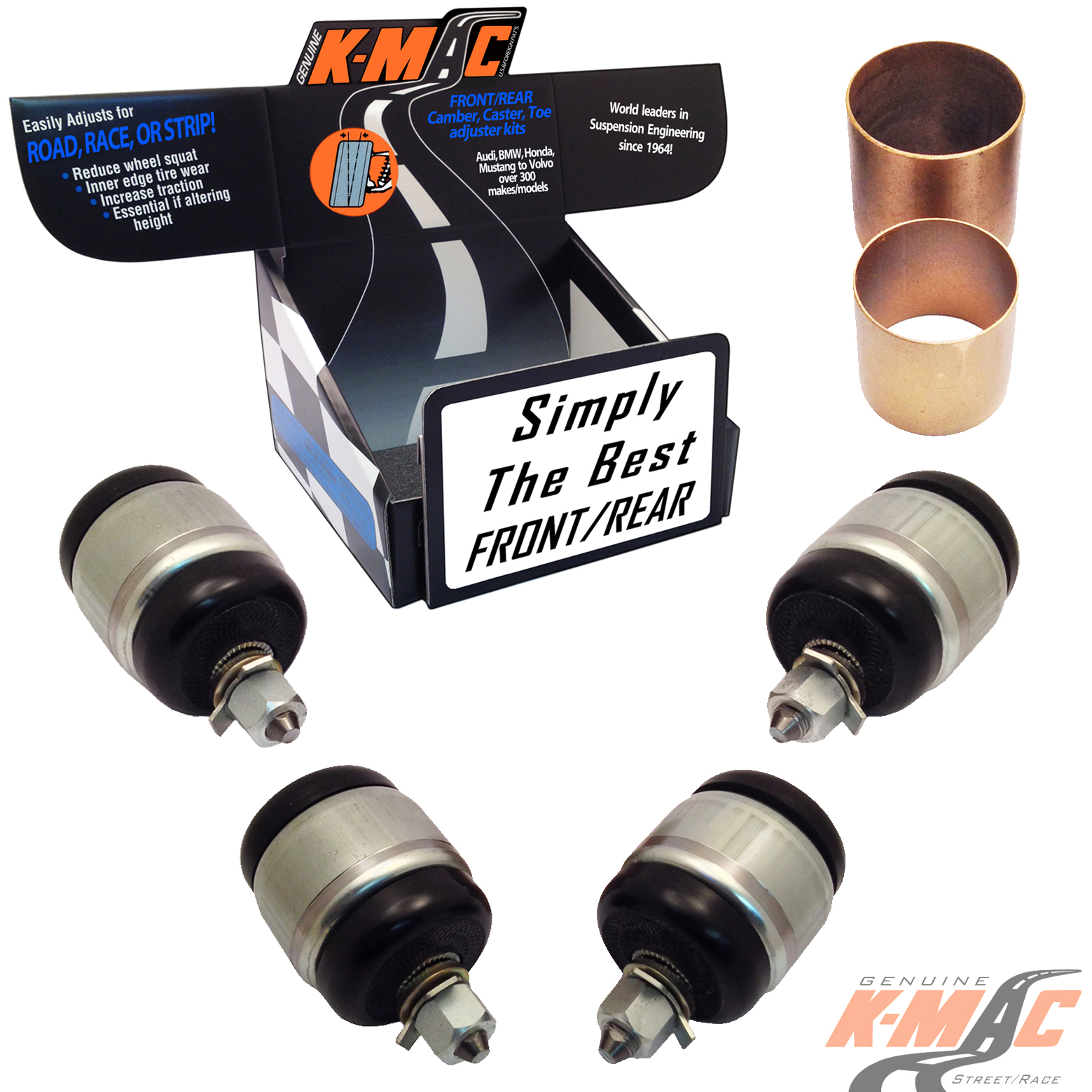

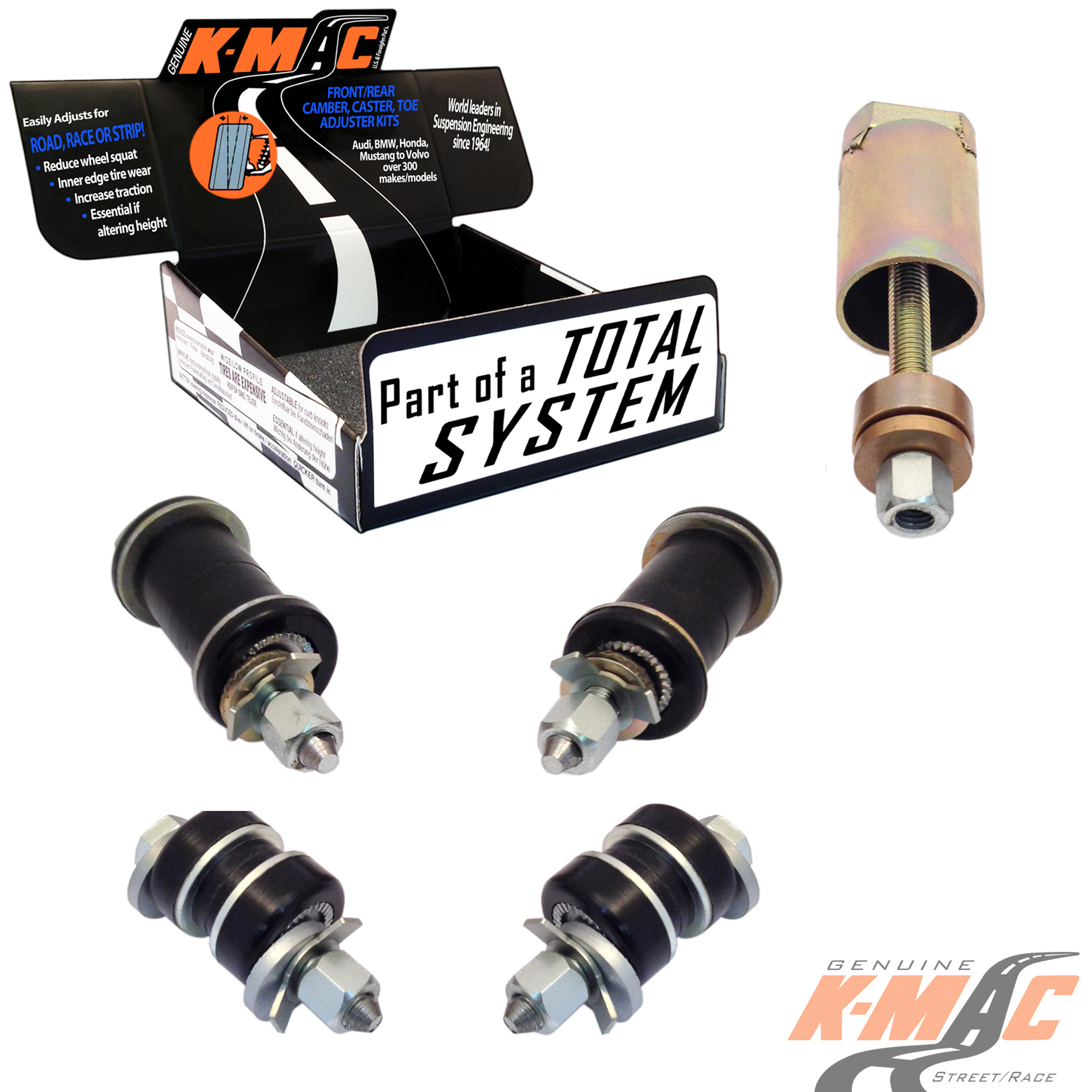

Yes Toe (directional) adjustment is all that is available front and rear OEM.
We manufacture the 4 front and 4 rear highest wearing bushings – replacements that are precisely single wrench adjustable front for Camber and Caster rear kit for Camber and extra Toe (extra Toe is needed to compensate for the new rear Camber facility).
Do not manufacture rear upper replacement Camber arms as difficult to fit, adjust and to resolve premature rear inner tire wear need to adjust top of tire outwards reducing important clearance to outer fender. While K-MAC design adjusts the lower control arm inwards and also the elastomer bush design has more than 4 times the load bearing area of the short life upper arm steel spherical bearings.

Thanks for feedback – quoted above kits for W203 instead of 204!
W204
Front Camber and Caster kit #502616K $480
Rear Camber (and extra Toe) #502226K $480
The K-MAC W204 rear adjuster kit provides up to 3 degrees Positive or Negative Camber (with extra Toe adjustment to compensate).
Patented design allows precise single wrench adjustment – easily accessible on alignment rack, accurately (under load).
Also adjusting the lower (not upper) arms retaining important clearance between top of tire and outer fender.
While Front Camber (and Caster) bushings provide up to additional 1 degree – 3 times the adjustment of the (one position) fluted bolts. These 4 mono ball design bushings also replace the 4 front highest wearing bushings with noticeably improved brake and steering response.
Also manufacture (coil spring models) replacement front top strut mounts (no modifications). Precisely Camber and Caster adjustable – up to additional 3 degrees Negative or 1.5 positive.
Another popular kit manufactured is uprated replacement bushings (12) for the ‘6’ multi link rear arms. Providing significant improvement to rear end stability, less twitch/flex, improved traction especially when applying power to lane change/overtake #502628K $480.
