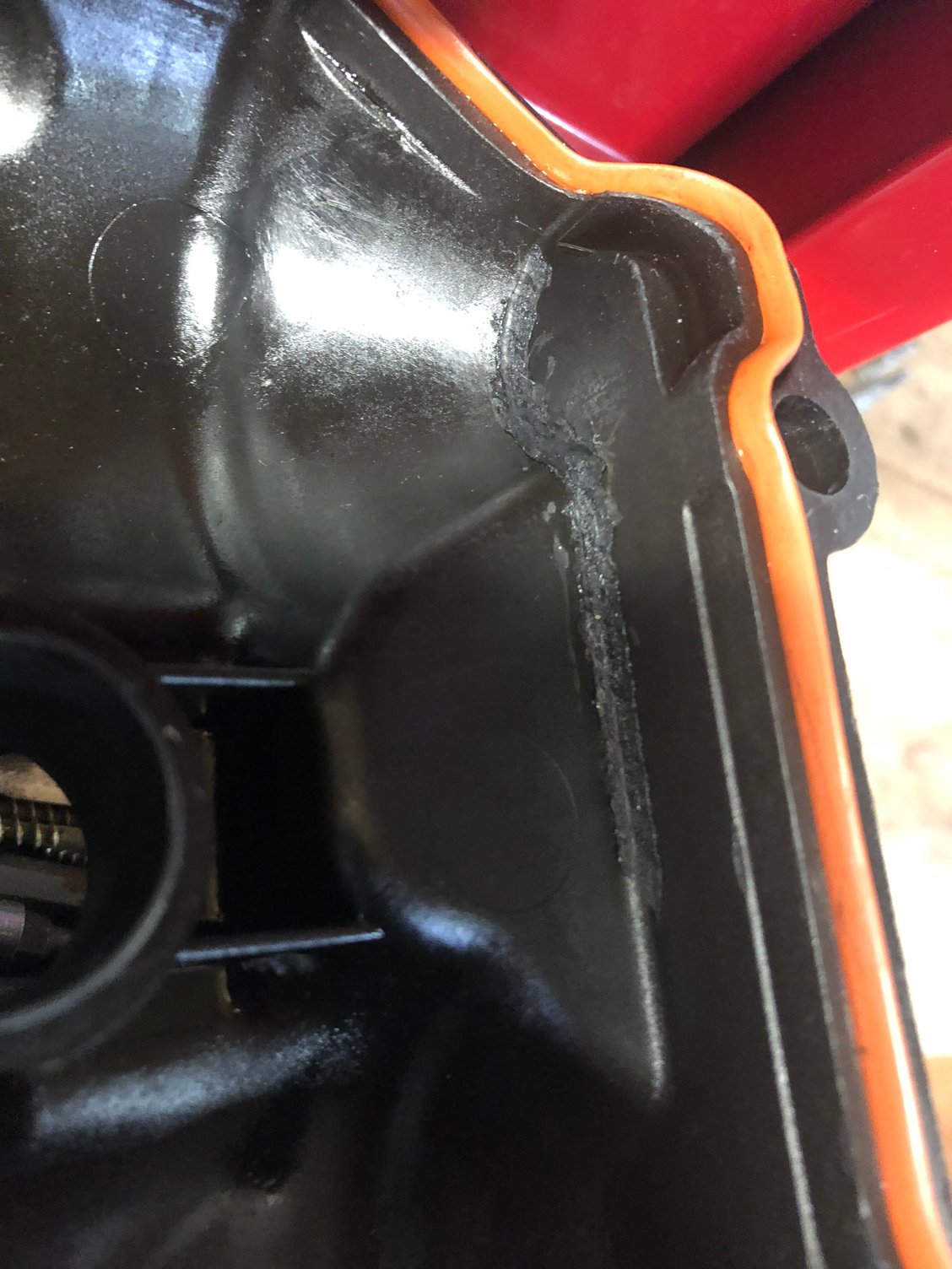

that sucks...maybe you can plastic weld it.
Reply 0
Feb 22, 2019 | 01:53 PM
Quote: that sucks...maybe you can plastic weld it.
already did, will see how it holds!
That looks very well done! What tools did you use? Is it holding up well?
