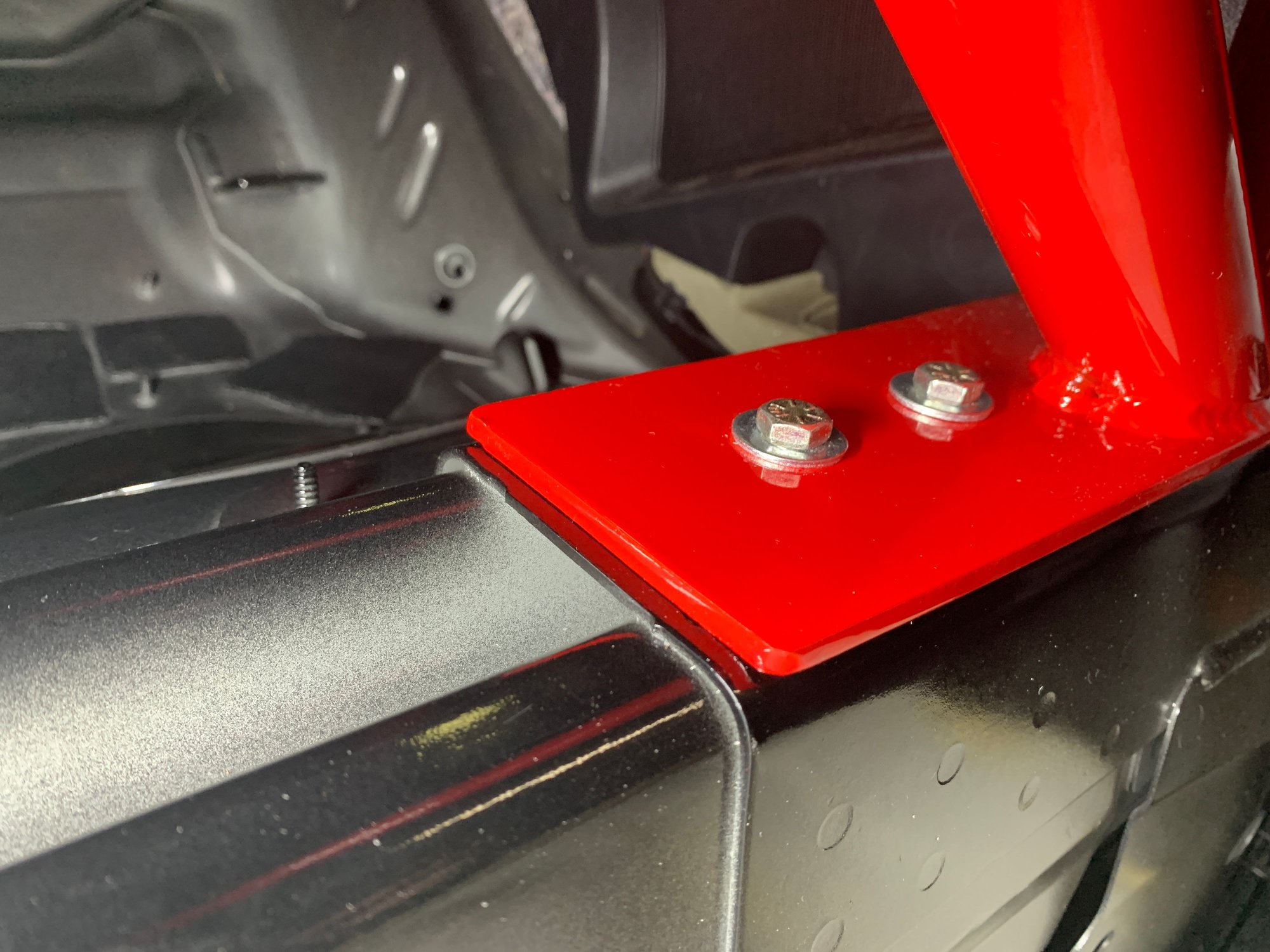

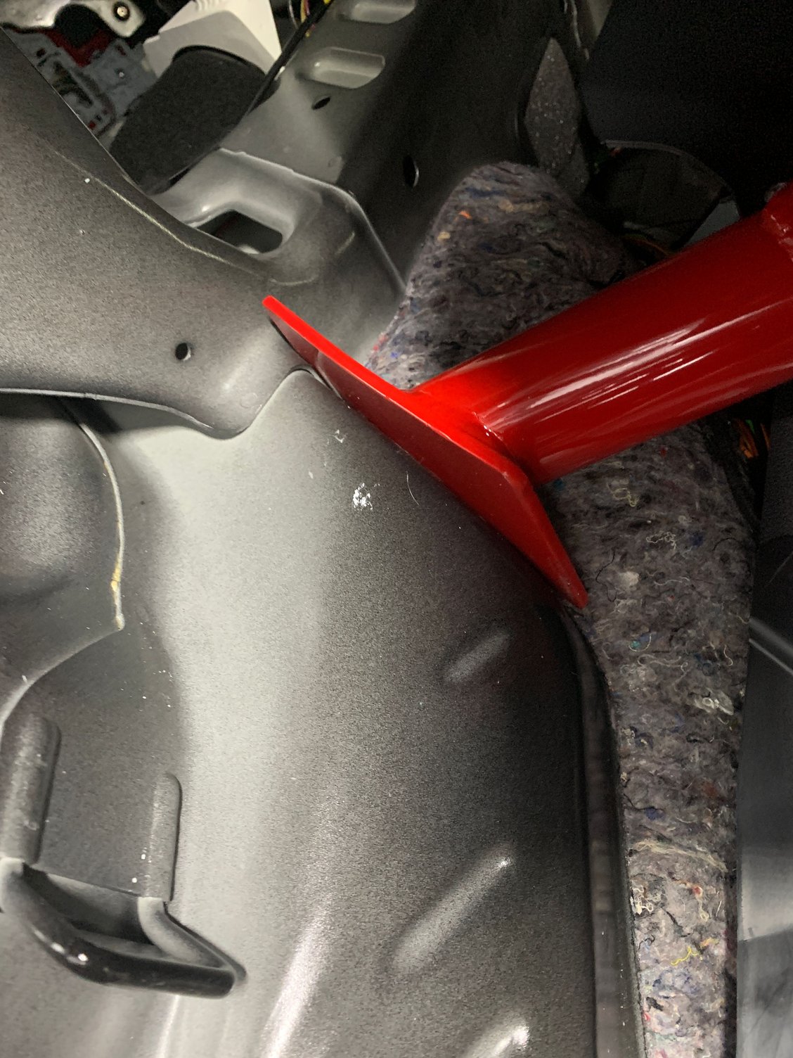

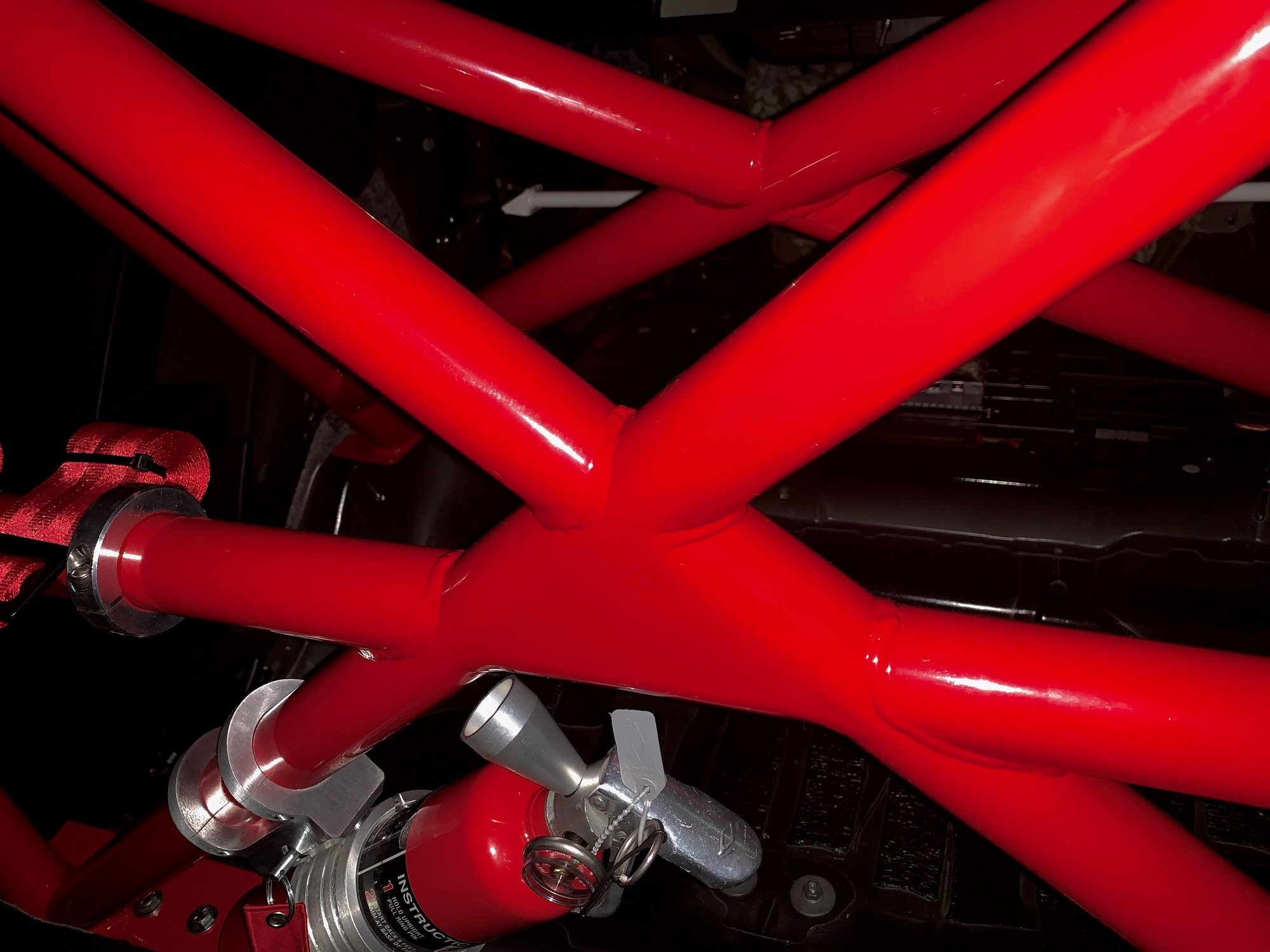

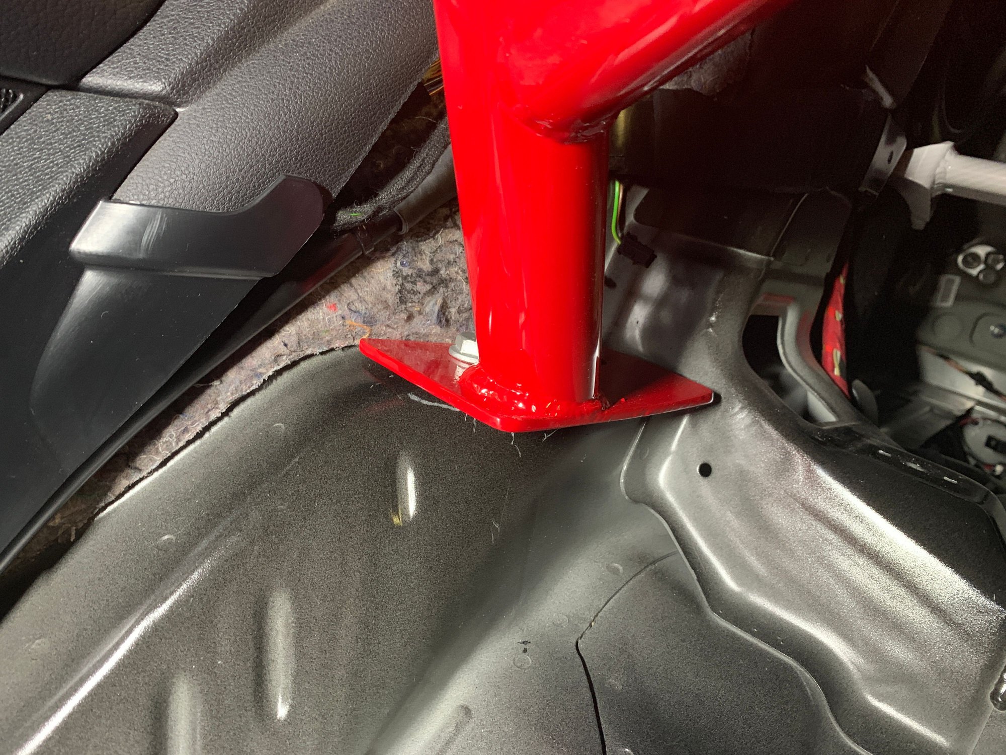

So. I finally got a free weekend to put the Studio RSR cage in and try to finish the seats and harnesses etc.
Let me first say that it dropped in perfectly. Fit and finish are impeccable.
BUT.... this is not really a rollbar. At least not an effective one as designed. Think of this as a super pro-looking harness bar. The reason is problematic mounting points.
Here is the bar in the car. Pretty sweet looking.
First issue. Front mounting point is on top of some sort of super hard welded plate (had to use up two concrete drill bits just to get through) that bridges a channel. This point is probably not so bad, but there’s space underneath the plate, and then there’s the raised bit of the floor that made up the thigh support for the back bench. I don’t think this area would survive a rollover, and those legs would slip off the bump anyway.
Here are the rear mounting points. These are just dangerous IMO. The plates on either side slide right in place, and you can even use the OE 10.9 seatback hardware bolts. Now look at how the bar terminates on the plate. I took two angles to show that there’s nothing but air under the rear bar ends. In the event of a rollover, 100% that those plates break. There’s literally no support.
So, while I get that it was advertised as a drop-in cage and was going to have some compromises, I’m a little disappointed that it fails in such a critical area. Will be giving this feedback to the Studio RSR guys, as I think the design could be modified to address these issues while still remaining “bolt-in”. While the bar material and construction might be to NASA spec, the mounting points probably won’t even pass a cursory inspection. Maybe I can modify this bar to be better secured on the rear points.
Right now, this design, I couldn’t recommend. Let’s see if it’s something that can be fixed...

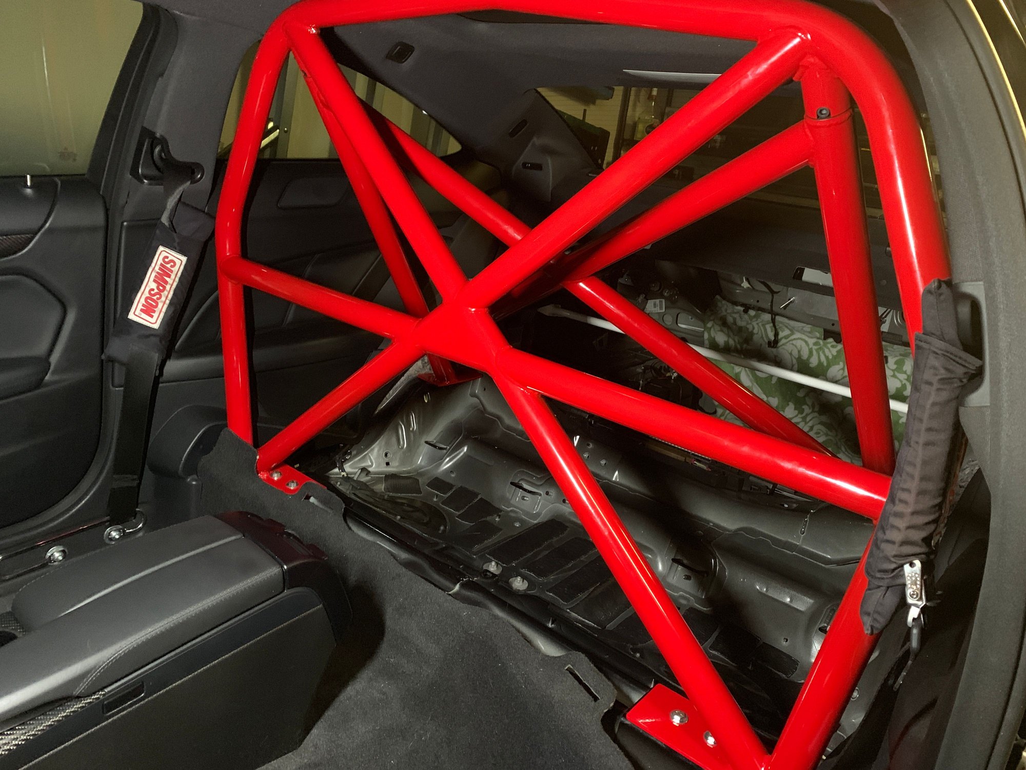

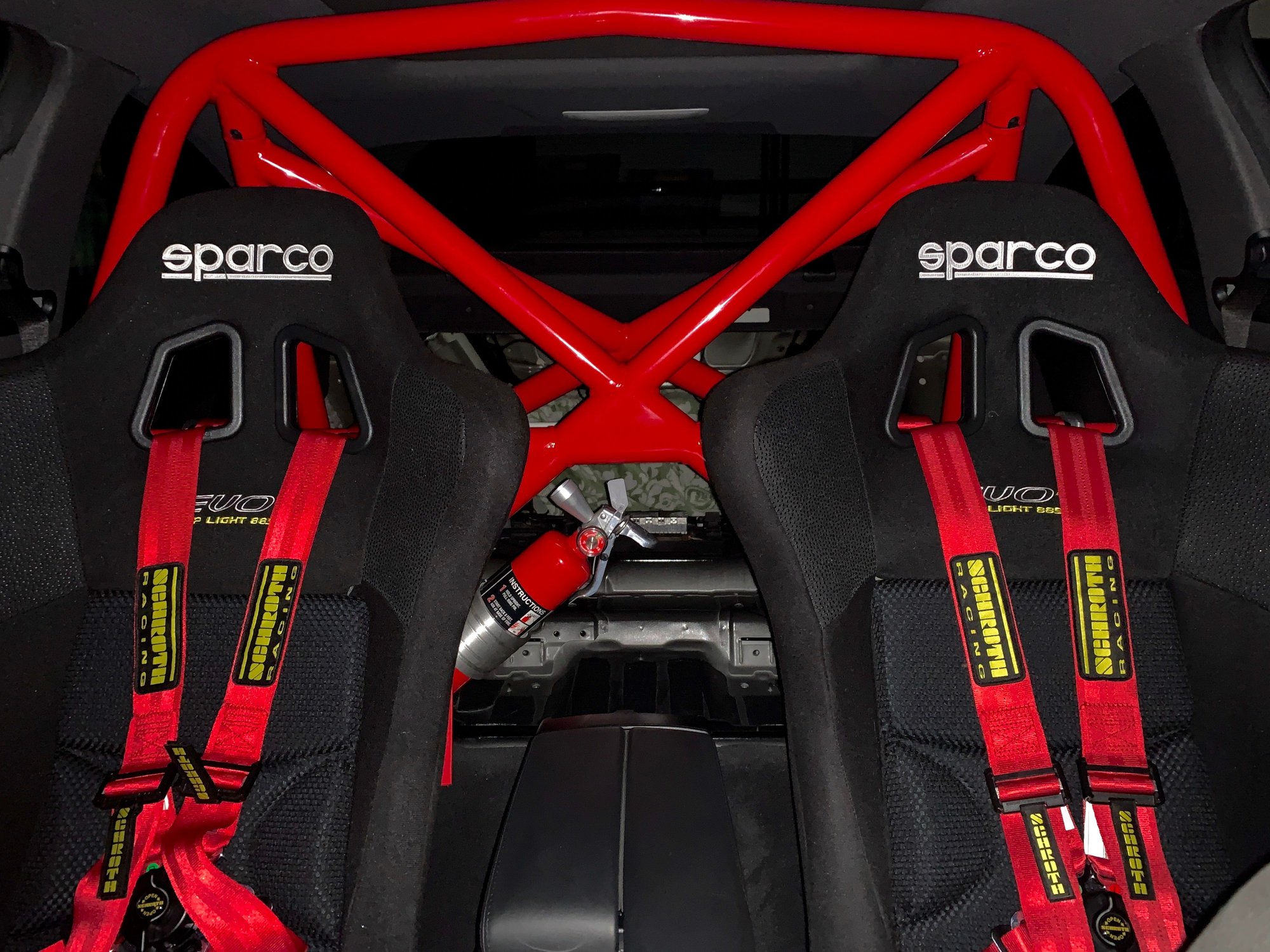

Have been making progress. Slowly. Every time I dig further into the car I find something else to repair/replace. This week it’s new front hubs and rebuild of calipers, new dust shields with 3” hose adapter welded on for brake ducts, installed Hella horns, etc. Well, the interior is done at least...
Studio RSR Rollbar
Sparco Evo II Seats
Planted base and side mount brackets
Schroth 6-point harnesses with other bits
Looks pretty good in there I think

Originally Posted by BLKROKT
Sparco Evo II Seats
Do you sit lower with this setup? With my seat all the way down at the back I'd still like to be another inch or two lower.
Old Jul 29, 2019 | 02:39 PM
  #94
BLKROKT's Avatar
Joined: Jun 2008
Posts: 8,074
Likes: 2,867
From: Los Angeles
2012 P31 C63 Coupe Trackrat, 2019 GLE63S Coupe Beast
Pretty much same as I sat with OE seats, side brackets are on the highest setting. If you forgo sliders you can get really low, probably 3” lower.
I should add that I sat in the OE seats with the seat bottom all the way down in back and up in front. So the additional 3” of adjustment will get the seat 1” off the floor if you want.
Excellent. Yeah, I won't be using sliders.
I’m starting to think that I should take the sliders out because they are practically useless. With the space limitations you only have maybe 6” of adjustment forward and back, and with no back seat what’s the point. However the steering wheel is already at its lowest setting and perfectly placed for how high I have the seat. I don’t know if I want to be any lower but stability would improve.
It's also stronger/safer without sliders. What's the rake like right now? Can you take pic from the side with the door open?
