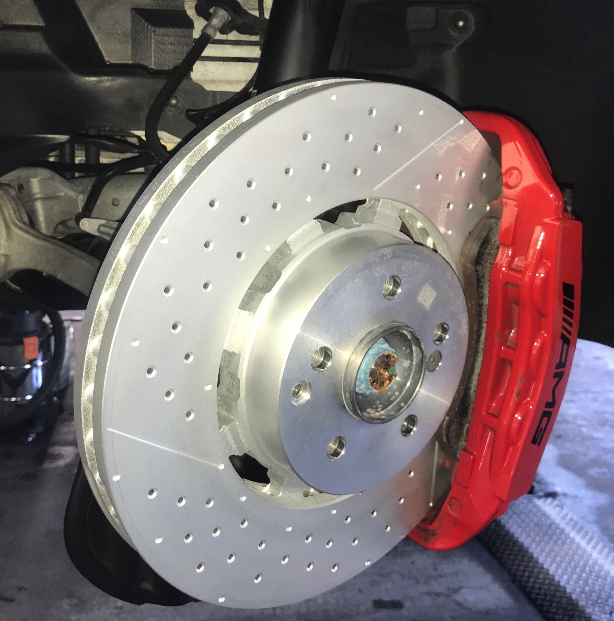

how many miles ? if you're looking to upgrade and need new rotors Racing brake has excellent options with a lightweight 2 piece version, as well as pads if you just need those...

Rotors from FCPEuro... Mercedes Disc Brake - Brembo part # 2124210512B
Pads from GLOC - R16s fronts/ R12s rears...
