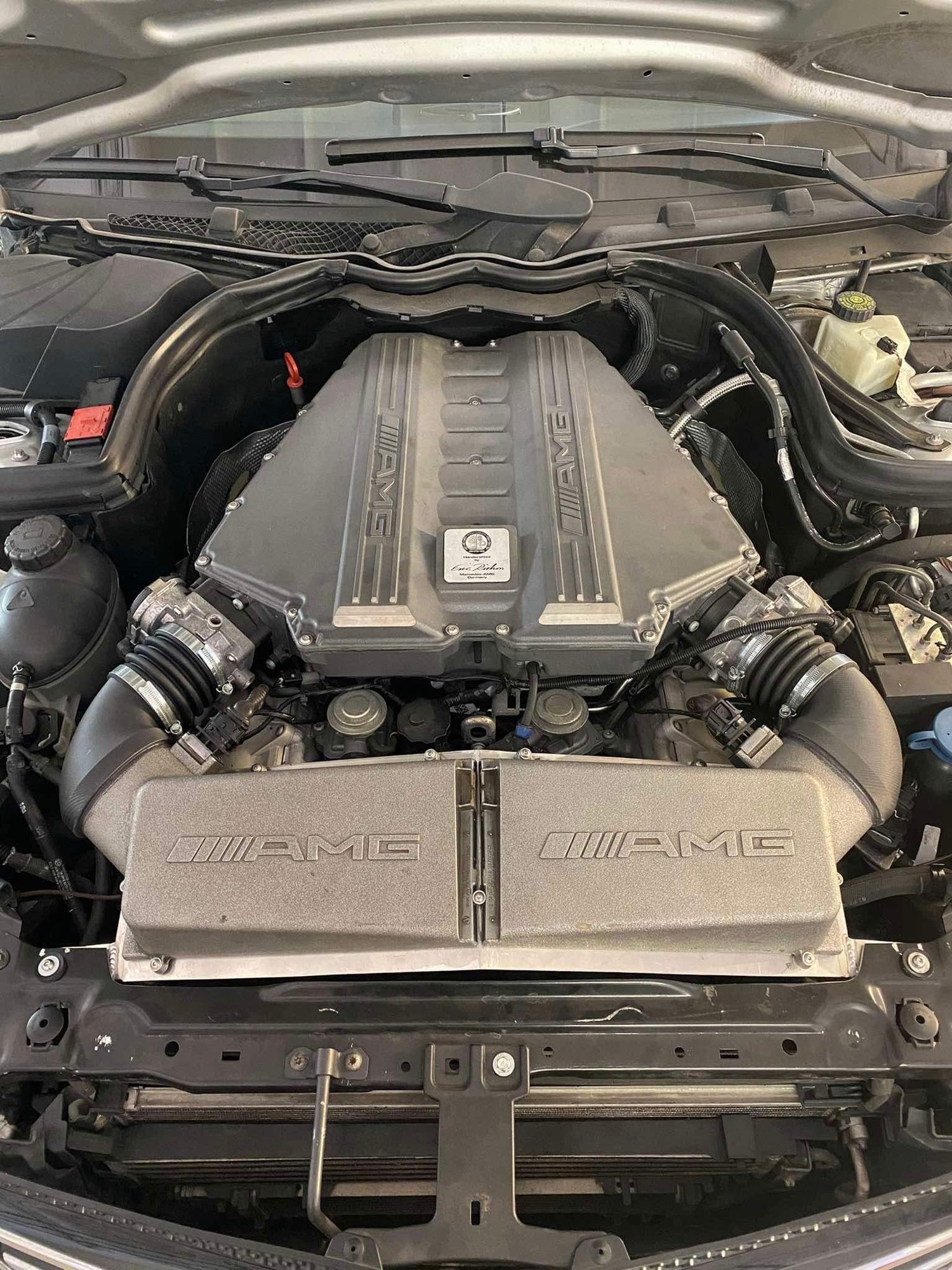

I just finished installing everything
From my experience, beware - on prefacelift models, the hood won’t close no matter how much of inner hood structure is cut - I had to modify engine mounts to make it fit, but it’s finally there
I just need to find a tuner who can make good online tune for it, since I can’t find anyone in Poland who can make it happen… any leads? Can you give me any suggestions?

Highly recommend Vano @ V-Tech. He tunes all kinds of custom builds from superchargers, turbo, cams and fuel setups.

This was done by GAD in Germany…

PTG would be my vote. Awesome job sticking with stock airboxes / mafs. very creative.

+1 to GAD, they're closer to you in Europe, and fully understands the environment & fuel usage that is available to you; on top of that, it's a safer bet to go with someone that has tuned multiple examples of the same setup, rather than someone that may be reputable yet has not tuned a setup like yours.
