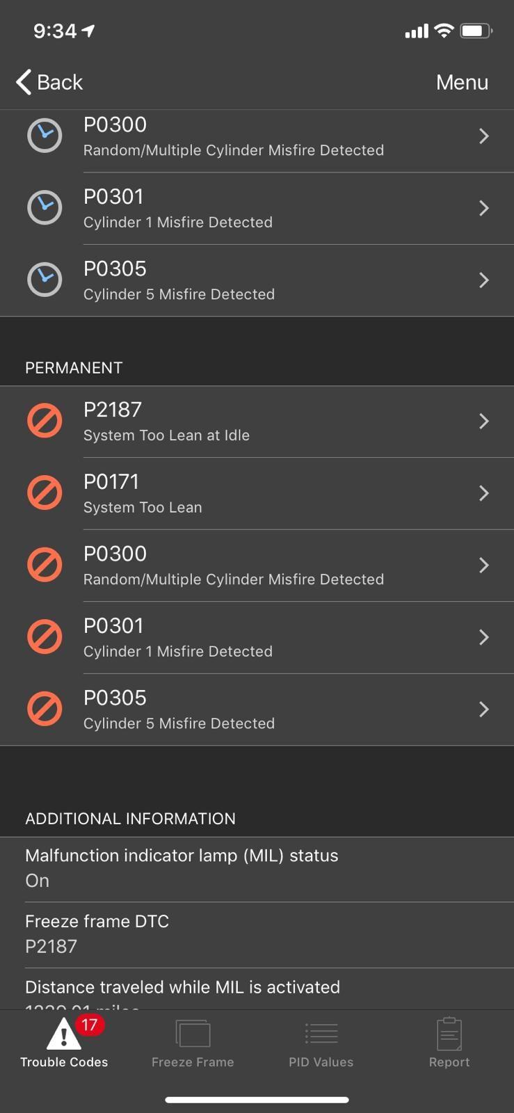

Hi, I've gotten these codes on my 2011 C63 amg, has anyone had these before? What are the most common fixes?

[QUOTE=AMGBOGI;7704392]Hi, I've gotten these codes on my 2011 C63 amg, has anyone had these before? What are the most common fixes?
What scanner are you using?
Its a "BAFX products" scanner on amazon about $26
What did you find when you searched the codes? They have been discussed many times with all the solutions available.

Maf
Maf sensors, 02 sensors, spark plugs, however when I had a dealer inspect it they told me its a "deformed air intake pipe", been trying to get the part number but they haven't been helpful with providing it.

I replaced the MAF gasket and intake gasket that connects to the MAF and that fixed.the problem on mine
