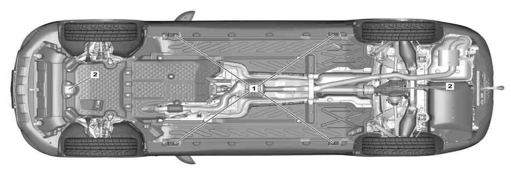

Old May 18, 2026 | 06:45 PM
galaxyexplorer's Avatar
Joined: Nov 2024
Posts: 12
Here are the designated jacking points according to Mercedes WIS.
