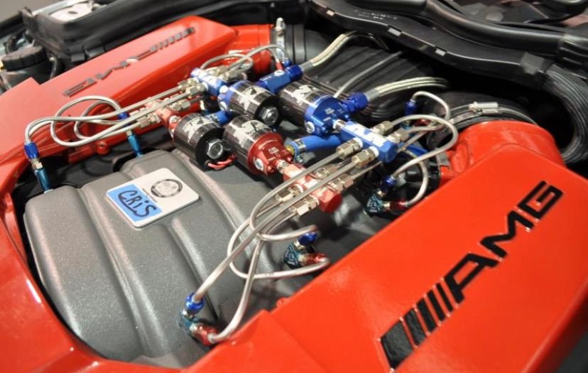

Direct port is the way to go for ultimate atomization and power. But comes at a price and way more components to worry about. That would definitely need a built trans to handle 200shot of direct port spray. With good tune that’s scratching 700 whp on this car with no heat soak... dry system you need a tuner that really knows wtf they are doing or things can go bad quick.
found this direct port setup on an old thread...

Discrete ^

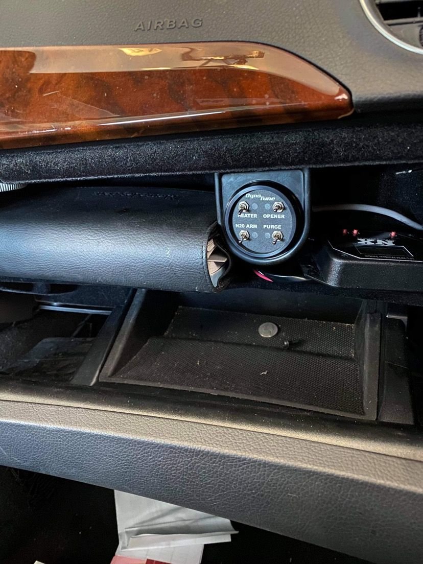

Originally Posted by Helamanofa
So I’m going to be running a 75-100 shot with no tune as someone above explained in detail that you don’t need a tune for this. Couple questions, do I need to upgrade my injectors to 550 if I have LTH? Also, as i am new to nos completely, when I want it to activate, would a boost controller be the part where I can flip a switch or would these kits only activate when I am WOT or somewhat around that since people where saying that above as well? Sorry for the inconvenience feel like I’m nagging after reading the ruthless threads from this forum
I personally would never run Nitrous without fine tuning it. For me it’s about a peace of mind. Spend few hundred dollars more and have a safer peace of mind is worth it to me. But this is subjective.
I run 630cc. On E85 as well. I run off a window switch. Sprays depending on what I set the WOT/RPM to. For example, currently I have set to spray at 4500 rpms and stop spraying at 7000 rpms, @ 90% throttle position. I’ll mess with it at times. There are people who spray all the way through the powerband.
You flip the switch in the panel (in the picture above in the glovebox) and whatever you have your window switch set to, it’ll spray based off that
