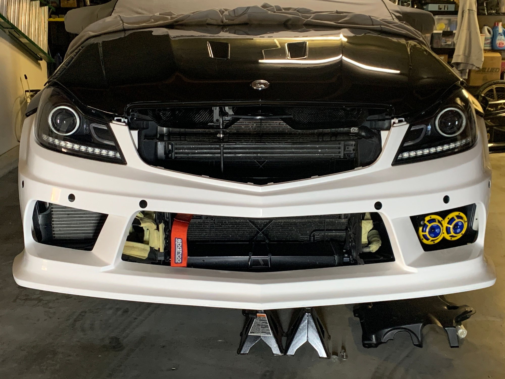

Front bumper cover weighs 5lbs vs about 20lbs for stock. Absolutely perfect fit, better than OE even. This will make taking it on and off all the time much easier, I can do it with one hand. Everything lines up correctly to the fenders so you could even just run the bumper without the rest of the kit if you wanted.

Good to see that the fitment is spot on.
What is the bumper made of?

FRP. You can see the weave in the backside pics.

This is rad because you're wasting NO time! Looks killer. And nice to hear how something aftermarket DOES indeed fit and function properly

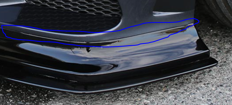

Yes, there’s a separate splitter. I haven’t unwrapped it yet. May not even use it. It’s supported by adjustable struts as seen on Vader_C63’s car above. They’re not functional as in weight-bearing, just for show. Will have to reengineer it to be truly functional, or I may add a larger APR splitter down the road with a quick-connect to a mount on the frame that can take load. I’m pretty far from that point.

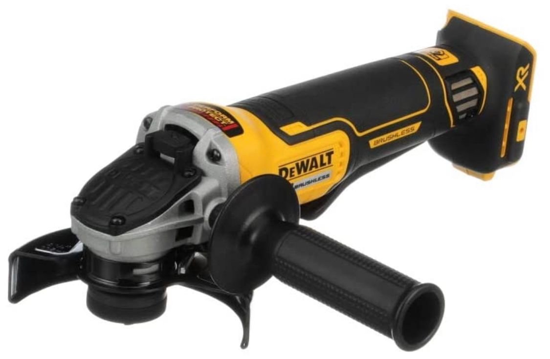

Just an angle grinder to it eh?
Old Apr 16, 2020 | 06:01 PM

2012 P31 C63 Coupe Trackrat, 2019 GLE63S Coupe Beast
