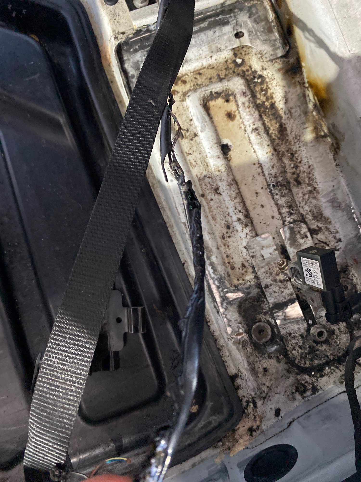

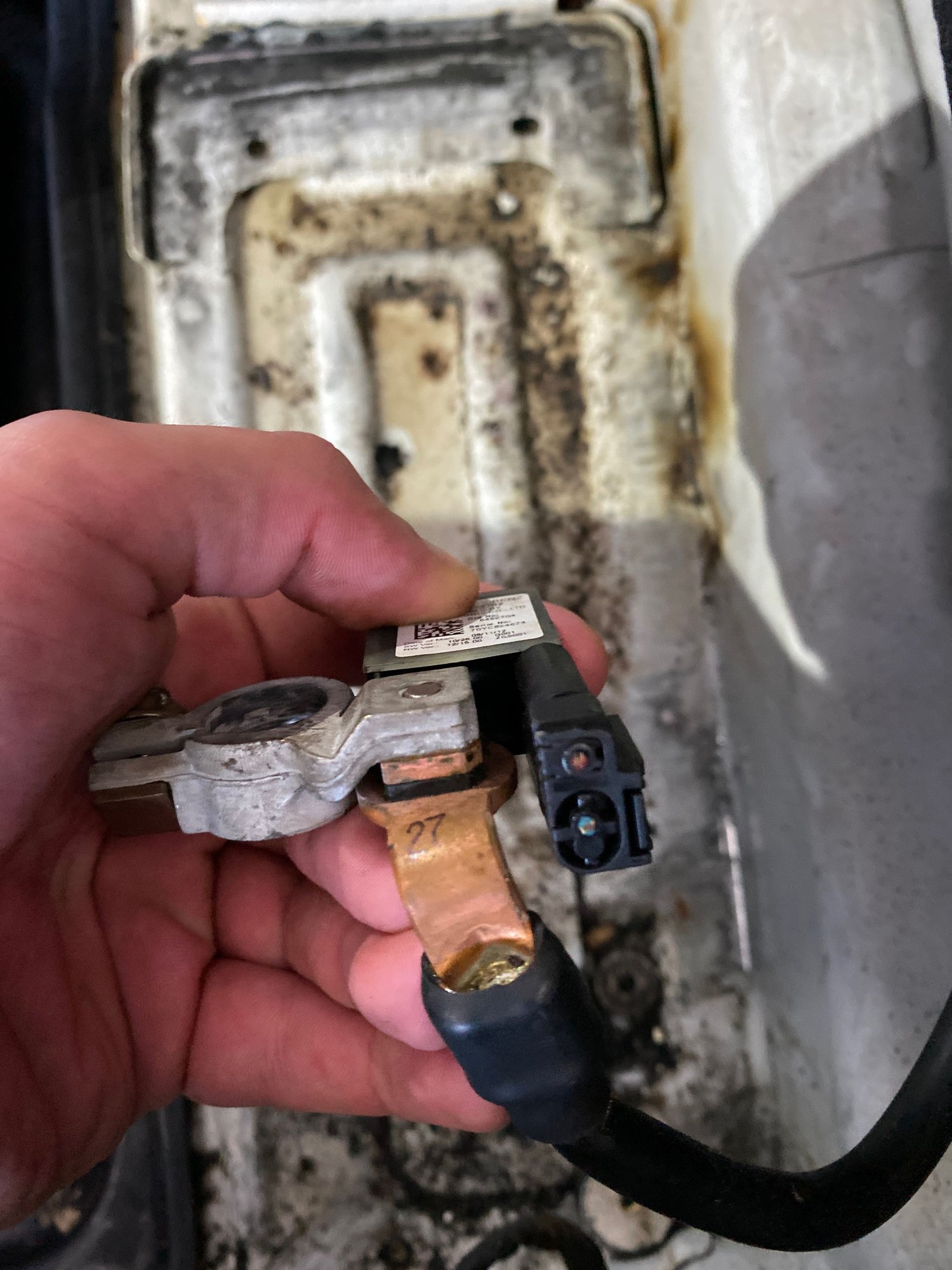

Hello everybody, yesterday found a problem with wiring cable that goes from the negative an positive terminals of battery(photo)
does anybody knows what these wires are responsible for
thanks everybody!
This wire goes from the negative relay
This is relay
Top cable burn out on positive terminal

thats for the battery sensor. Basically determines current battery draw and voltage to decide if it needs to open relay 30g while the car turned off. Never seen one burnt like that. Im going to guess someone repaired it at somepoint and connected it incorrectly or swapped pins.

Looks like a fire started back there seeing all the melted plastic

Finally dealer answered that the battery was not enough fixed and it rubbed the wire
