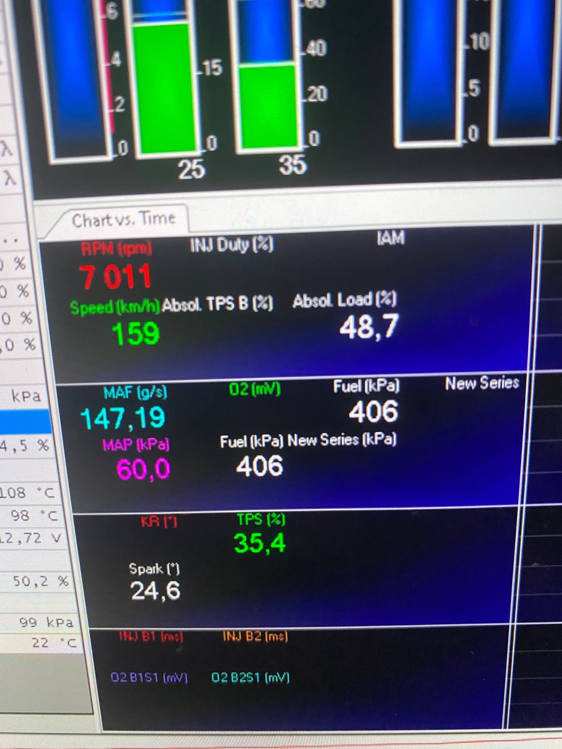

What is normal fuel pressure for c63 amg w204, I have 406kpa on 7000rpm, is it normal?

53 to 58 psi...as rpm's rise you'll get closer to 57-58 psi.
406kpa converts to 58.8853 PSI
