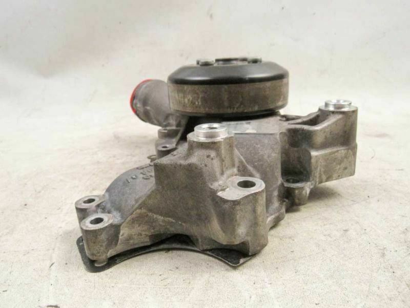

it rubs just to the right of the mount there.

is it just me or does it seem like the base of that pulley mount has been worn down 3-4mm? Maybe I'll have to pull my pulley's off and take photos for comparison.

It looks to me like your previous pulley caused serious damage to the mount before it grenaded. It may not be the UPD pulley that is the problem but rather the mounting stub that is worn. It looks like the part on the front of the engine will need to be replaced or maybe repaired (if possible). Pretty sure it is part of the water pump part# 156 200 06 01 80 (includes the gasket). https://www.getmercedesparts.com/v-2...em--water-pump
Sorry, I know that is a bit of a bummer and not really what you were hoping to hear.

No that looks correct I think, could just be a casting variance on his.

you're obviously not seeing the ridge cut into the inner most ridge of the base of the dowel.
to my eyes it looks like a 2-4mm cut. but would need to compare with another unit up close and probably with measurement to be sure.

I do see what you are referring to, however 2mm would be max, looks like 1mm at most. If it is 2-4mm he could do a quick test using a washer, or leave it that way if it works out.
I am assuming from his description that the rubbing is where the green arrow is, and that it could be wobbling due to the variance in wear between the sides (red arrows).
Right, that's the feeling I've had that I haven't wanted to admit! Luckily its the water pump and not part of the actual block.

Washer would prob space it properly as blurred suggested. Could be a temp fix until you get it properly sorted out.
