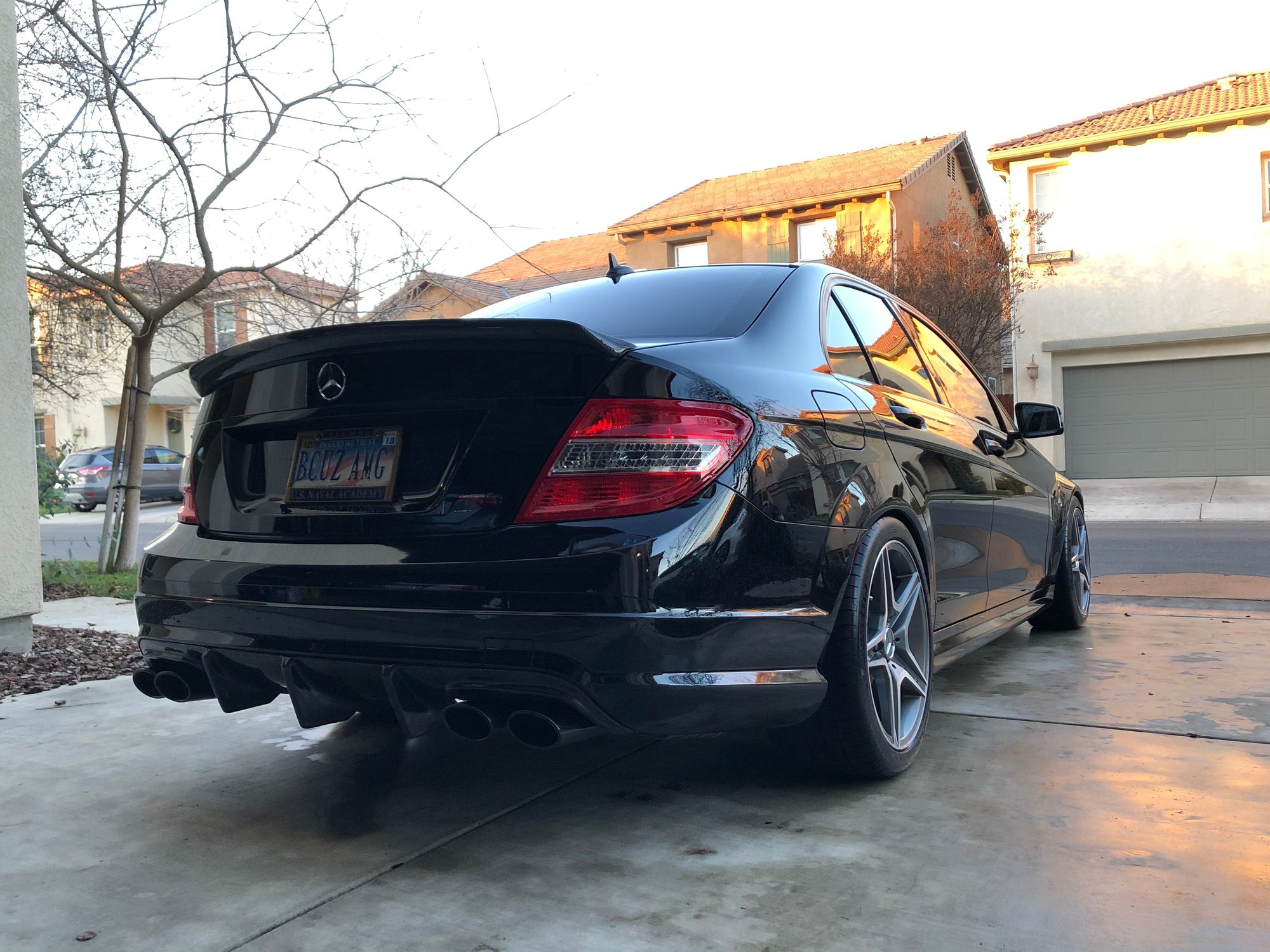

When I had the car. H&Rs w/17mm rear spring pads, PS4S 265/235, 15mm front, 12mm rear spacers. No rubbing.
Reply 1
Feb 5, 2021 | 04:43 PM
That set up looked really good.
Both F&R seem to have a fair bit of negative camber
