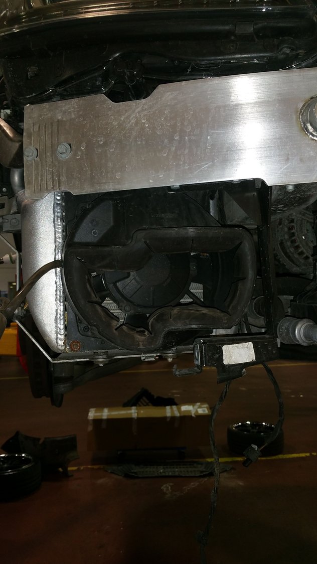

When the oil temp goes above 107 C the aux oil cooler fan kicks in until the oil temp drops below 107 C. It sounds exactly like the sound in your videos. The fan and radiator are located at the front bottom left and vent into the front passenger wheel well. It is perfectly normal. Next time let the car idle for a bit and it will go off when the oil temp drops below 107 C.

Here's a picture of it on mine before I had the 44O kit installed:
