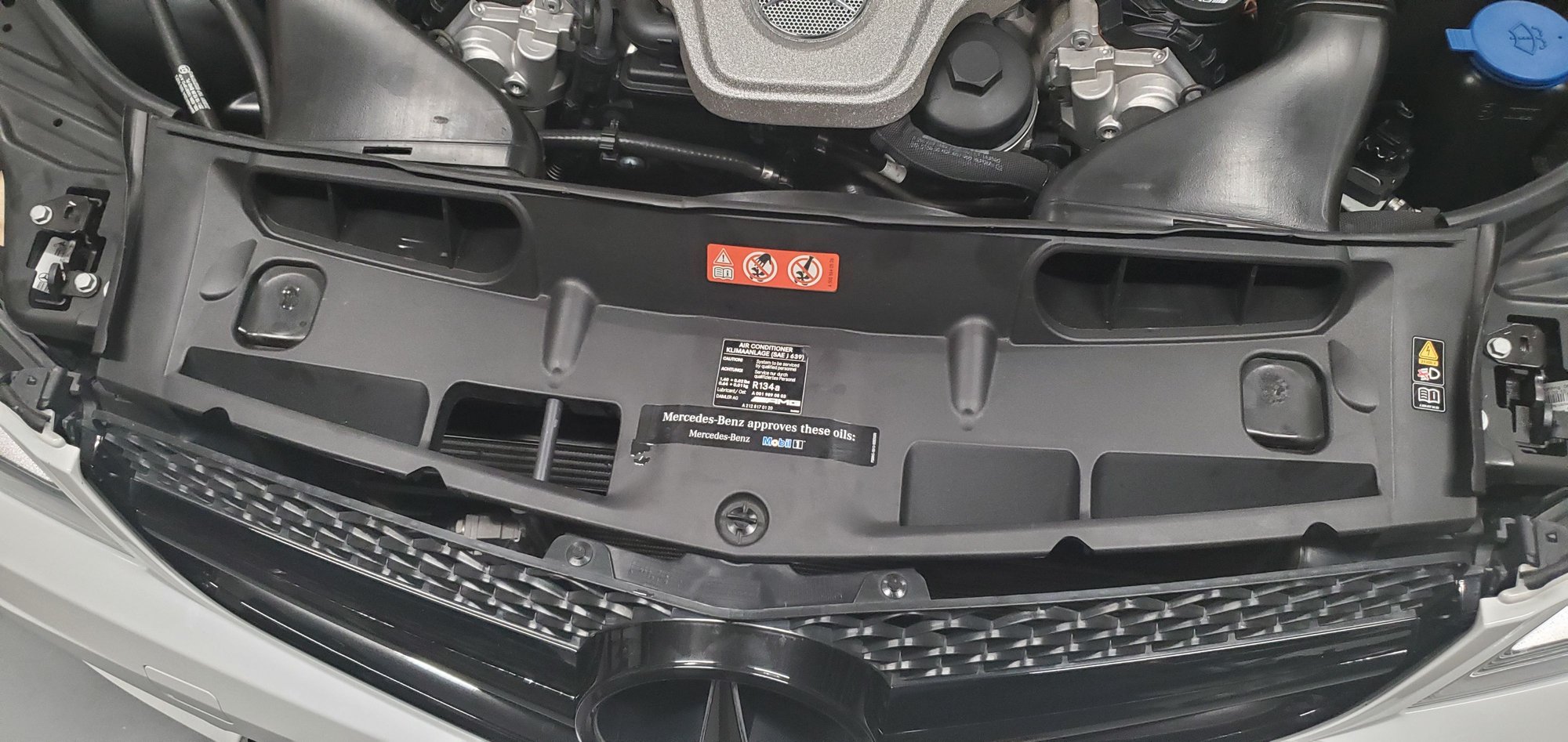

While I was looking at space for a catch can I decided to pop off the cover over the radiator support and handle the illuminated star problem.

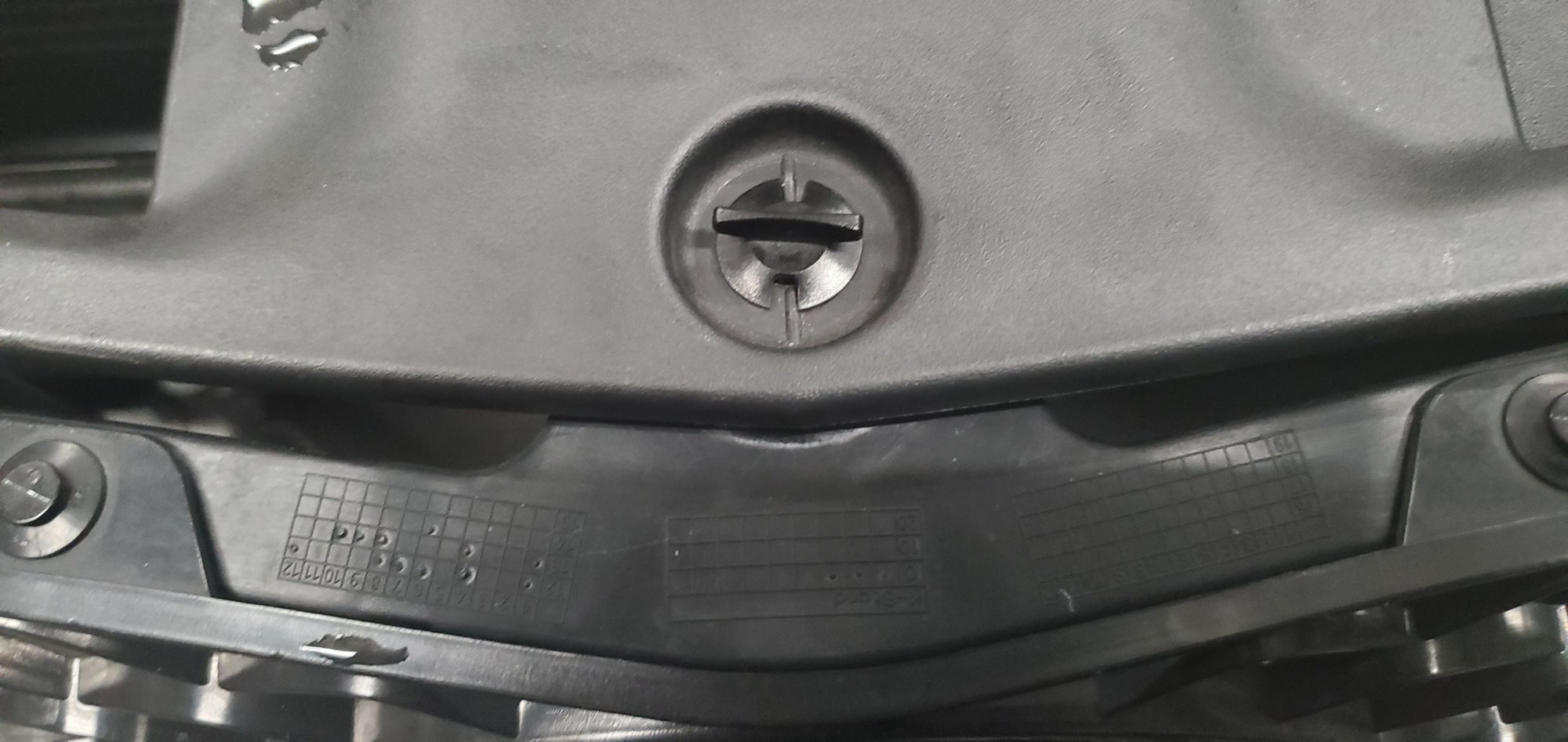

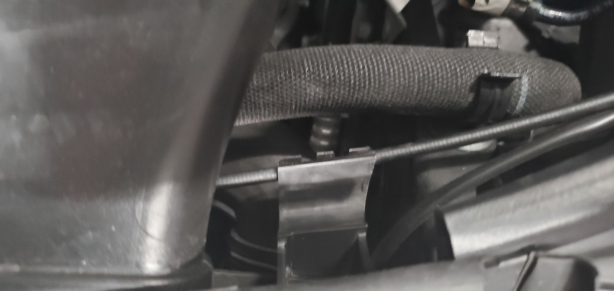

The cover pops off with no tools, you just rotate the pushpin in the center to disengage it, unhook the hose from the tab on the passenger side rear of the cover, unhook the cable from the tab on the drivers side rear of the cover, press down on both tabs to unhooked them from under the support and slide the cover off.
