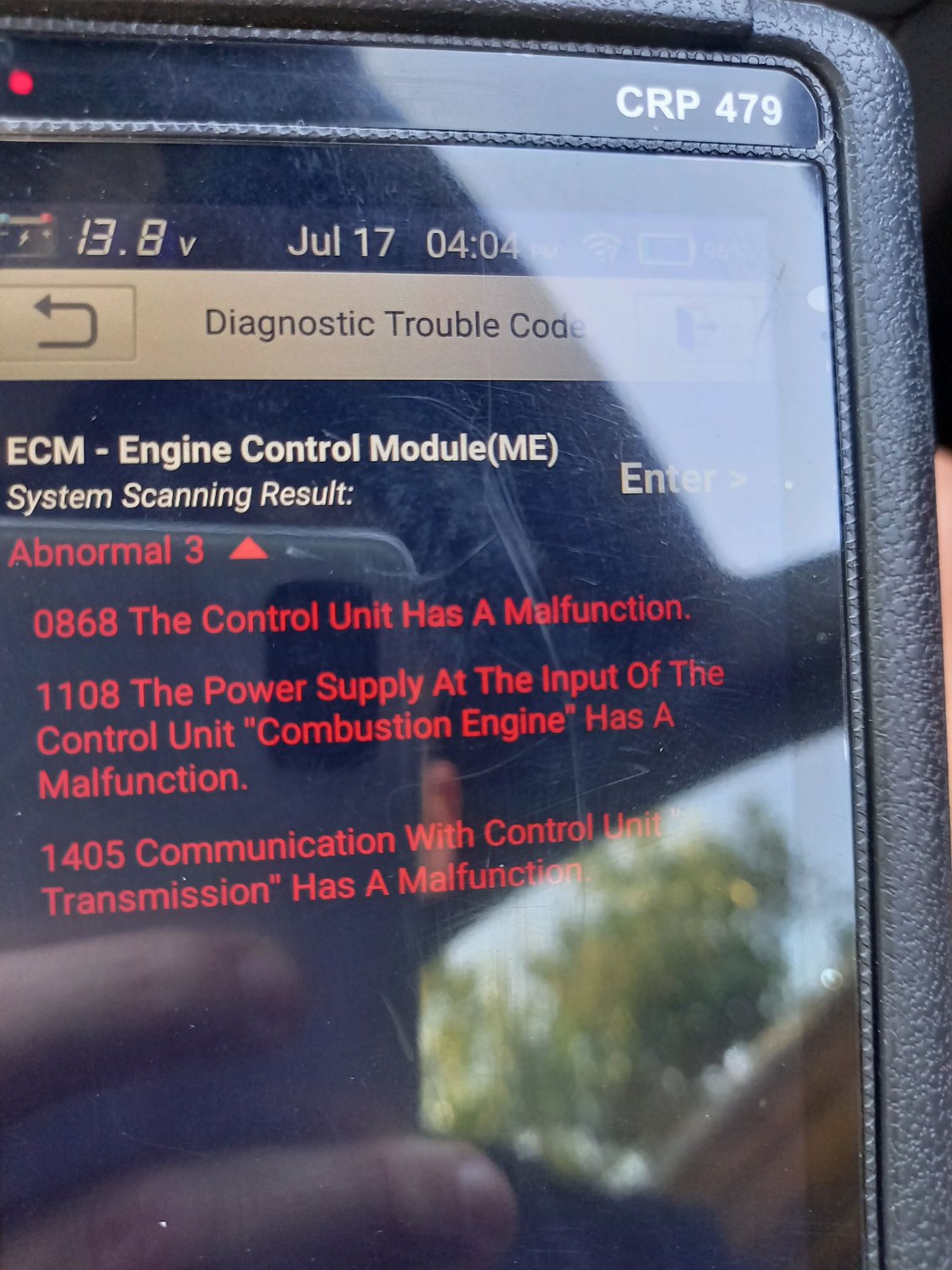

Guys I'm having continuous issues with fueling lately on the C63.
I haven't driven it for a week so I fired it up today and get new fault codes see picture.
these were just stored faults and once erased didn't come back up which are related to transmission low oil pressure .
Driven for approx 20miles, refuel the car on the way back gave it some throttle and the older fault came back 3699 the rail pressure sensor has malfunction.
Intake gaskets replaced
Throttle gaskets replaced
Pcv valve replaced
injectors refurbished
I'm left with fuel pumps or fuel pressure sensor. Any ideas much appreciated as I am far from a xentry machine to run a check
