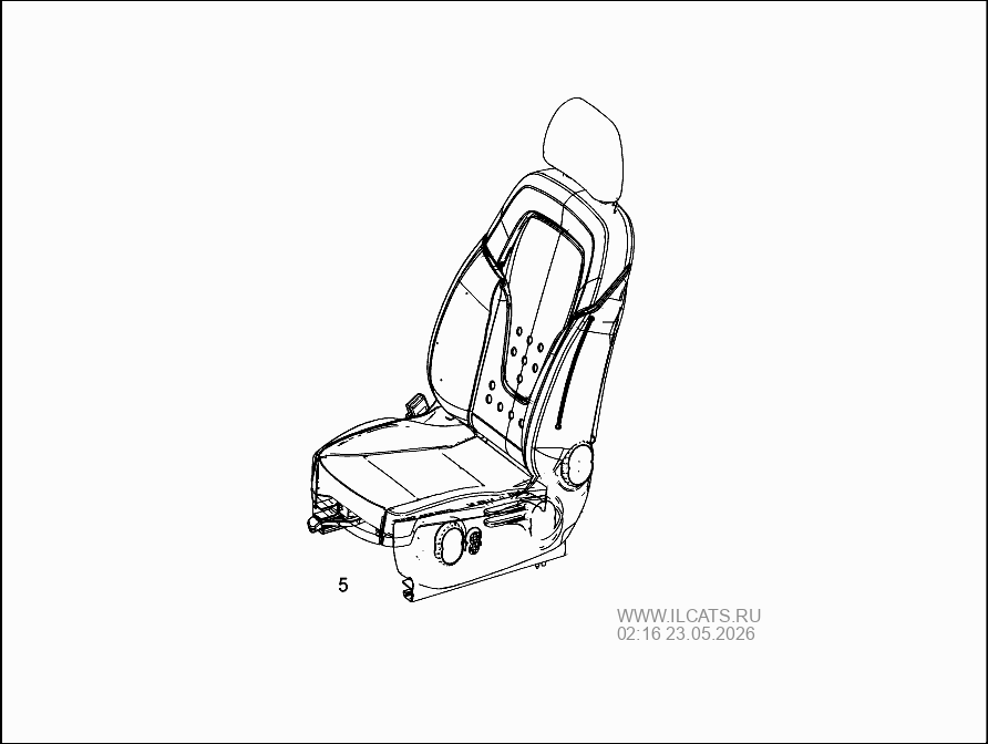

Part number for the cushion underneath the leather covering is A2049101150. A check of a couple of online OEM sellers show cost around $460.00.
Number 20 in the pic below.

That is fantastic!
Will order one today and reuse the leather cover as besides a few minor creases it's in extremely good condition.
