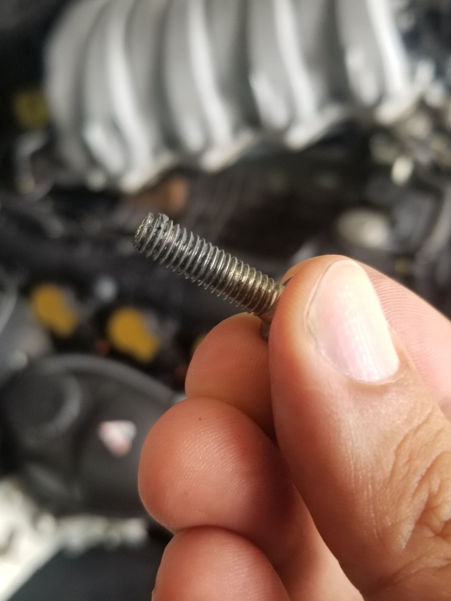

The penetrating oil and patience helped. I didn't realize how long the screw was. Took about 10 minutes of working it slowly to get it out

Nice you can see a little galling of the magnesium in the threads but very little which is great!
