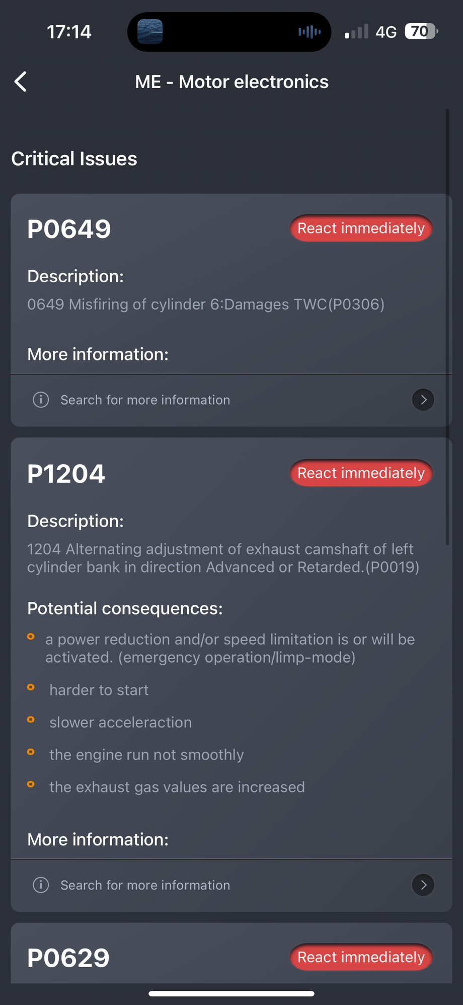

I did change the headbolts, the lifters and the lockplates in the phasers,
i checked the timing twice with the dealer and is perfect, i got these errors
Any thoughts?

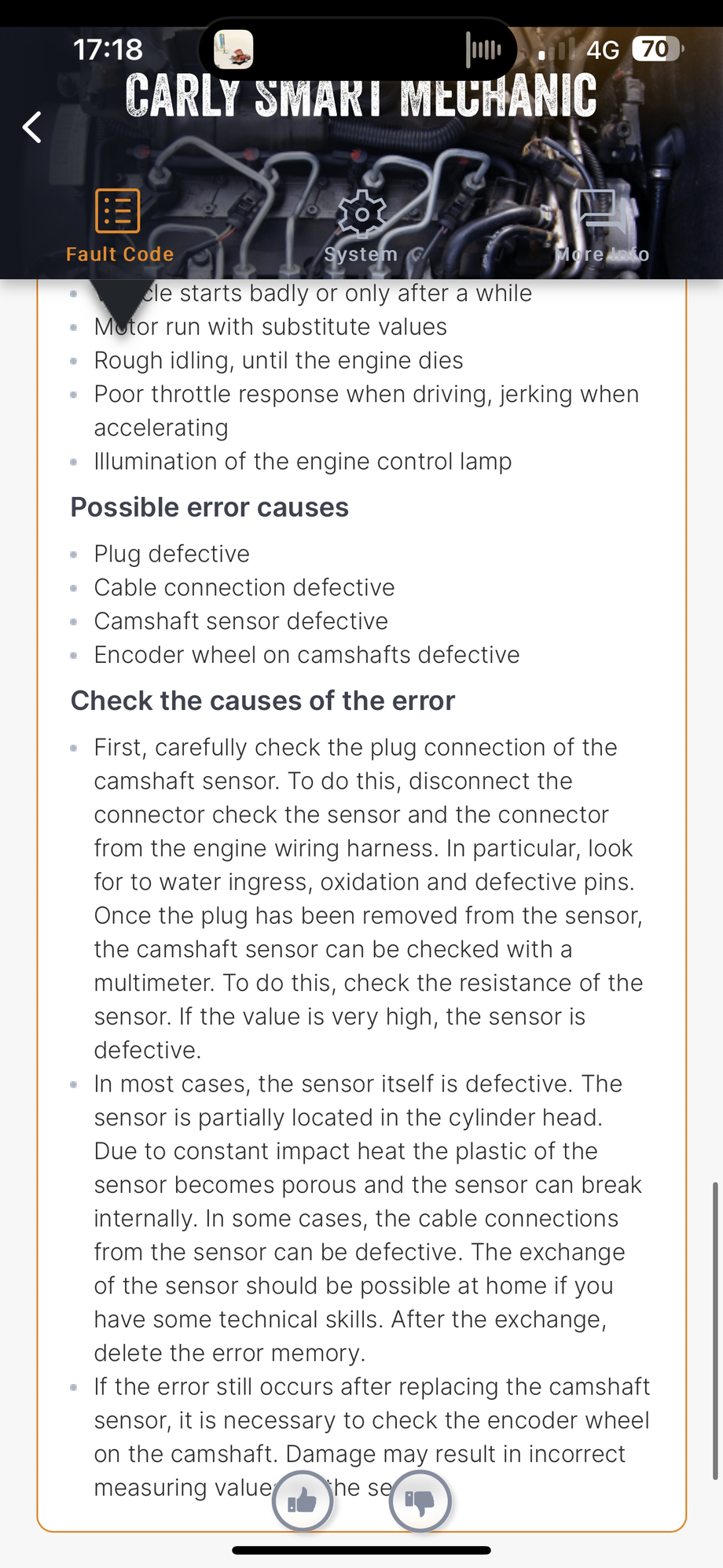

anybody with the same experience? Can it be the connector of the sensor? when i disassembled the timing cover some drops of oil goes on the connector,
