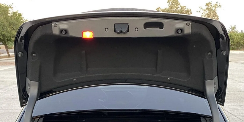

Can you tell what's missing?
Hi guys,
I was hoping someone would be able to tell me what it is that's missing from the boot ( or trunk) lining.
The car is a 2009 AMG C63 W204. It's got me stoked!!
Thanks heaps.

For US spec it should just be felt. But for Euro spec I'm guessing it is emergency/safety equipment.

Thanks, INS1GNIA. Would you believe I spent half the morning trying to find similar pictures that you posted with no luck. Frustrating isnt the word. So its safety equipment. How would I go about getting my hands on these items? Now here comes the trick question. The car was first bought and registered in Melbourne Australia. Does that make it Asia/Pacific spec, or is there no such thing?
I'm not well versed on other regions/specs so I'm sure others might chime in on that part.
You can get the bracket and safety triangles anywhere it seems, ebay, etc.. (double check to make sure these are correct numbers, I just did a quick search).
Triangle bracket - A2048900114
Safety triangle - A2048900197
Example to show how it fits together - https://www.lllparts.co.uk/product/m...0114/id/343411

Dude, you are a champion. Just found a pre owned bracket and triangle in Adelaide, Sth Australia for $50 bucks, delivered.
