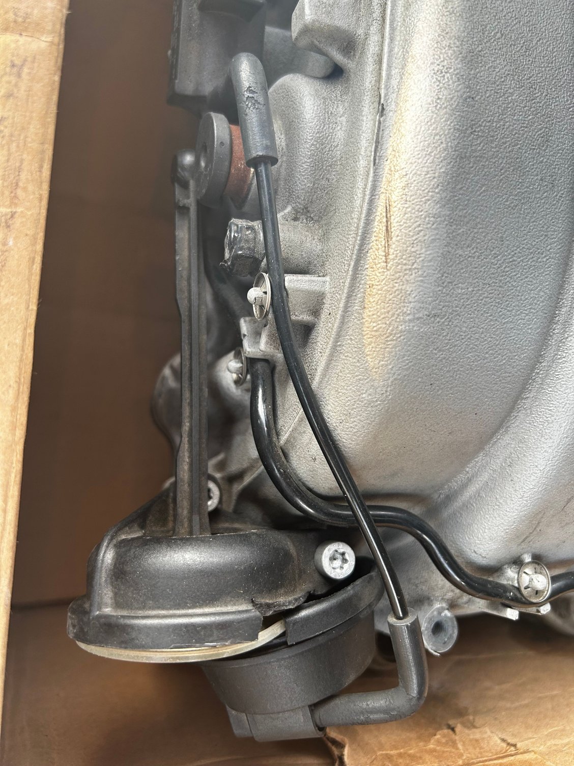

If I buy a new vacuum cell is it just a matter of taking this one off and putting the new one in it? Or is there more to it? Any videos or websites where I can learn how to fix this?

It's two bolts and that vacuum line. Mine was a little snug where the arm enters the manifold but it comes out too

So I could just leave the red as is, and just replace the green, correct?

No, the green and the red come as one unit

Oh alright thanks, a shop I went to said the red can’t come off and I doubted it.
anyways I’ll try going at it right now. Would I be able to just yank it off by hand?

well.. that was easier than I thought.
all done. Thank you

I think there is an o-ring in there you can replace too
