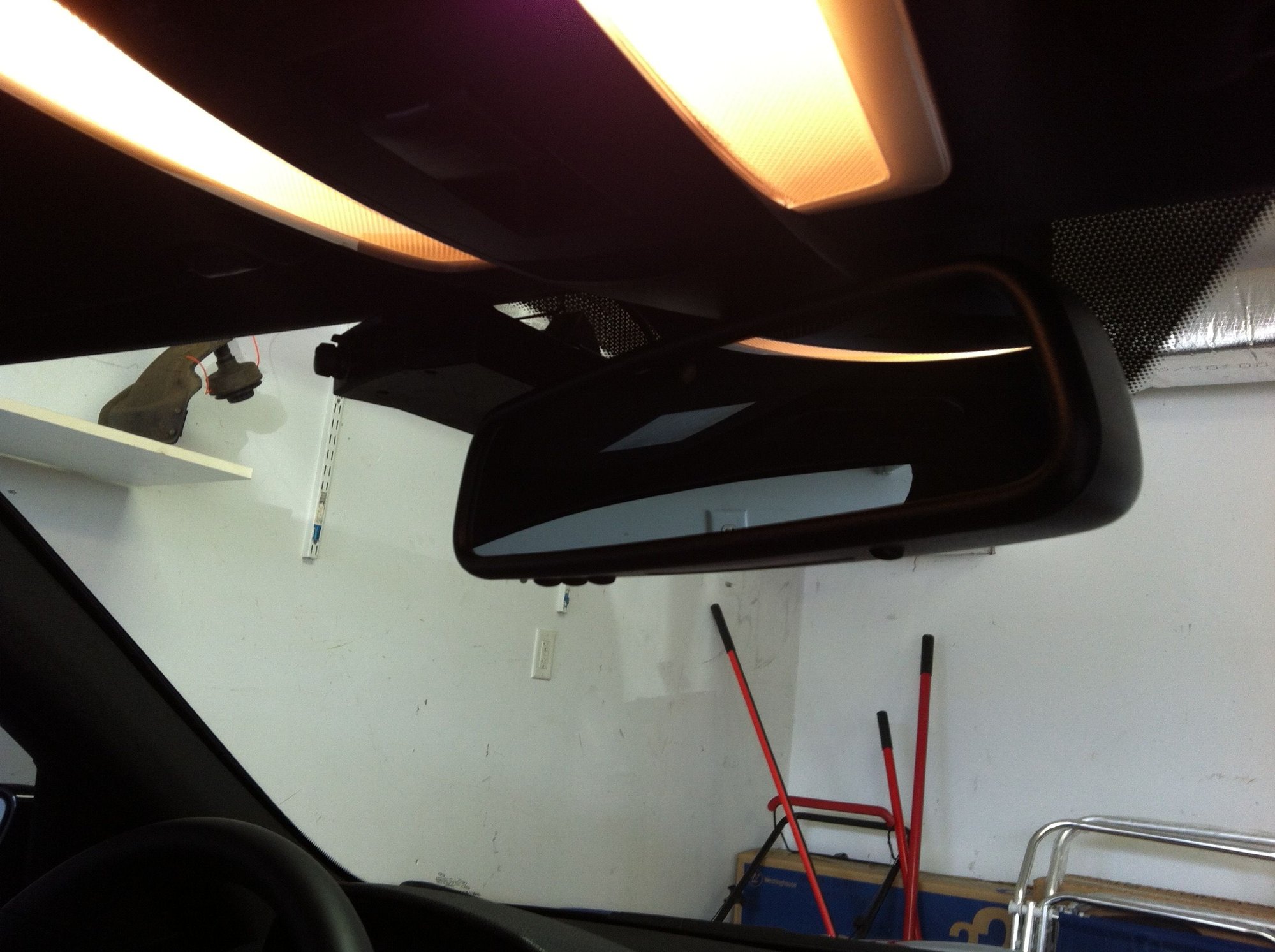

with that mounted high up, does that interfere with the sensor for the rear?

it probably does, but honestly I don't worry too much about the rear. The V1 will still pick up the signal, but it takes longer for the direction finding arrows to transition to the rear vs my other cars where I have it mounted on the rear mirror stalk using a BlendMount. Laser probably also only works from the front too, I can't image the rear laser sensor can see much mounted that high up.

should check the manual if it needs a clear view for the rear. the valentine and waze should help with that though

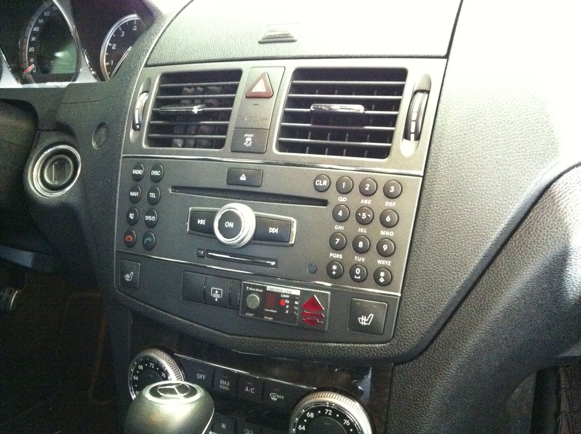

I ran the hardwire kit to the fuse box in the trunk and then cut out the wasted space in the center console to put the concealed display (I lived in VA).

@duuder
you should be good. from your shots above it looks like there is a line of sight.You can check Rdfrum,org for more assistance. I have mine in my rear middle headrest and have no issue
