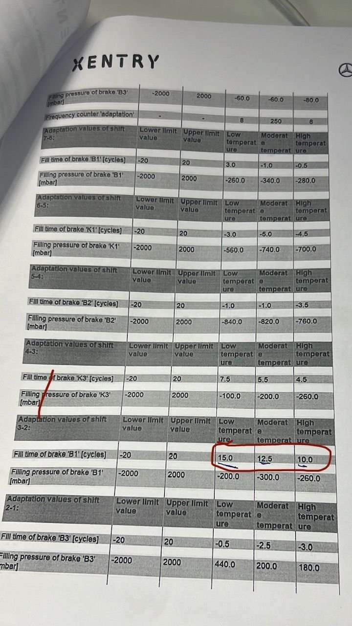

Hi,
My new to me 2014 has been violently banging into some gears fairly frequently since I bought it 2 weeks ago. I have taken to an AMG specialist who advised my gearbox adaptation values were quite bad and advised that it may need a new gearbox but recommended a software update first and gearbox adaptation [gearbox oil already changed recently so not needed].
My question is, has anyone had values similar to mine? I am struggling to find much online and could do with advice on how bad the issue is, how much life is left in the gearbox?
