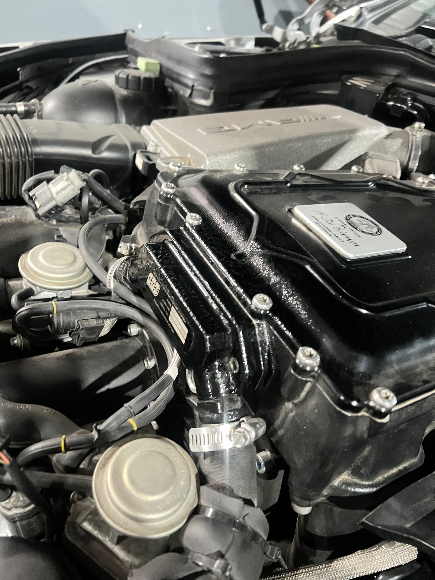

Hi man, I think I put 730gms of r134a... the original is 680gms....pls follow their instructions to charge and let me know aswell....coolant im using oem mercedes pink which is good till -20c

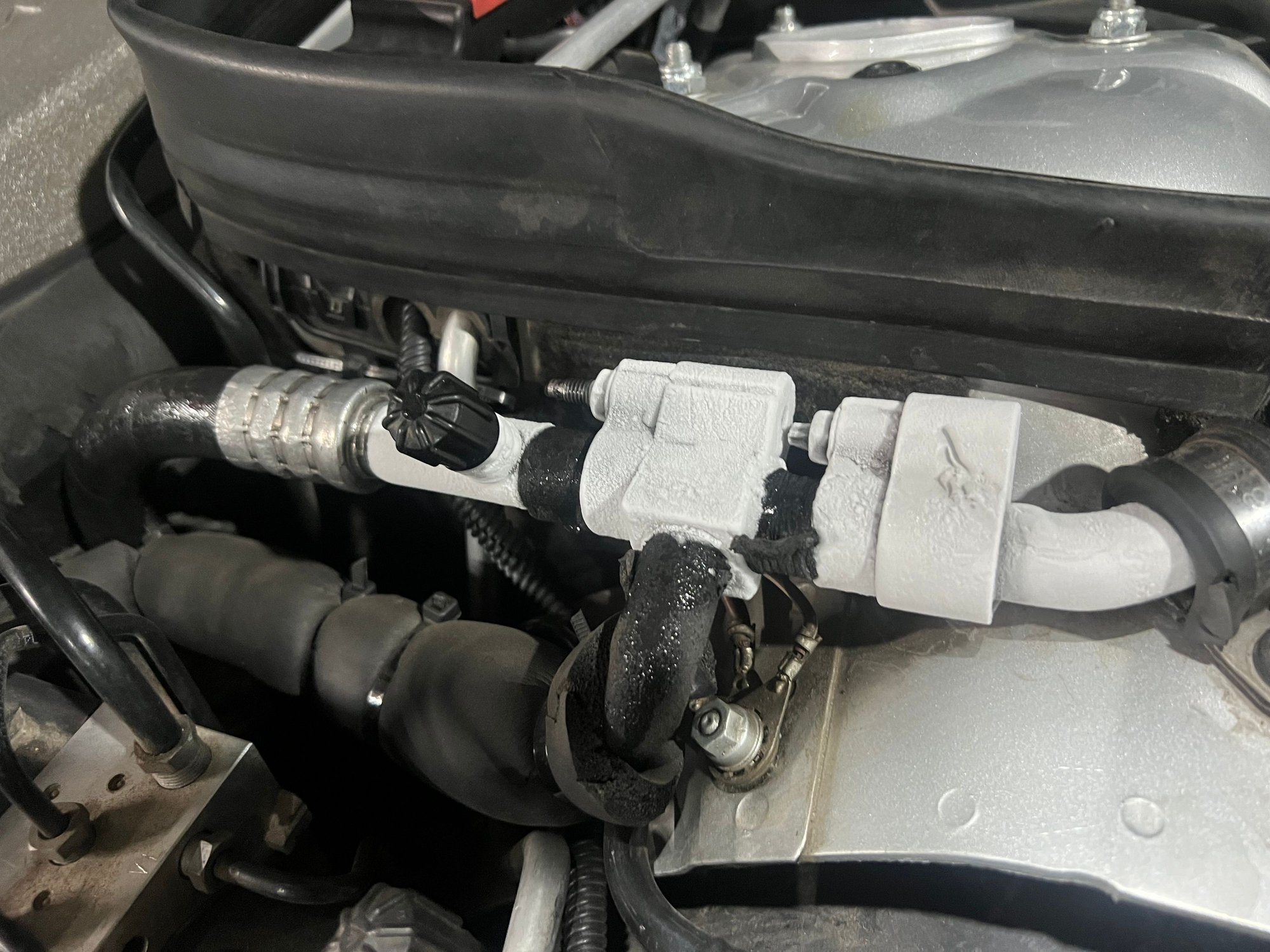

I saw the frost only when it was on dyno with the fans running at full speed but even after long and hard driving the SC LID was cold to the touch,i would suggest you to slowly reduce the refrigerant and check the coolant temps with a digital guage... getting a hood vent also helps a lot by removing heat....
I want to make a custom tank to hold more fluid but there is very little space in our engine bay.
The shop did make custom fittings they didn't want to cut the oem pipes, so they made custom T fittings from the main AC lane
