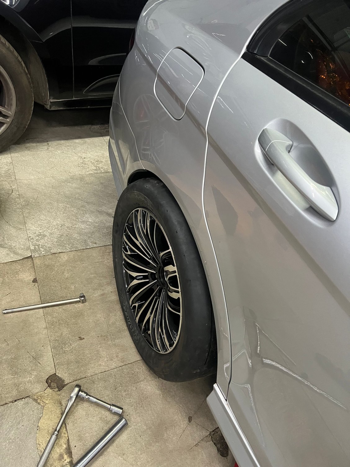

Update on tyres
[img alt="315/35/17
No spacers and no rubbing
Have bilstein coilovers, will raise the height"]https://cimg2.ibsrv.net/gimg/www.mbworld.org-vbulletin/2000x1504/img_8934_0e7831be4683ffe64cdae9f12a43b520a011e9a1. jpeg[/img]
315/35/17 No spacers and no rubbing Have bilstein coilovers, will raise the height
