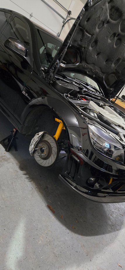

Koni Sport struts & shocks on a C63
Yes, they fit.
Yes, they work.
No, they're not really backordered for weeks.
I searched quite a bit before buying these and found little or no useful information. What information is available is conflicting, including what is shown on Koni's own sites. And like a lot of other things when it comes to MB/AMG/W204, there is relatively little info online about this mod for these cars.
The C63 is not shown in the application list on Koni's product info pages, but their online shop lists them as fitting all W204 C-Class. Koni confirmed that they do in fact fit and work on C63s.
Part numbers:
front strut 8741-1554SPORT
rear shock 8040-1412SPORT
All of the vendors listing these parts showed at least the rear shocks backordered for several weeks. I ordered directly from Koni and they were in my driveway in two days. Their inventory system obviously needs some work.
Ride quality is good once adjusted properly. Adjusting the rear requires removing them from the car, which is obnoxious but can be done in ~30 minutes once you've done it a few times.
Expect these to lower your car ~10mm. Koni says their struts "usually aren't lower," or something to that effect, but that's not accurate. The spring perch on these struts is about 10mm lower than stock.
Pics below.
