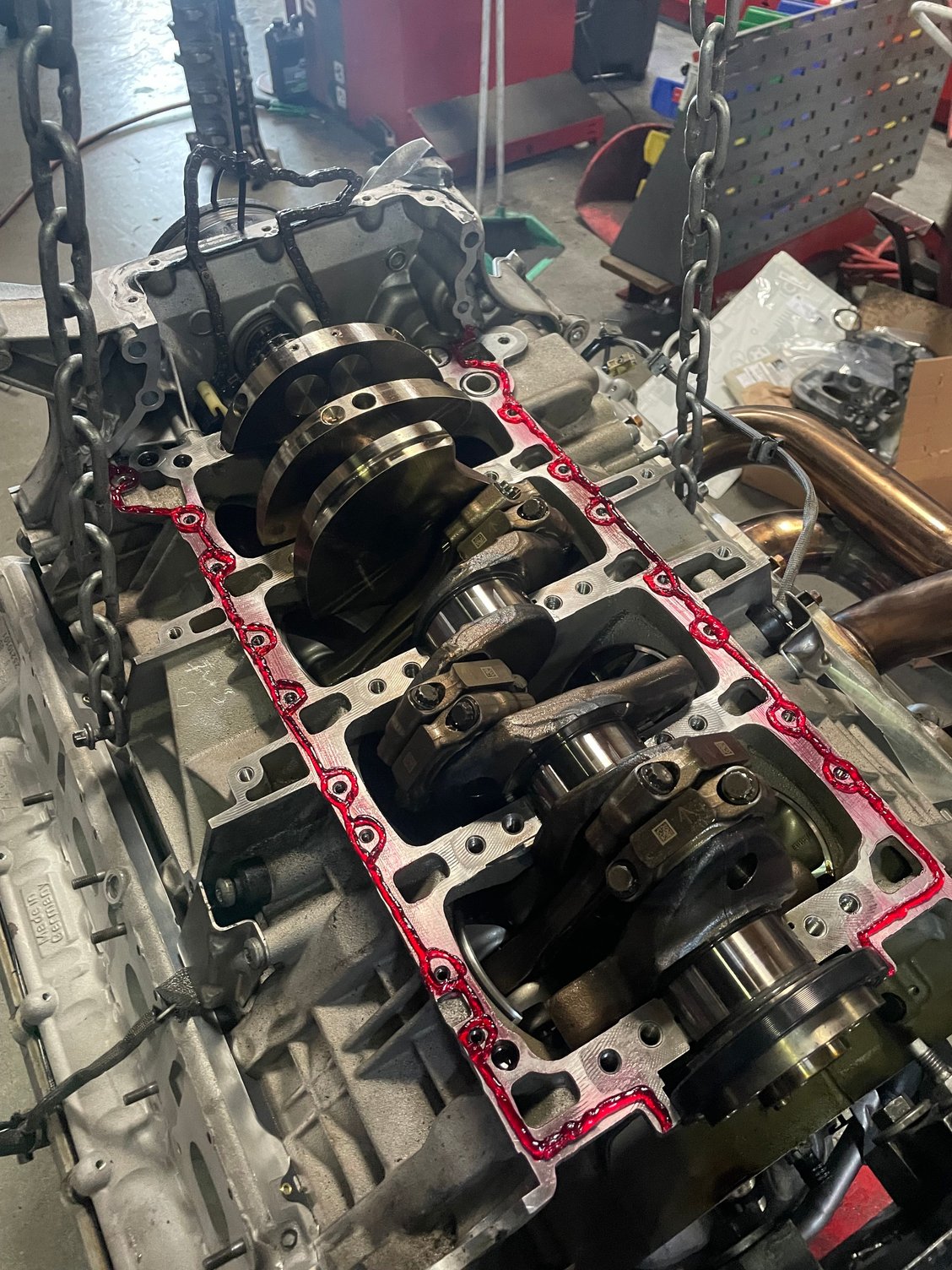

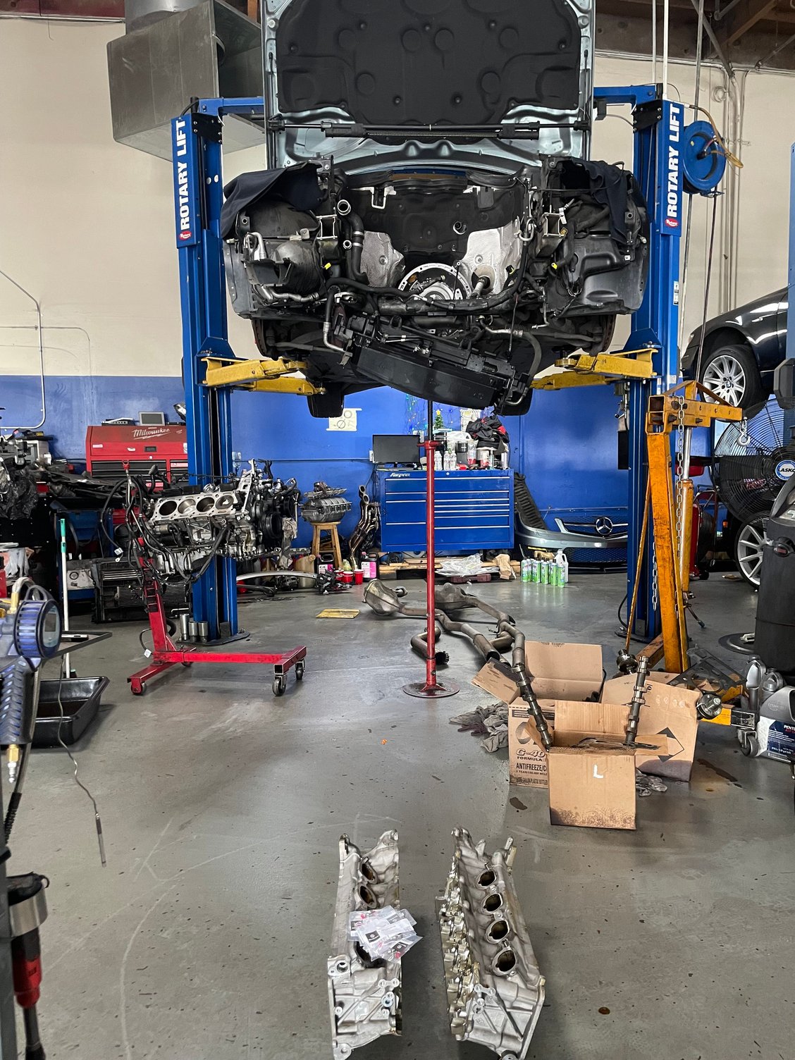

Hello everyone. As the title suggest, my 2012 p31 has been leaking for some time from the bed plate and now I’m finally getting to fixing it along with other major things that should be done at high mileage when the engines out. I’ll be doing bed plate re seal, timing cover re-seal, all oil pan re seals, I have had many w204 c63s with over 200k miles and if you would like more info I can tell you what else happens around this mileage.
cylinder head removal to clean carbon and replace valve stem seals, rear main, wet clutch replacement, intake manifold corrosion repair.

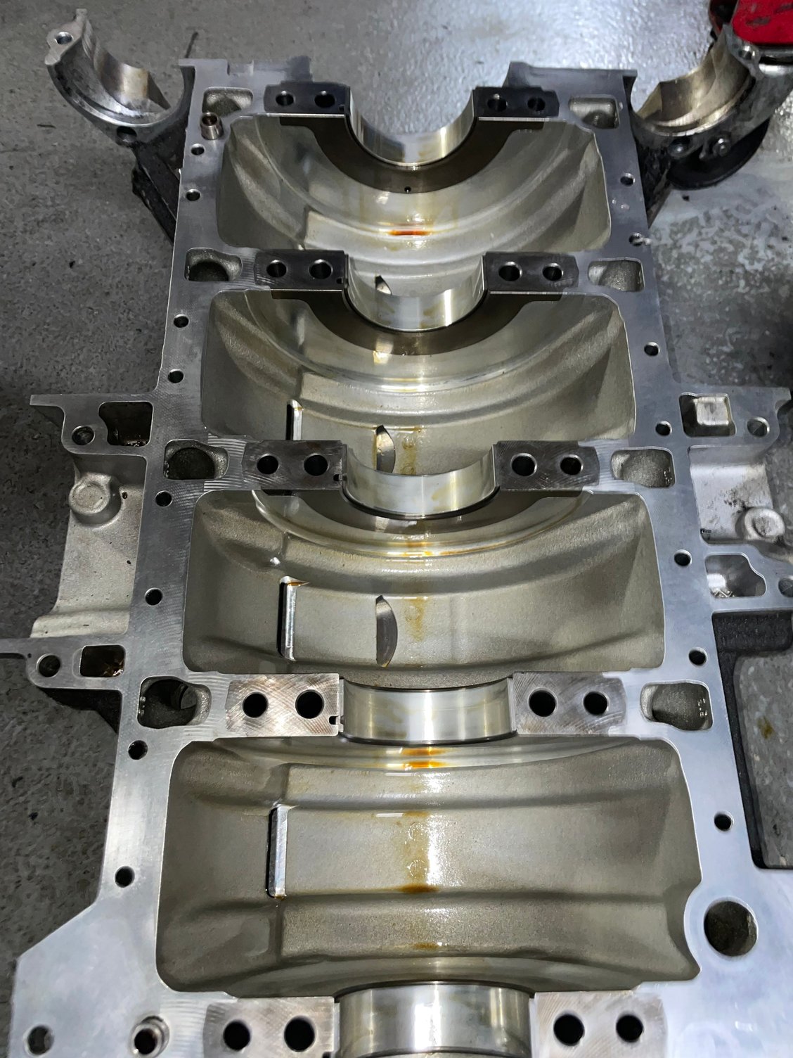

Here’s an update on the job. I’ve done the re seal, here’s a look of the main bearings at 200k miles.
