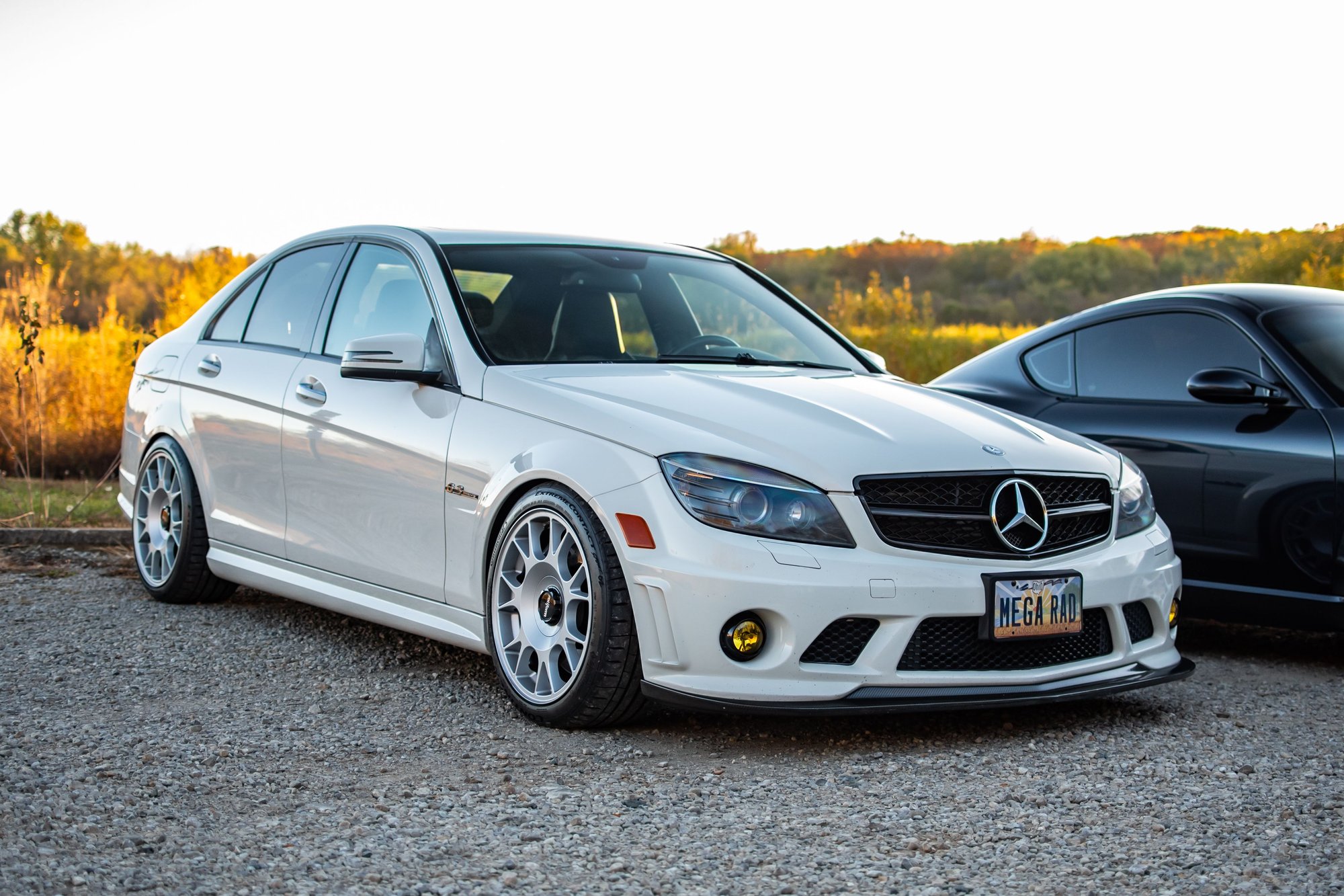

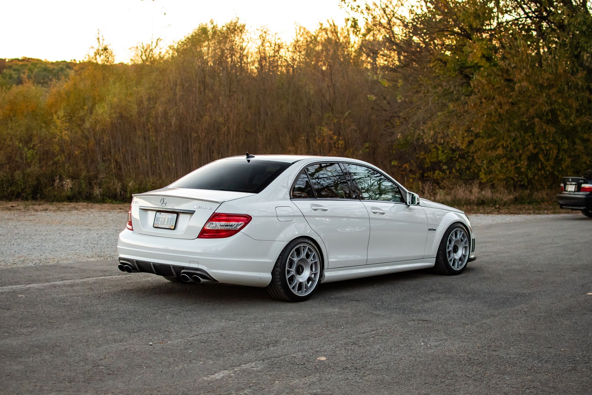

2010 C63 AMG
Originally Posted by 63_kirk
Just wondering if it will work. I'm still new to this pardon.
19x8.5 +44 5x112 Front
19x9.5 +34 5x112 Rear
Im running 8.5 +45 (with 12mm spacer) and 9.5 +38 with OEM tire sizes. +38 works fine with some minor fender rolling. I think you could definitely make +34 work with factory 255 sizing
Old Mar 4, 2025 | 04:38 PM
63_kirk's Avatar
Joined: Feb 2025
Posts: 7
Damn that setup looks really nice man! Will definitely look into it because I really want to run the Titan 7's on the 63. 🤙🏼
