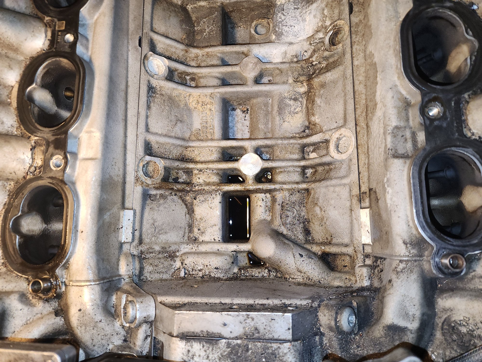

I decided to do a Manifold checkup on my C63. Upon removal, I found oil sitting under the manifold in two locations. 2 years ago, I had a broken valve in Cylinder 1 and had it repaired (head job). I also had my PCV valve replaced as well. I've also replaced both Valve Cover Gaskets and Cam Adjuster Cover gaskets replaced as well due to oil leaks that I was experiencing. When I replaced the Valve Cover Gaskets, I unfortunately struggled with a leak (after my repair) on the driver side at the rear of the valve cover due to a "rolled over seal". The leak was bad and car could not be driven. I discovered the problem and I'm waiting on the replacement valve cover seal now. I decided to check my manifold since my car is out of service at the moment. I found this oil under the manifold. Could it be from the oil leaks that I had on my valve cover or possibly something else. See pics.

I think i found the problem. I have a couple of micro cracks in my valve cover. I will try to jb weld them.
