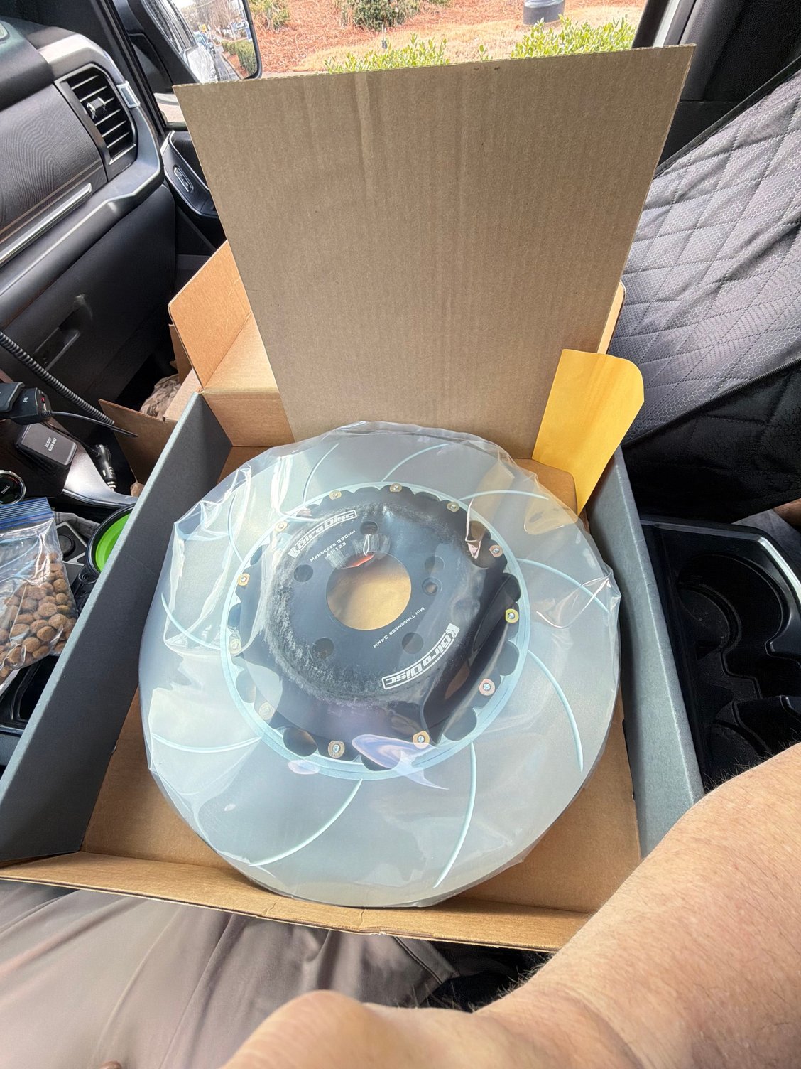

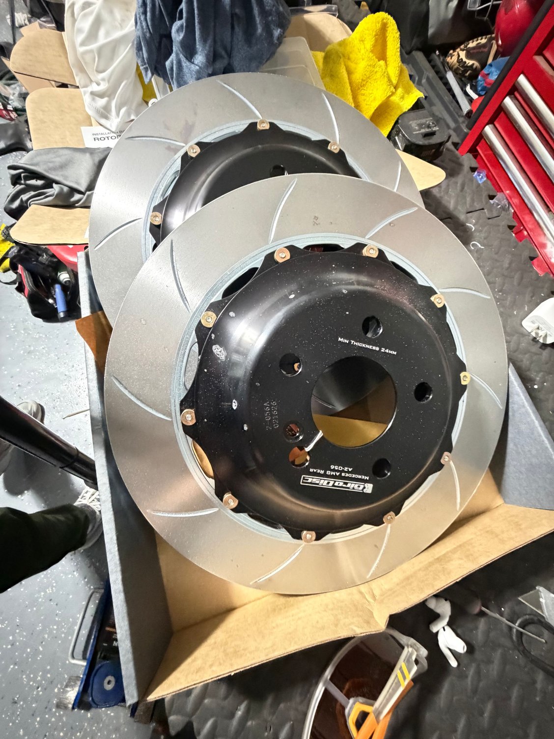

I ordered parts from Parts Geek. Brembo two piece for front and one piece for rear, and brake pads with hardware kit.
fronts were $400 and rear $115 for the rotors.

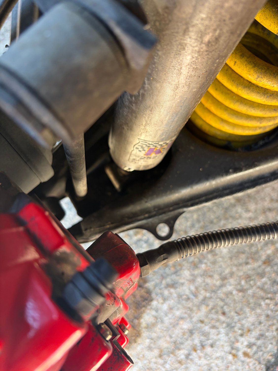

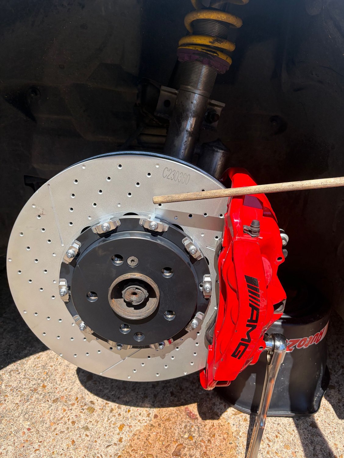

fairly easy and straight forward. T55 for the caliper bolts. My trick, remove bolt, insert wood dowel and repeat for second bolt. Easy to slide out caliper and rest on the dowels.
I didn’t do the rear, the bolts, 18mm, are blocked by the tie rod for the sway bar. I need a flexible ratchet wrench or offset wrench. Question for the group, do you unbolt the tie rod at bottom and use standard wrenches for better access?
Mother’s R3 worker best for cleaning.

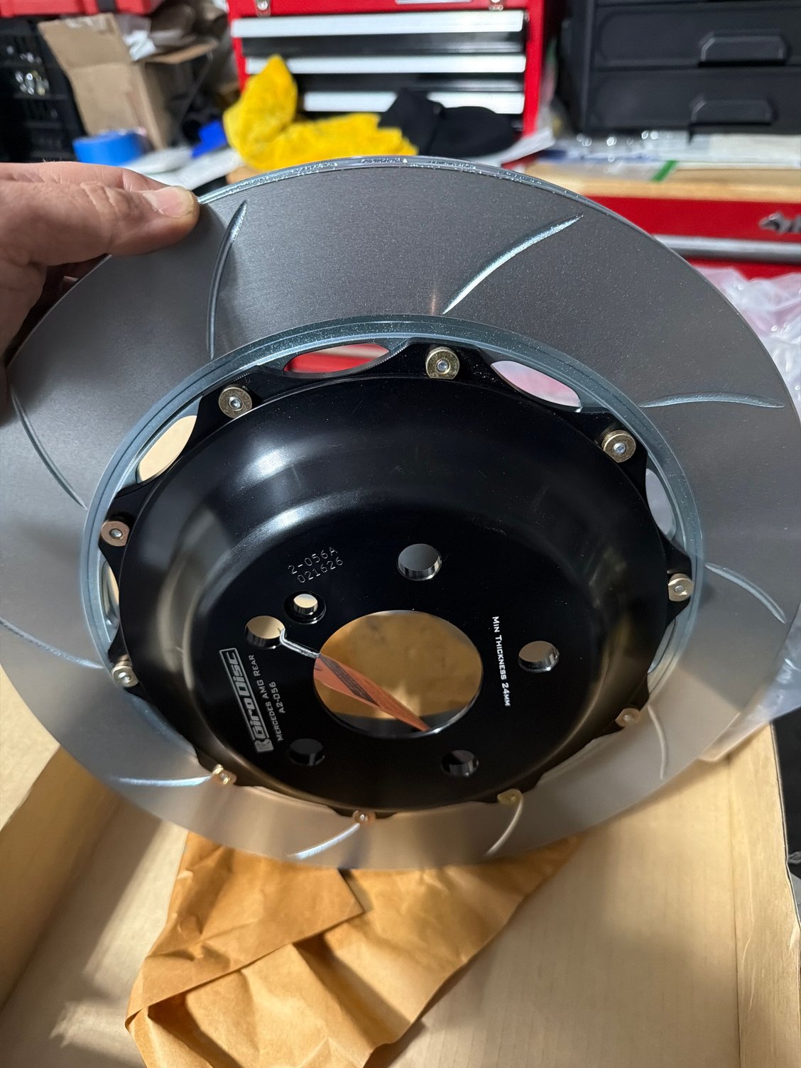

Old May 17, 2026 | 02:21 PM
RmkE63's Avatar
Joined: Nov 2021
Posts: 12
From: Atlanta
2011 E63 M156:AR LTH-82mmTB-wavetrac-EuroCharged
Best set up

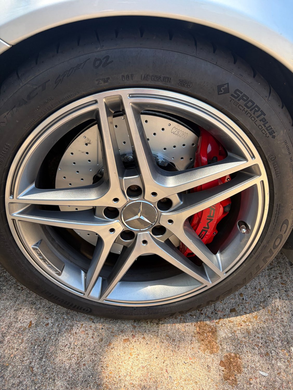

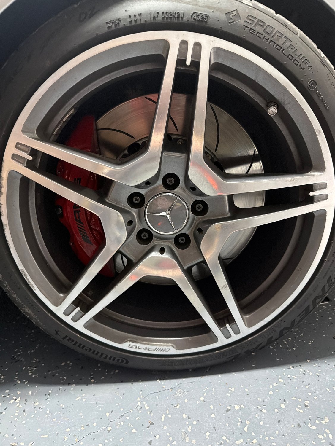

On my E63 m156 I did the following
​​​​​​-upgraded my rotors to the 390mm (with bracket)
-2 piece floating girodisc rotos front and back
-DS2500 pads on the front
-Mercedes OEM pads rear
-stainless steel lines
-castrol SFR brake fluid
my car now stops INSANELY. initial bite is perfect. Zero fade. Perfect modulation at any speeds. I would rate this at double the stock stopping power. Slight squeak sometimes but worth every bit of it. For brake dust control I just ceramic coated my wheels so literally now all I have to do is hose the wheel off and we golden.
the rotors have free’d up the car where I have more responsiveness and I can feel the difference noticeably. With my wavetrac installed as well- putting power down to both wheels perfectly- I can literally pop sideways anytime I want with complete control and have the stopping power necessary.
highly recommend
Massive 390mm
Massive 390mm

What is your rim diameter ?
Old May 17, 2026 | 10:34 PM
roadtalontsi's Avatar
Joined: Oct 2007
Posts: 2,311
Likes: 382
From: Texas
10 C six trizzle
19". You're not fitting 390mm on any 18" wheel. Some aftermarket 19" may not fit them either just like the carbon rotors.
Old May 19, 2026 | 06:38 PM
RmkE63's Avatar
Joined: Nov 2021
Posts: 12
From: Atlanta
Wheels are 19’s
they fit perfectly
