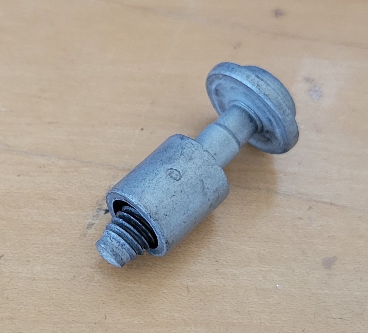

Hey all,
I was working under the front of the car and as I'm putting the plastic shields back on I find this T30 bolt on the ground.
It's about 25mm long with a captive spacer. I looked around but could not find where it's coming from.
Any help finding its location would be much appreciated!
Thanks.

This looks to be a valve cover bolt...
https://www.fcpeuro.com/products/mer...des-0109906704
However, I don't see any missing (counting 13 per head). I had the cam adjusters done recently, so my best guess is the tech dropped one of the bolt during cover removal.
These bolts are not used anywhere else on the engine?

Yep plastic valve cover bolt. Probably dropped one when they did your covers and where to lazy to find it.
