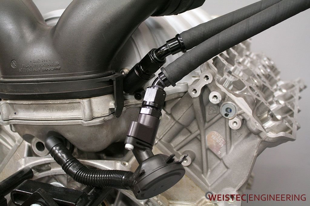

When detaching the airboxes from the rubber hoses on the T piece (that goes into the intake manifold) - the one with the metal strap to hold the airbox, on both sides there was some lubricant inside. Is this normal silicon grease?
Also, the T piece itself, when detached from the manifold (see pic below), the border of the plastic/rubber part on the bottom has some residu on it (as well as the metal where it slides over) that seems more or less dried out. Is this also some kind of lubricant or seal?
Asking because I removed these parts and though I could re-apply whatever was on it before reinstalling it !
