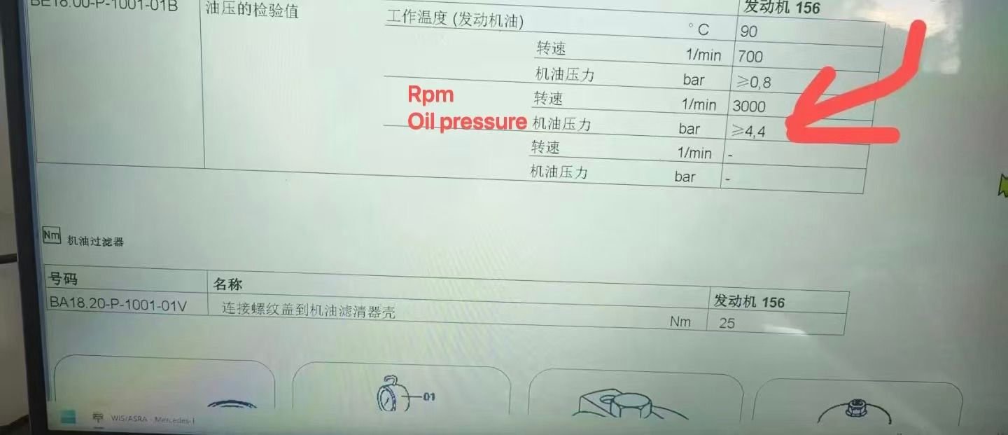

hi,I'm very sorry to continue this well-known event in 2025. But there are new perspectives on this incident at present.

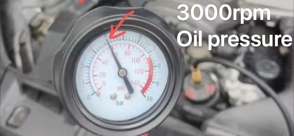

I browsed through the original factory maintenance manual and discovered an interesting thing that is rarely mentioned: oil pressure. And tests were conducted on five m156 units, and the results were astonishing. The original factory maintenance manual requires that the oil pressure should reach above 4.4bar at 3000RPM. However, on the five m156 units using 0w40, the oil pressure would never exceed 4.0bar, which is far below expectations!
And I used a micrometer to measure the bearing bush clearance, which was between 0.009mm and 0.01mm! The clearance of the bearing bush is extremely large,This is a pure racing car design, so if the engine oil is thin, the oil pressure will disappear at the crankshaft bearing. This is also why the m156 will wear out the camshaft and the hydraulic top barrel, and even destroy the bearing bush.
So I think m156 should use engine oil with a higher viscosity. Of course, all of this is just my guess. I hope it can draw attention and have some capable people participate in the discussion.

very good idea, bro.Although the viscosity of some 5w40 engines is higher than that of 0w40, there won't be a significant difference. This is bad news. I think 5w50 or even 10w60 engine oil can be used
