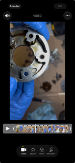

I think it's the locking pin in the phaser that is slipping.
I opened the defaulting phaser and this is the condition of the backplate hole:
Honestly it doesn't look that bad compared to what I've seen on multiple YT videos. I think the phaser is slipping more than it will in reality because the phaser is empty of oil, so zero internal resistance.
I did flipped the locking pin, stretched the spring, fill them with oil and closed back both intake phasers. Planning to reinstall them next weekend.

Hey! Honestly, I only flipped the pin and stretched the spring. It was still skipping a bit when cranking by hand but never had timing or rattling issue with the phaser since. I think once the phasers are filled with oil it helps preventing the skipping.
