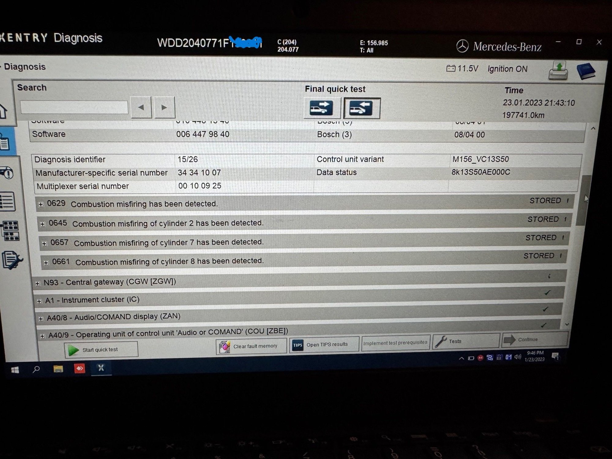

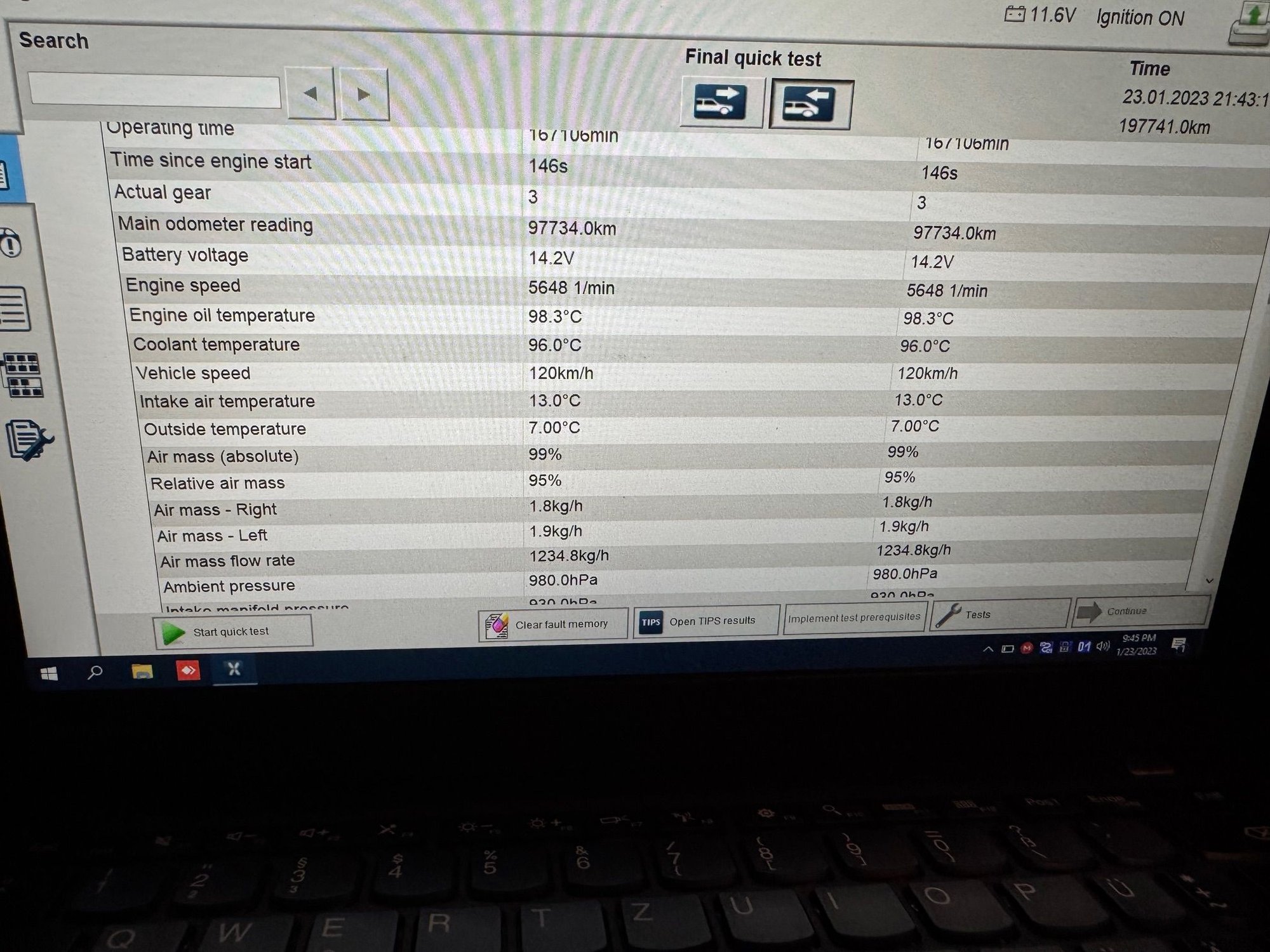

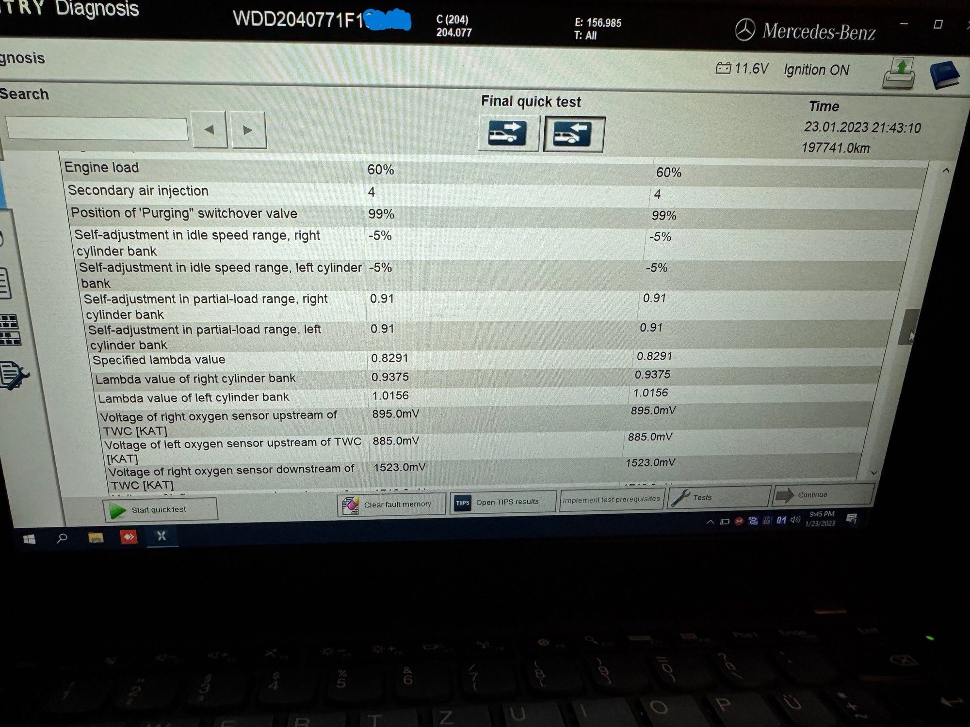

im running into Misfire on mostly the rightbank, however everytime i read codes, its another coil,
also having sounds coming from the engine which isnt consistant.
ive checked O2 sensors (on the right bank they were darker coloured with carbon?!)

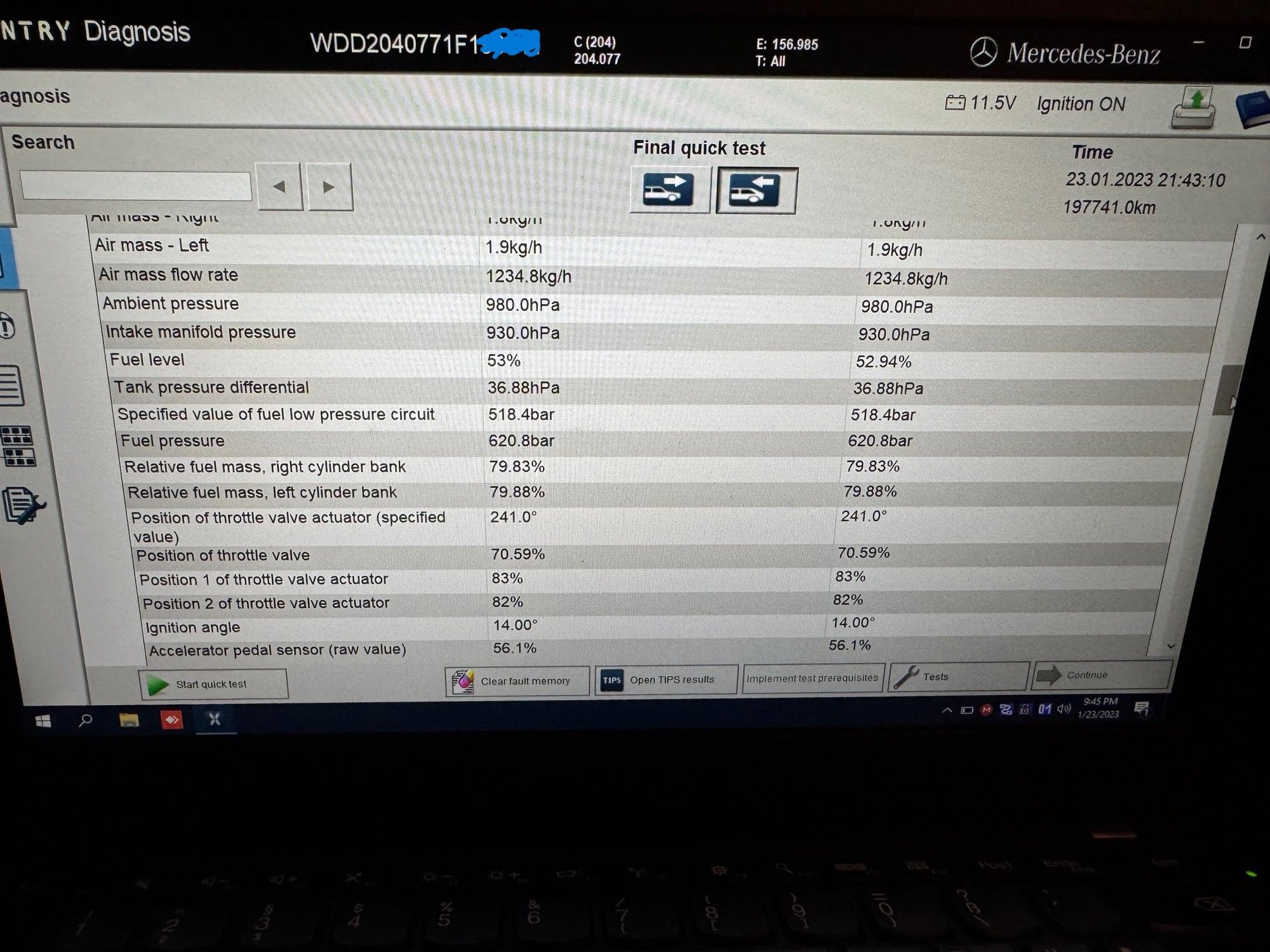

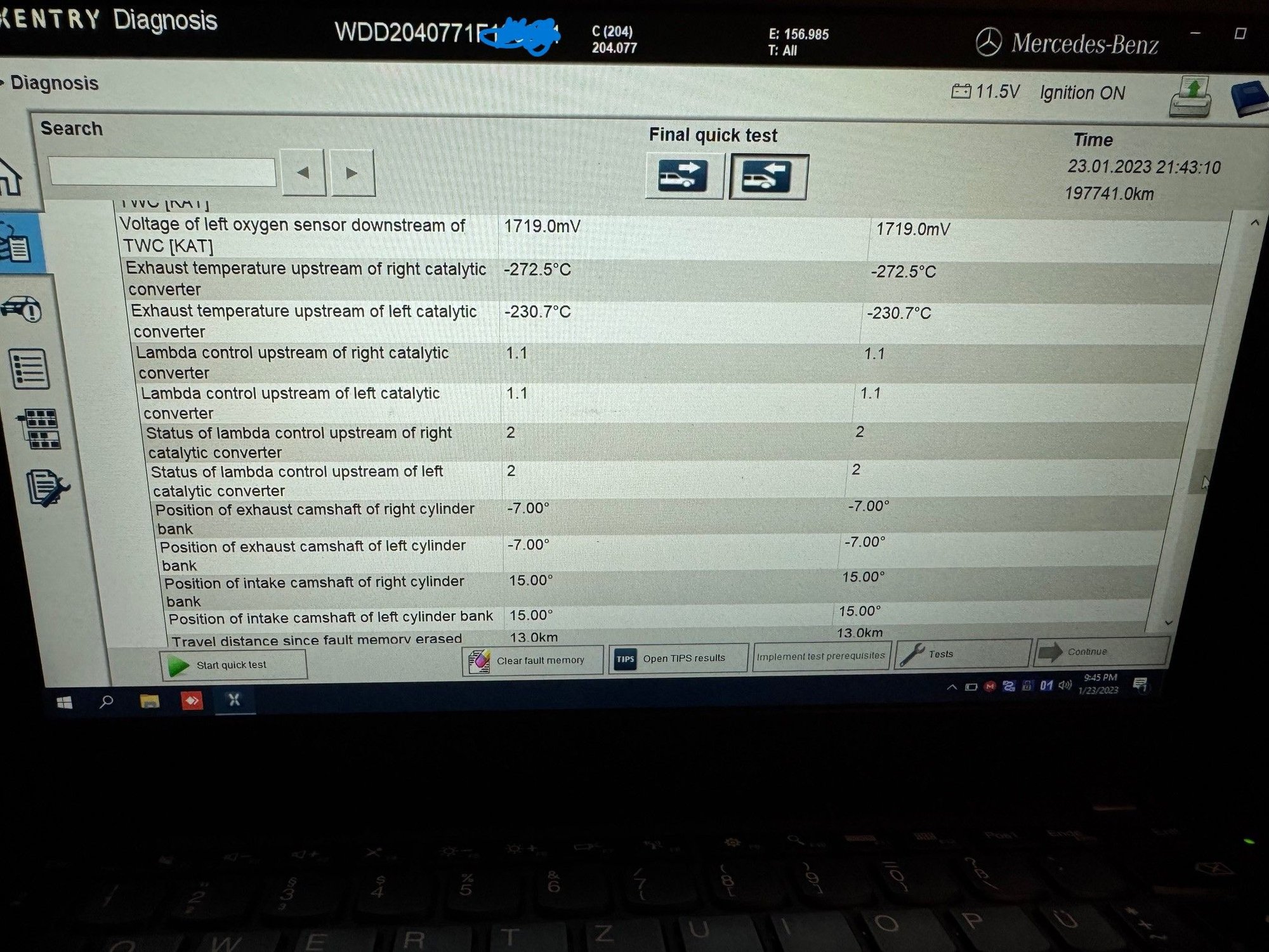

read live data/fault codes with Xentry diagnostic which most showed most values within specs.

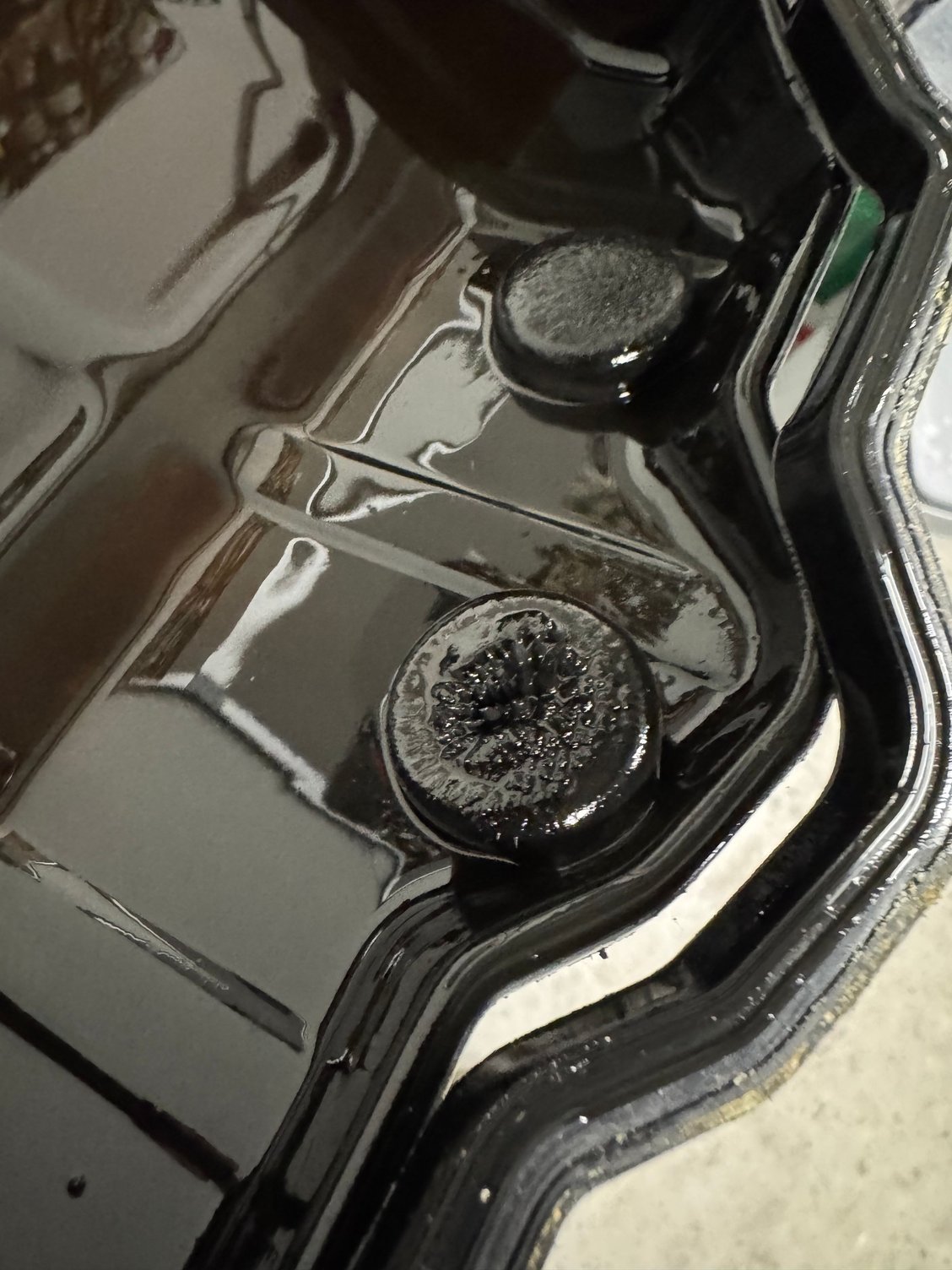

i ordered new sparkplugs (just in case) and new Bosch Injectors, and started to replace these. when i unscrewed the first fuelrail screw i had the biggest luck that the mounting points just broke of the intake manifold, my intake manifold got the beautiful virus of magnesium corrossion, from this point i start to take the intake manifold off the engine and open it up finding also a cracked throttlebody plate, also measured piston height on all cylinders to make sure no conrod got bend, also with a camera no damaged was found, only to noticed everything looked clean with maybe just a but of carbon on the piston heads, all pretty decent for a 195.000KM engine
got myself a used good shape intake manifold, an RMT alloy TB plate, and starting to build everything back together, i left the foam cushions below the Intake manifold away as they already dissolved a bit but also look like they hold moist on the place the intake manifold got corrossion damage, (since i had the car on the lift i also replaced the engine mounts and obviously since fuel was in the engine i changed the oil and oil filter)

i later on noticed the car started to Misfire on High RPMs, so when you hit the power and came arround 6000RPM, it then just kills the power, and the CEL/MIL/Engine light starts blinking, i then instantly come of the throttle and find a safe space to stop the car, you feel the engine shaking from misfire and having a few cylinders deactivated, ignition off and on again and the car runs fine on 8cyl again. (when reading fault codes it just shows various cylinders, one time its 3 5 7, the other time is 2 7 8 and the next time its 4 2 7, i do however had cyl 3 on it a few times, decided to replace that coil just as a check and i havent got a code on cyl 3 anymore, after googling a few days i found someone writing something about bad O2 sensors an maybe a failing Catalyst, which gave me the though, could my exhaust fail me,( when i bought my car it was straightpiped, but to have it pass through emission checks every year it needed to have a Catalyst converter in it, so i let an exhaust company put 200Cel Cats in the oem empty Cat housings)

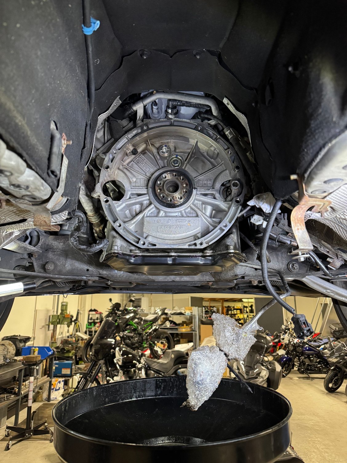

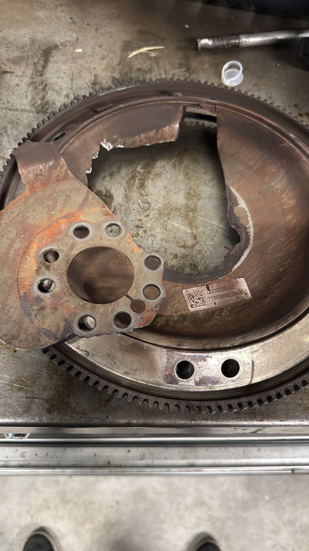

So i started working on my car last Friday, i run the car and pulled coilpack connectors one by one to listen if the engine knock became noticable
while doing this i concluded that i dont think any issue comes from here, also the sound isnt that consistent, and being with my head over the valve
covers, sound is absolutely not coming from there.
i decided to take the risk and starting to take the gearbox out of the car, i already ordered a used torque converter since i think the sound comes from here, also noticed some shuddering

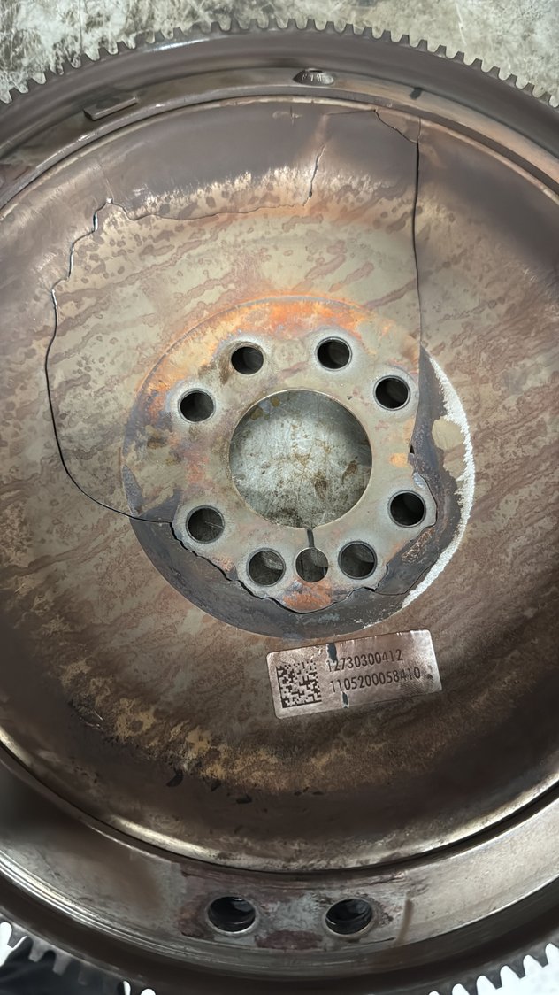

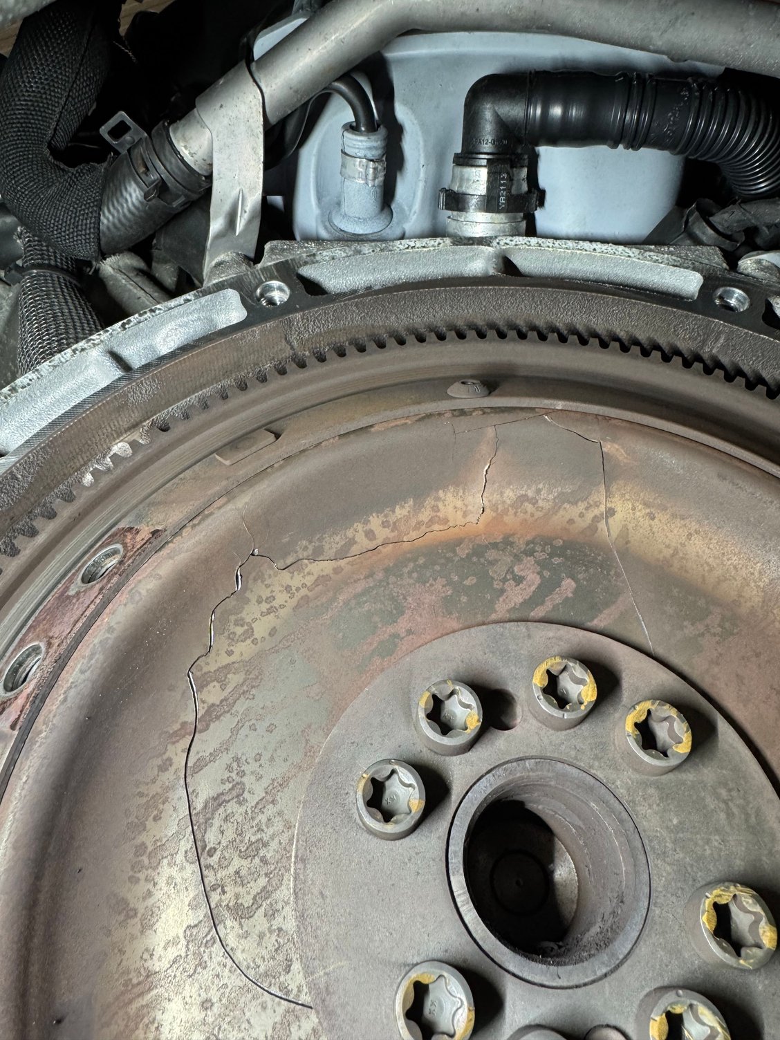

so exhaust off, propellershaft out, gearbox oil out, and gearbox off, i instantly noticed a major damaged flywheel or flexplate.
i think i found the problem for all my issues since the Crankshaft Position Sensor is also here, i wouldnt be suprised my misfire errors also comes from this.
