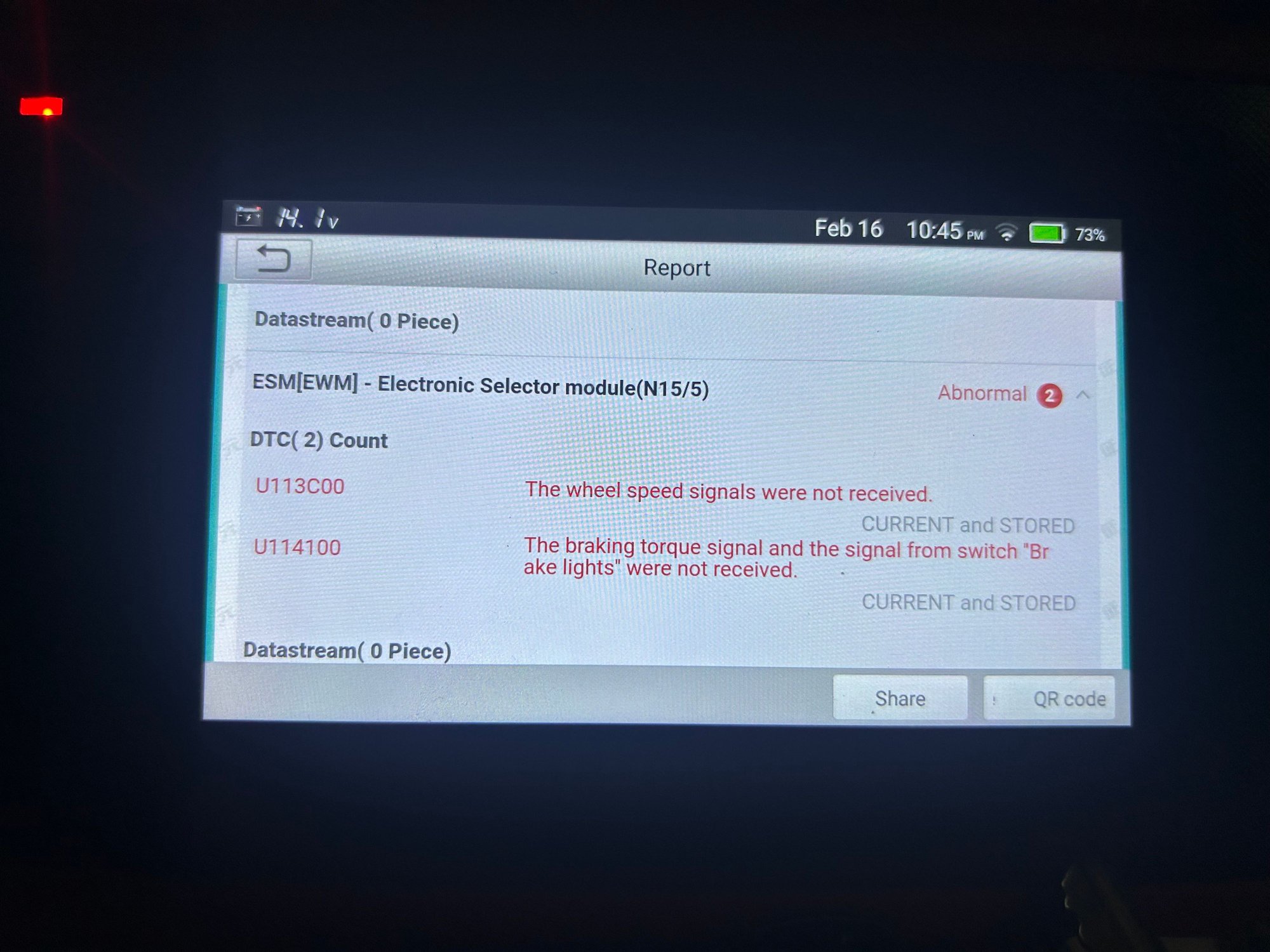

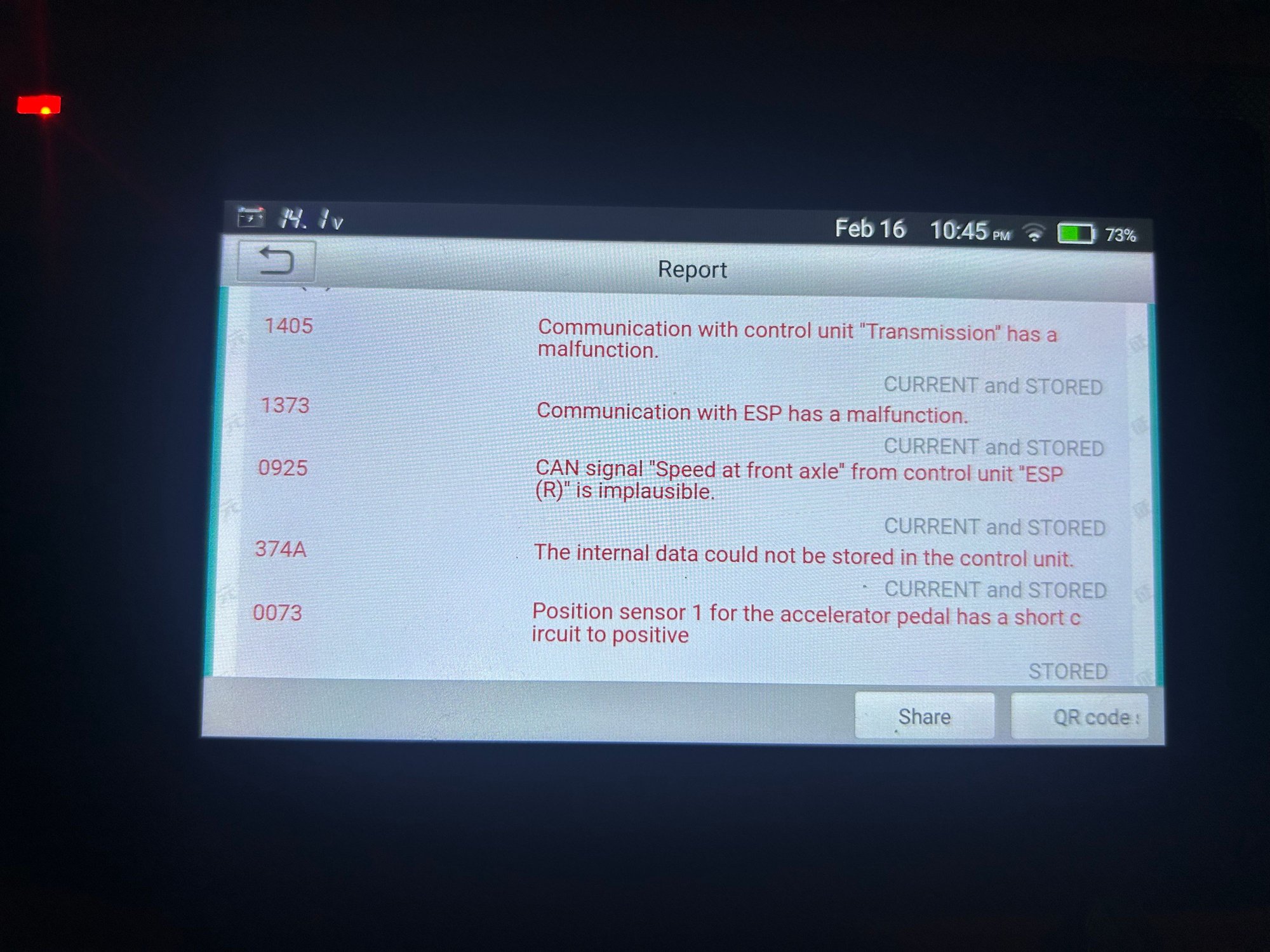

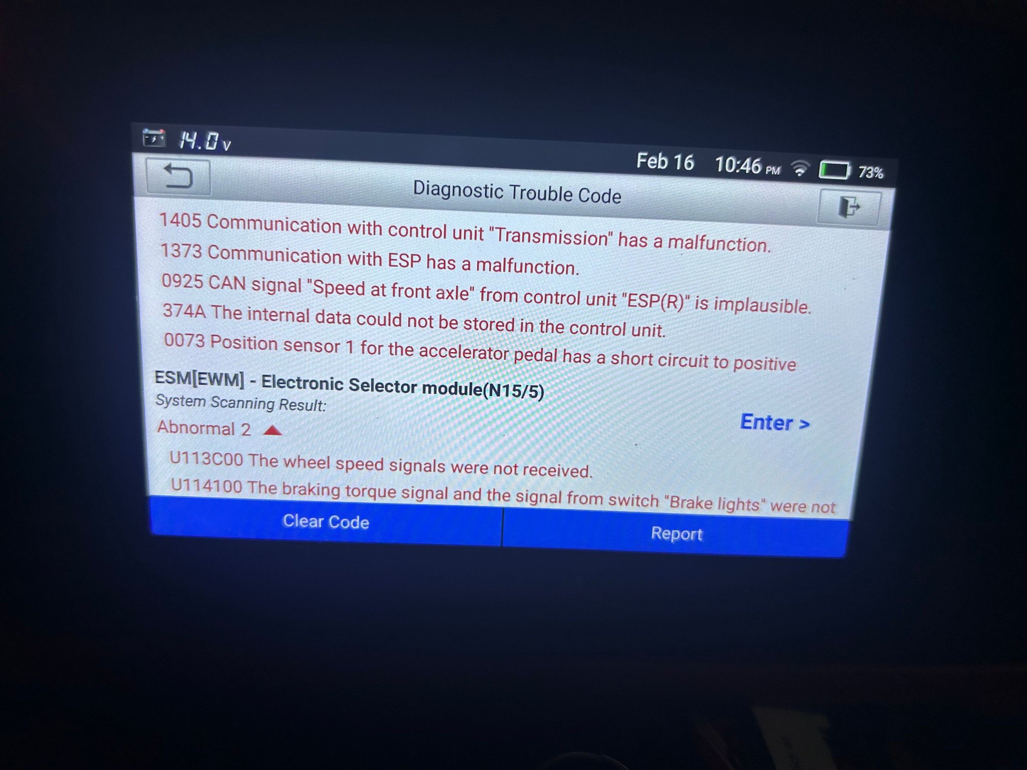

Hello all I have a 2008 c63 amg, she has around 118k miles on her I believe, The past few years I’ve been having issues with her in 2024 I had the emis issue took almost a year but got it back, Did a emis emulator on her, Then a few months after that had some strange electrical issues going on, Headlights staying on and flickering, Moonroof shutters when closing, Eventually it killed that battery got a new one then the same issues came back had the battery tested and found out I had a bad alternator, That night the 2nd battery died so I got a new alternator and battery, The installer installs my battery incorrectly and the battery wasn’t secure in the trunk, 🤬 got the battery secured I was driving on the highway, I get the abs/esp cruise control inoperative error message and the steering gets harder to turn which has happened off and on in the past, but all of a sudden while on the freeway I feel like a pop and it feels off,So I get off the freeway power cycle it while I’m diving it, It’s acts as if it’s stuck in one gear like it’s not shifting, I get home to scan it, I put it in reverse it goes into reverse gives a clunk so I put it back into park, I turned the car off come back about a hour later starts fine but this time when I put it into gear it doesn’t do anything, it lets me shift it but on the dash it’s not going into the gears, Also comfort and sport mode have vanished from the gear options too, Please help thanks guys.
