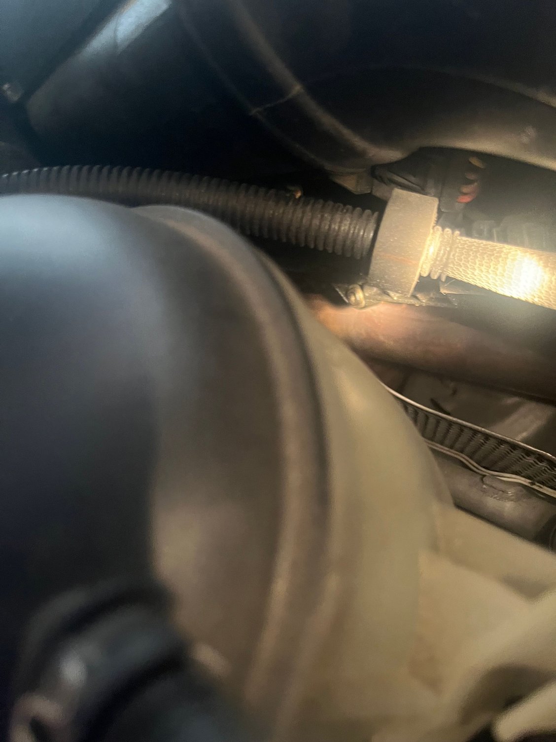

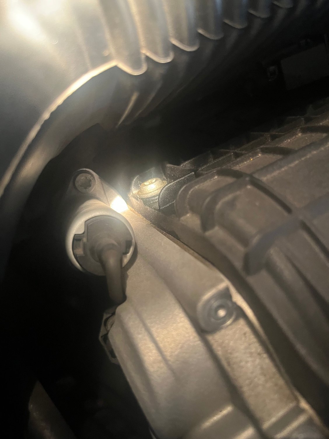

Discovered a leak coming from the edge of the passenger valve cover after seeing slight smoke when the car sat for a week. It seems like the oil is running from the area pictured down the bottom of the valve cover with visible oil on the screws. I asked ChatGPT what the possible causes are thinking it would just be the valve cover gasket but ChatGPT said that it’s possibly my cam magnet adjusters pushing oil out or the PCV.
I wanted to know if anyone had experience with a similar leak and if it simply is the valve cover gasket, which I know is a tedious job from videos watched. But I’ve never heard of cam adjuster magnets to be honest, and I have been struggling to find information on replacing them. Even finding the replacement part took some time until seeing it on FCP Euro.
Passenger side valve cover bottom screw with oil residue
Passenger side valve cover bottom-middle screw with oil residue

On a M156? The valve cover gaskets are one of the simplest jobs on this platform.
Smoke from oil slowly dripping onto the exhaust manifolds is one of the most common symptoms of a leaking VCG.
It could also be from the PCV, which is a maintenance item that ideally should be replaced preventatively.
