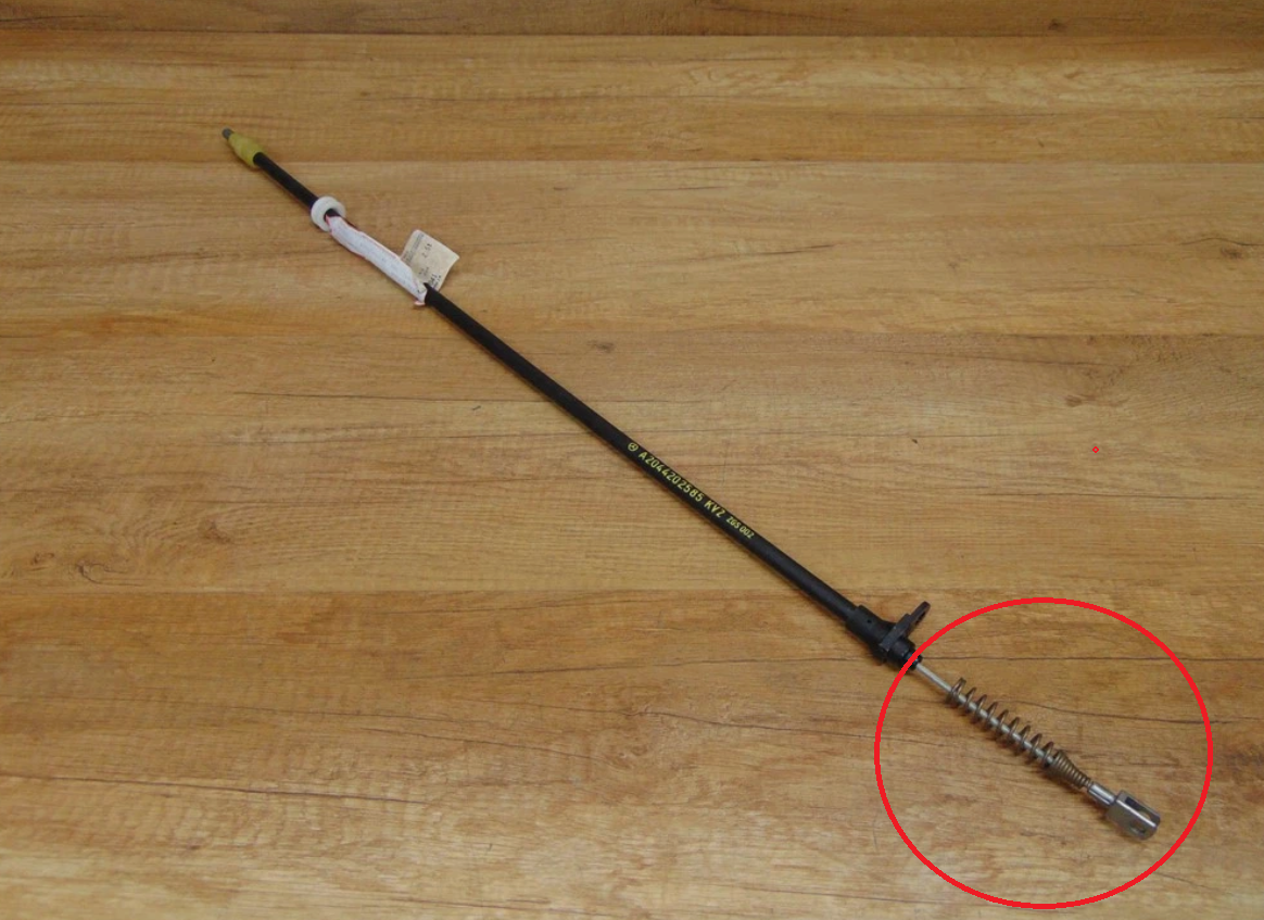

Hey guys my foot brake/parking brake keeps getting stuck and wont release or spring back when i pull the hand catch, i already replaced the whole assembly with a new one about 3 years back and already it's stuck to the floor again and barely releasing. Is there an aftermarket kit or fix for this to make it stronger? i dont get why my E550 has never had this problem but my C63 is plauged by it. Indy wants $550 to replace the assembly.

Hah ! I am in the same boat as you except my other MB where the parking brake releases just fine is my 2014 CLS550. And the C63's parking brake is indeed sticky. I believe many of the C class platforms from this era have this issue - my 2015 GLK that has been sold had the same problem. It is a design flaw I expect and we will have to live with it. Don't bother replacing with another new part - the same issue will arise in time. I know - I had the part replaced on my GLK in the past and nothing was resolved. I use my left foot and encourage the parking brake to release ( push upwards with your toe hooked underneath) while simultaneously pulling on the release catch. Great job Mercedes, great design right here !

Common issue on W204 C63. The return spring inside the pedal assembly is too weak. New assembly will fail again. Don’t bother with aftermarket none worth it. Best fix: lube the cable and mechanism with white lithium grease, then manually help the pedal return with your foot every time. Or pay the indy once and hope it lasts. Annoying but common. E550 has different design.
