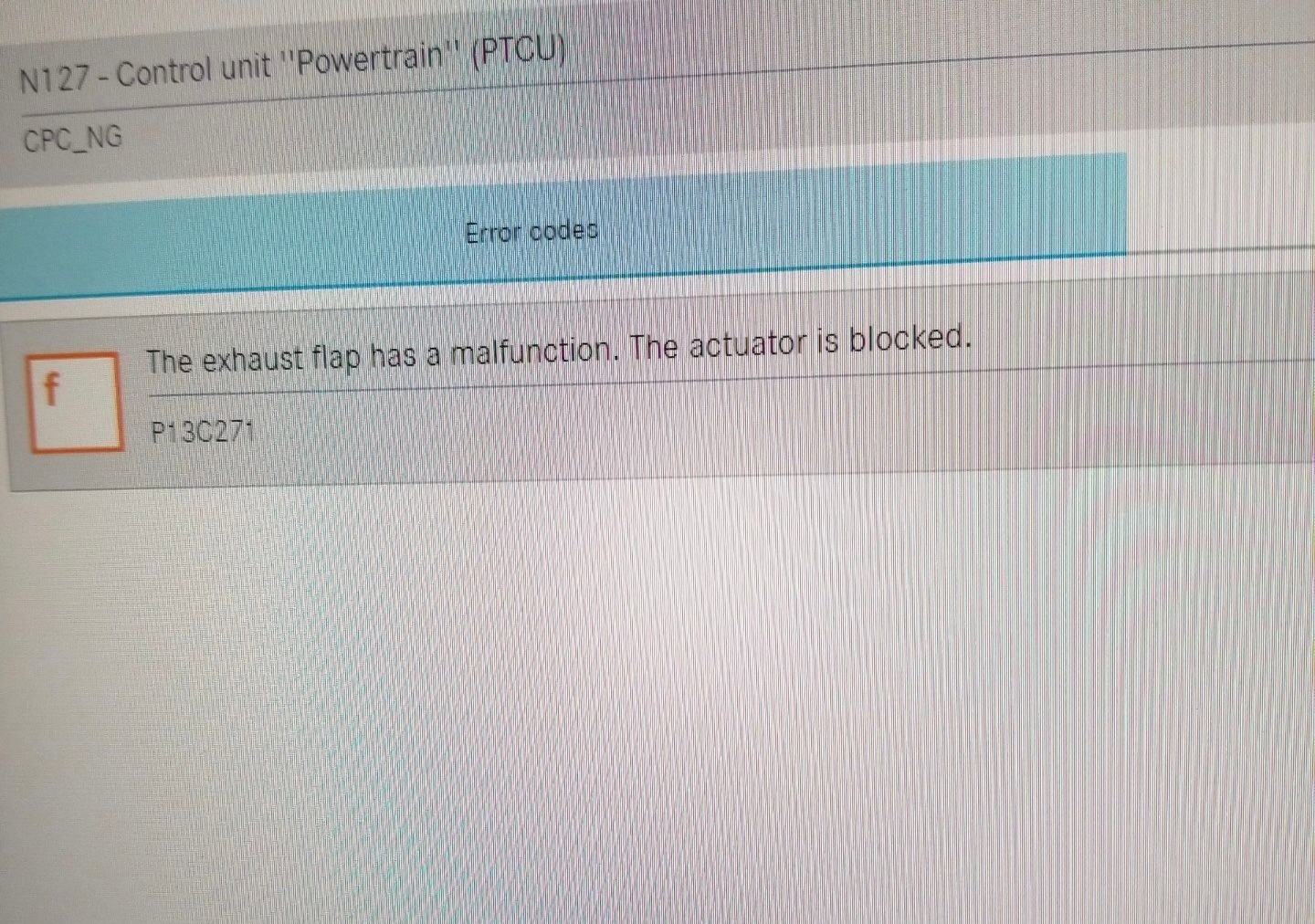

Ok update.
I looked at my engine data. Boost bar fills up, tq hits 479 before dropping off at 5kish like usual. HOWEVER, HP never goes above 330.
No wonder this thing feels slow af. I don’t understand how the car is giving 479lb of tq, but only 330hp instead of the 469hp. So bizarre.
Any ideas?

That sounds like your car is in power limp mode. Happens when there was a power failure and needs to be reset by a dealer. You may have some electrical components exposed and water got into them causing an electrical failure. Did you read out the error codes to see if anything got logged?

No error codes popped up on the dash.
no lights of any kind. I don’t have a code reader to even check.
