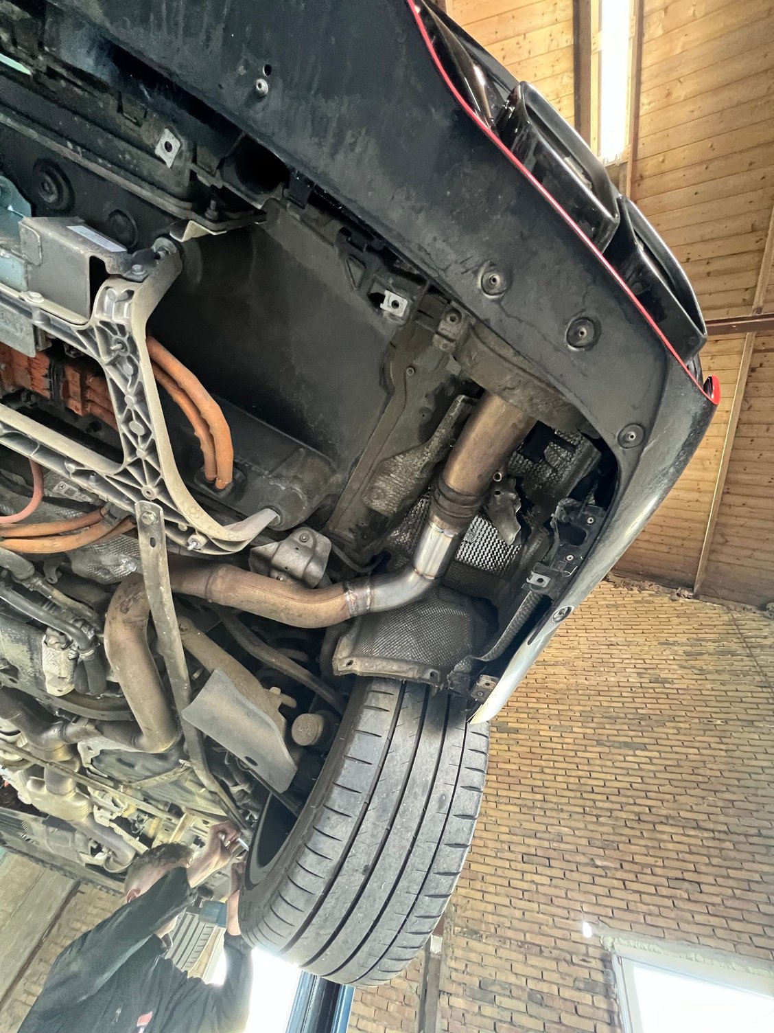

Finally I also removed a resonator. The mechanic opened the resonator and welded all the small holes in it closed, so that a straight pipe was created. Then he welded the resonator closed again so that you do not see anything on the outside for the warranty. I also removed the silencer on the right side (the silencer that opens with the button) but left the valve in between so that it still works. the sound is a lot better with every shift a bang and downshifts too. even in comfort sounds good but not exaggerated. Done 6k KM with it no problems no drone.
