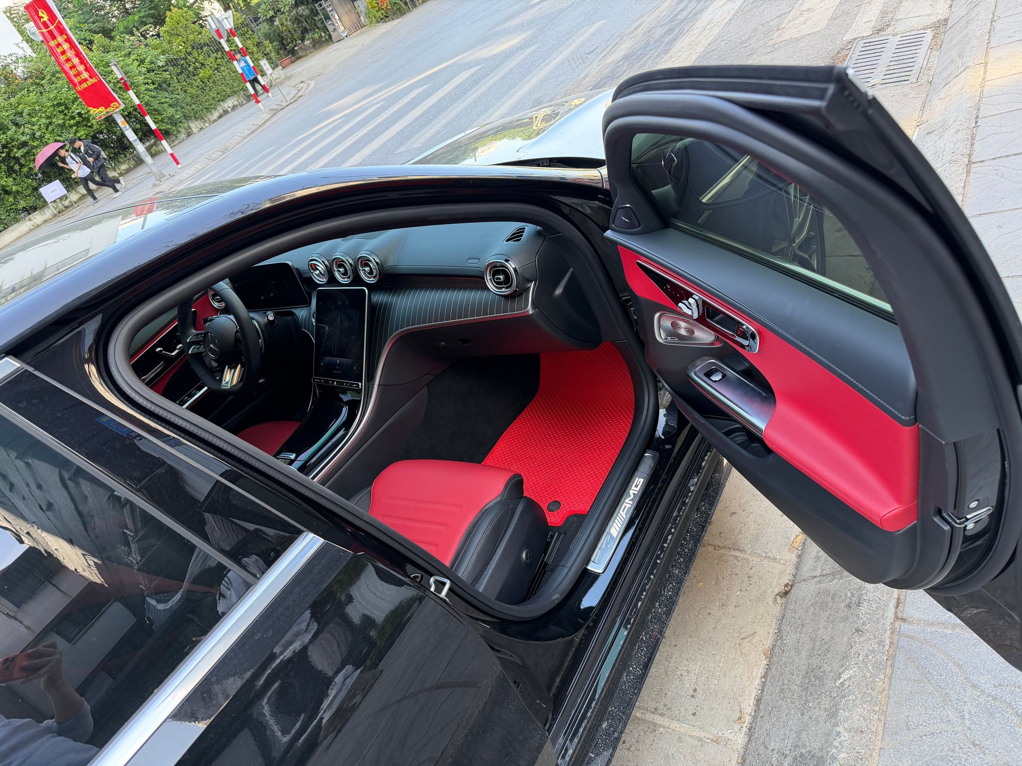

I’m owners of a 2023 AMG C43 (W206), and I’ve got a persistent rattling/clicking sound coming from **just above the driver’s head**, near the **overhead speakers/sunroof area**.
Here’s what I’ve done so far:
• Completely removed the entire Overhead Control Panel (OCP) and isolated it outside the car while driving – the **noise is still present** in exactly the same location.
• The noise occurs primarily when driving on **concrete slabs or rough surfaces**, and it’s a light “tack tack / click click” when the body flexes.
So: the OCP is NOT the source.
