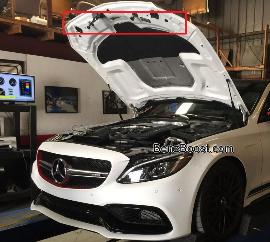

Quality control
My 2017 C63 S coupe with 500+ mile has some creaking and rattling sound around the cabin. Anyone else having this? Also just notice when washing my car that the hood is slightly lower than front bumper and does not sit flush.
If you pop your hood, look at the top of the hood. Look for the bump stops or whatever and see if they are adjustable. Some times you can turn them for adjustment.
Look at the red box area for reference.

Thanks everyone for all the help. Was able to adjust my hood so everything is flush now just 500 more breakin miles to finally release the beast
Did my instructions actually work?

Originally Posted by Palpatine
What... You were just guessing? Lol
You have to remember, I am still waiting on my car to arrive and couldn't physically check myself. I have done a lot of hood swaps and all of them usually have the adjustable part under the hood towards the front. With my luck, MB would not and the adjustment would be at the hinges towards the windshield. I guess it was there and it worked
