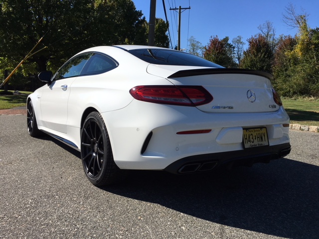

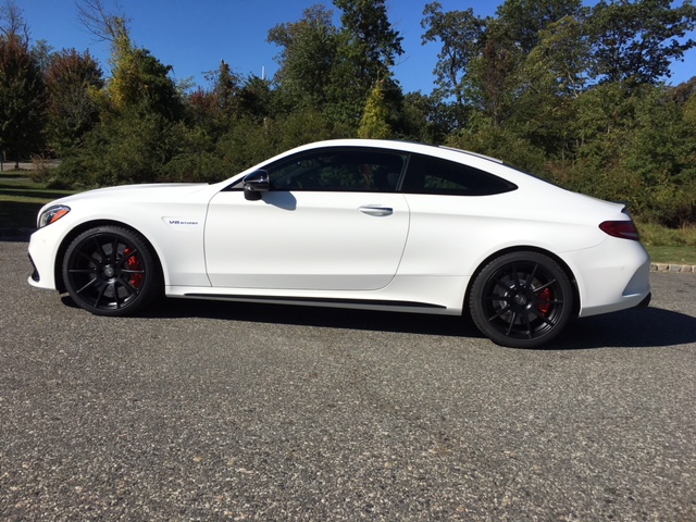

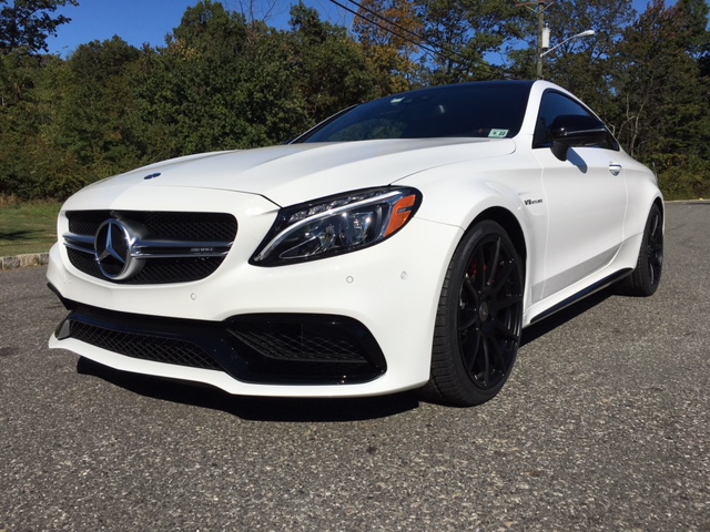

For those of you who are still looking for winter wheels/tires, here's a possibility: Forgestar CF10, matte black
Front: 19x9 et 25, Sottozero 3, 255/35
Rear: 19x9 et 40, Sottozero 3, 255/40
The offsets are the same as the OEM 19/20 wheels and the roll diameter is within 2%
$3k shipped, balanced, mounted, with TPMS and with black bolts.
They look great IMO, the fit/finish is superb... if I were to order again I'd probably go et 20 in the front to push them out a tiny bit more.

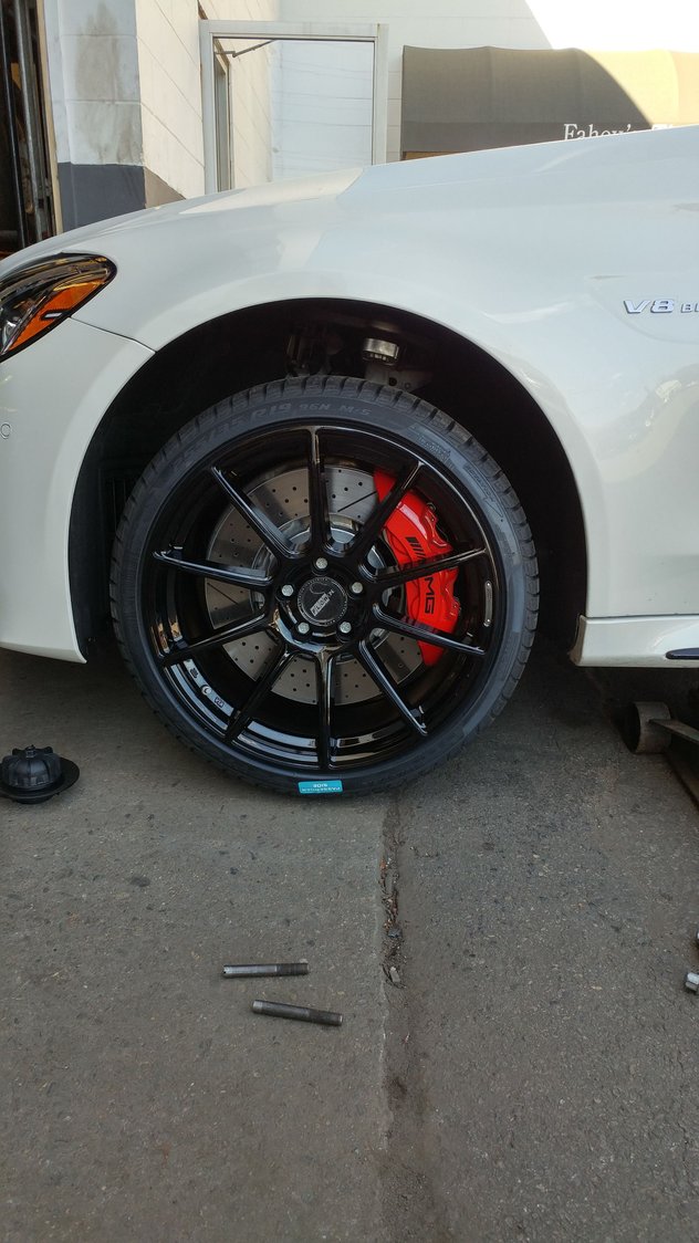

Coincidentally, I just received my tire and wheel package from Tire Rack. It was shipped to the local tire shop and they did a fitment to be certain they were ok. Seems to be fine. Please see invoice and picture of front wheel on the car.

Very nice. Your front wheel will be set very far in with ET 40, you may want to consider using a set of spacers up front?
