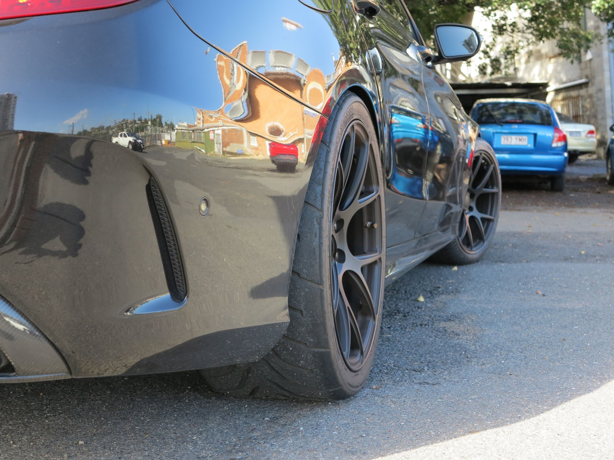

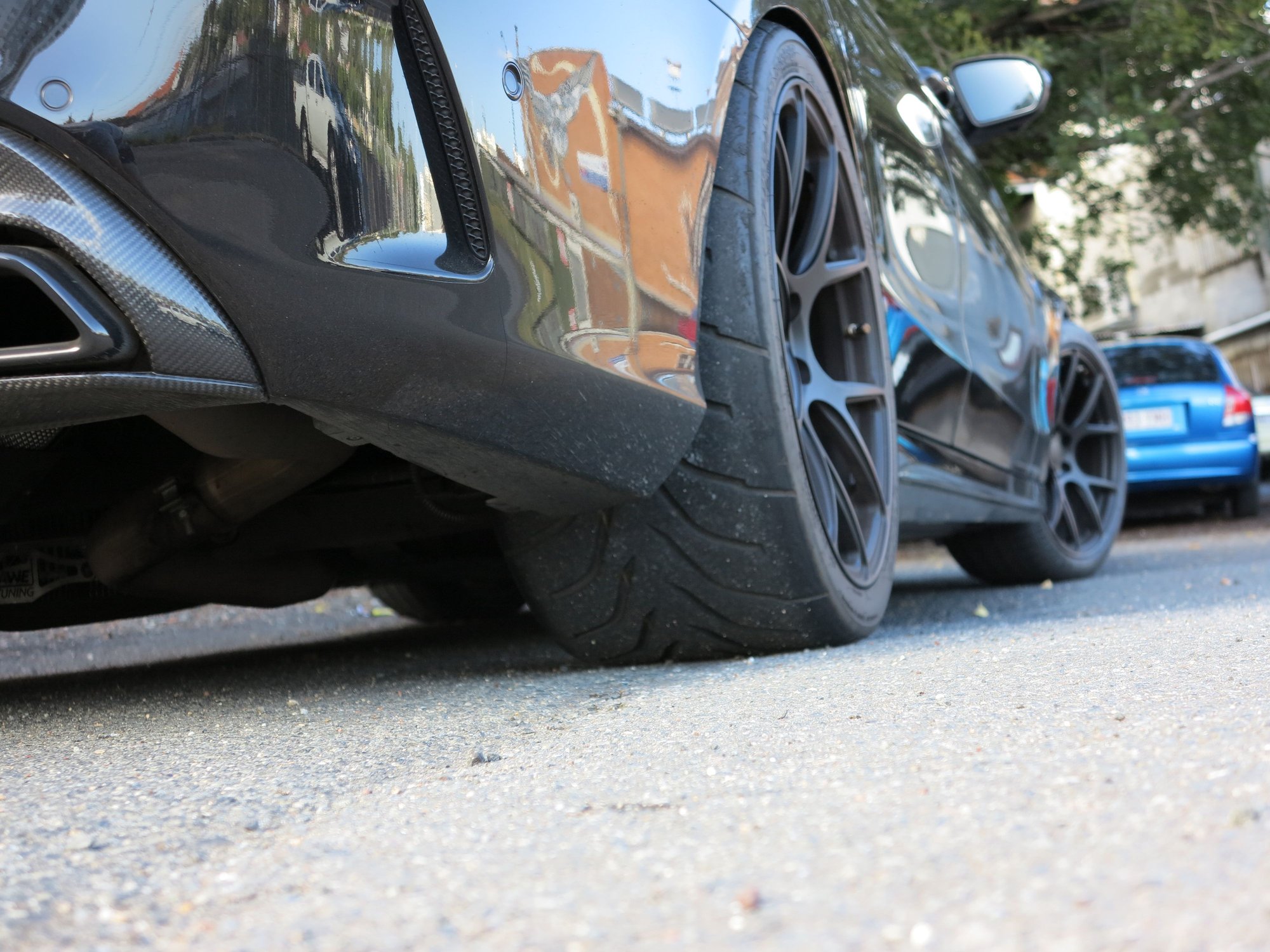

These are my wheel specs for W205 C63S Sedan.
F19x9.5 et30 - BC9.4 kg = less 1.3 kg than stock
R19x10.5 et57 - BC9.4 kg = less 2.1 kg than stock
Total weight reduced by 6.8 kg than stock AMG cross spoke wheels.
Points to note with tyres.
Previously ran 295/30/19 Michelin Pilot Sport - width 11.9”
Currently running 295/30/19 Toyo R888 - width 11.7”

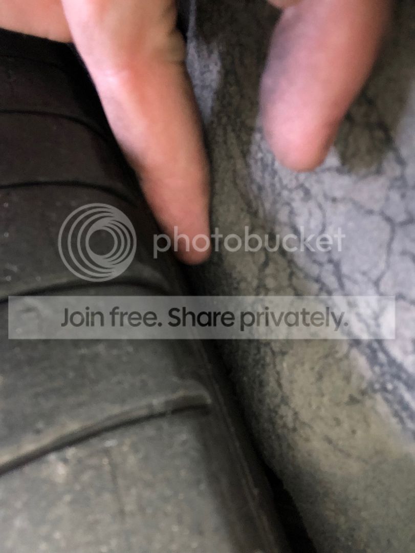

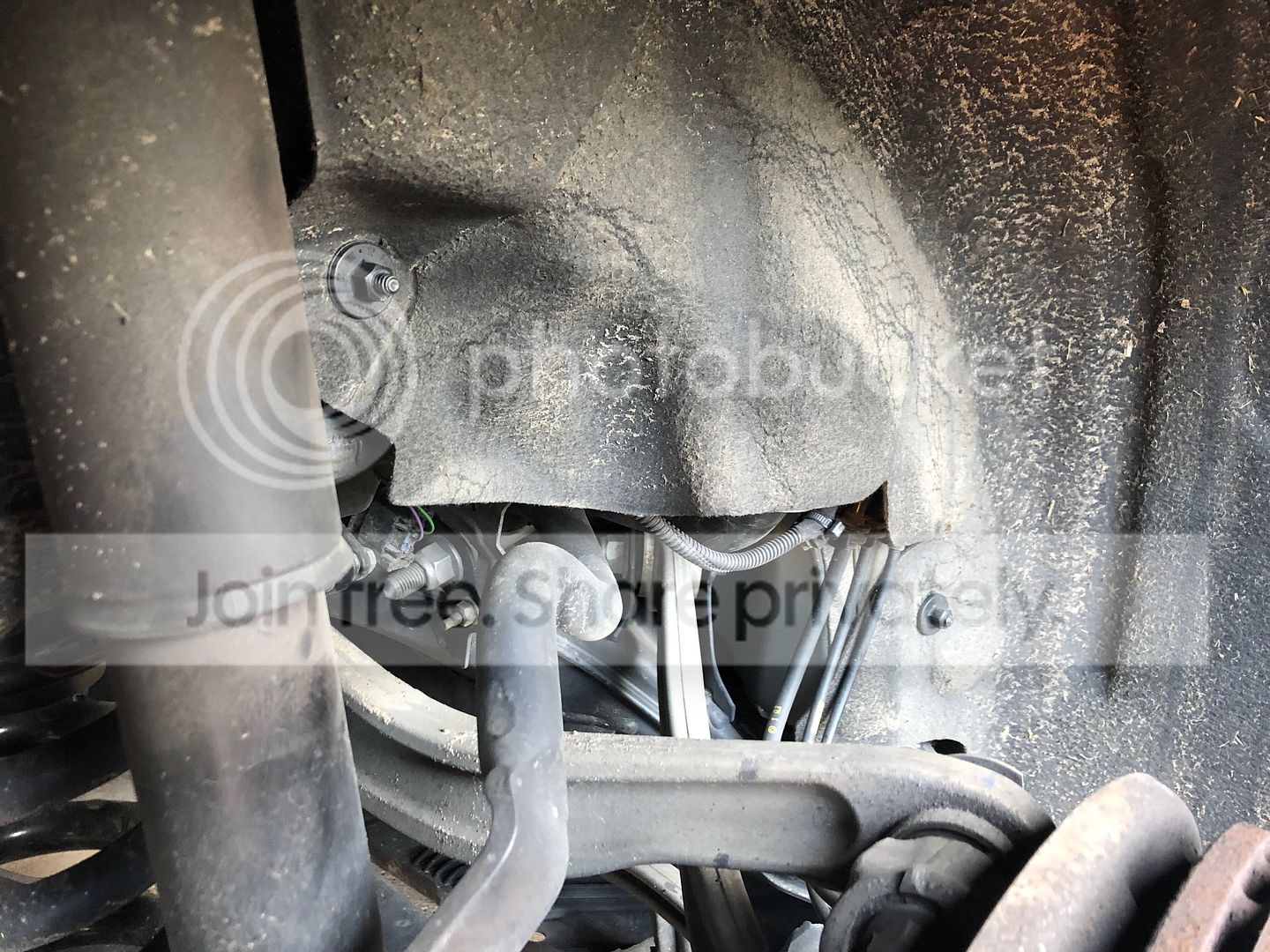

Hello Guys
Maybe i do something wrong , because i have problem with fitting 295 30 19 tires on the rear.
my car is 2017 c63s sedan.
Here is few photo. There is only 5mm between the tire and textil arch cover. Its made with original 265 35 19 tire.
This is looklike without wheel. Its a fuel feed hose, i think.
Here is a video with original 265 35 19 tires.
I tryed with 295 30 19 tire , with 10,5x19 et 57 wheels. No way to fit. After that i tryed with original wheels, but same problem.

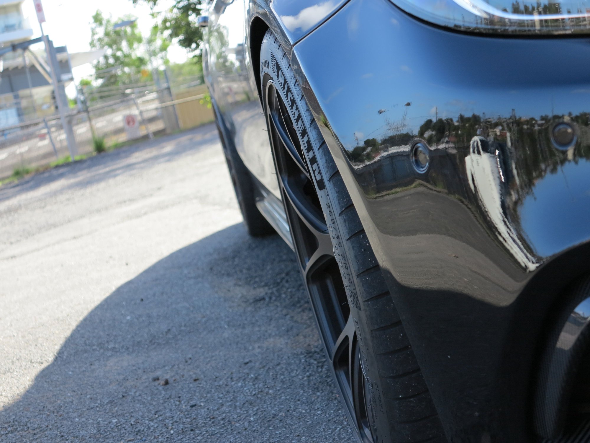

Originally Posted by RDO247
I’ve just recently fitted new BC Forged monoblock 19” wheels.
I can can confirm the below specs will fit C63S Sedan that is lowered 20mm f&r and fitted with K-Mac f&r camber kits with 1.5 neg camber front and -1 neg camber rear.
Front: 265/35/19 PS4S / 19x9.5 et 30
Rear: 295/30/19 PS4S / 19x10.5 et 57
Hope this helps.

Originally Posted by aronmatic
Hello Guys
https://youtu.be/5gnTuearRiE
Did you ever get the answer to this?
