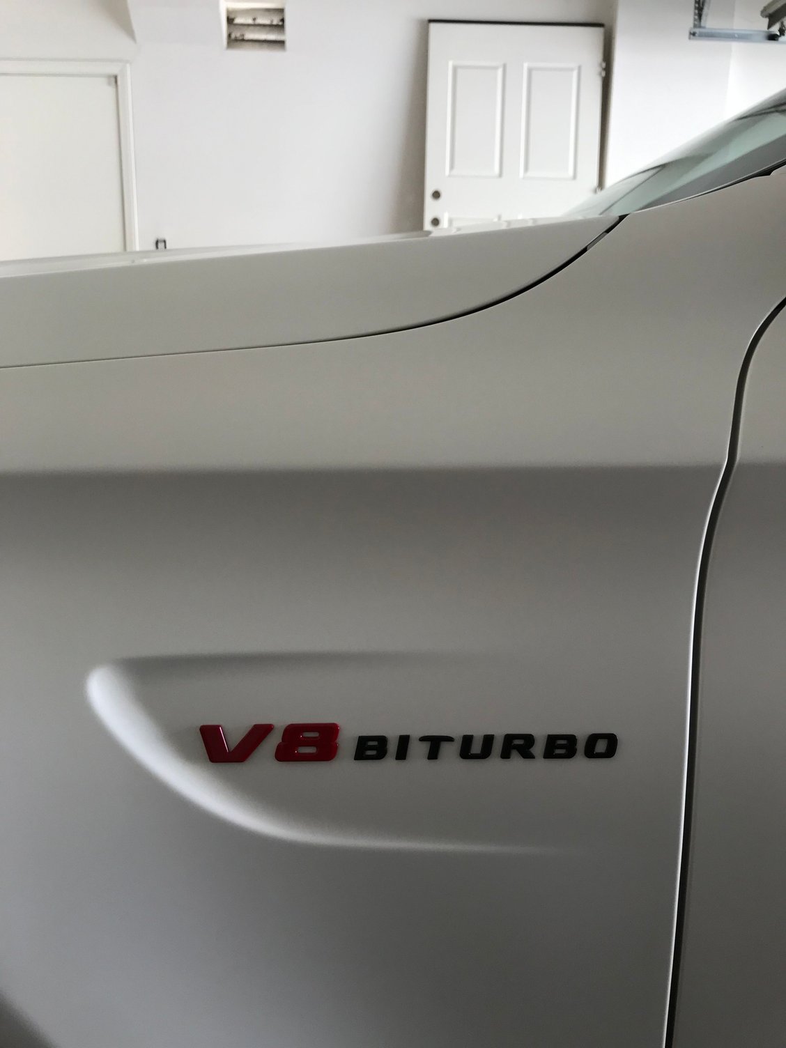

I just did my blackout badges myself on Matte white color. I used q-tip dip into the rapid remover. This way, I have full control applied the rapid remover onto the glue. Don’t spray, you might get it all over the paint. Allow 2 mins for the solution soak it then use the q-tip to push it out.

Awesome result, great looking car!
So just to be sure - those are actually new emblems and to get rid of the adhesive from the old emblems you used q-tips dipped in rapid remover?
By the way, how did you remove the emblem on the trunk?

Yes, those are new badges. I used fishing line to removed the oem badges. I used my thumps to rubbed
as much adhesive out as possible. Instead of spray the rapid remover solution on the adhesive, i used q-tips to applied the rapid remover onto the adhesive. This is the only way to keep the rapid remover off the paint as much as possible. As for removed the trunk badge, I used fishing line them a big flat head screwdriver with tape around the head to prevent scratching the paint then pry it off one corner as a time.
