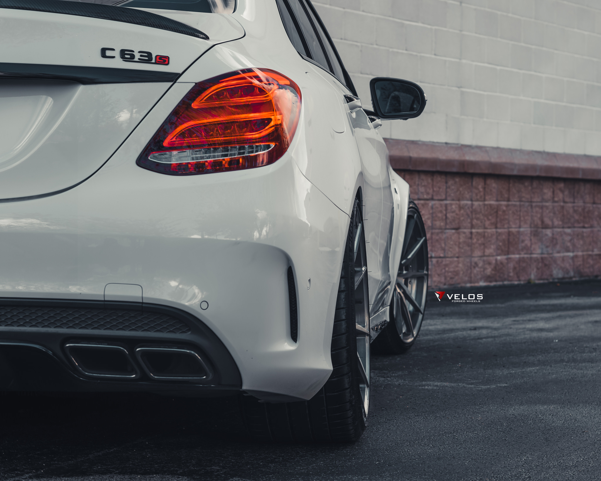

I can understand that. After the tune and downpipes, my car is setup this way with our Stage 2 tune, the car wakens up tremendously. 1st gear is basically spin city if launching from 0 and 2nd is where grip starts to take over.
The Michelin PS4S do a really good job of fighting the traction loss even with a 285 tire, and if you eventually go 305 it will grip a bit harder as you have more surface area touching the ground.
