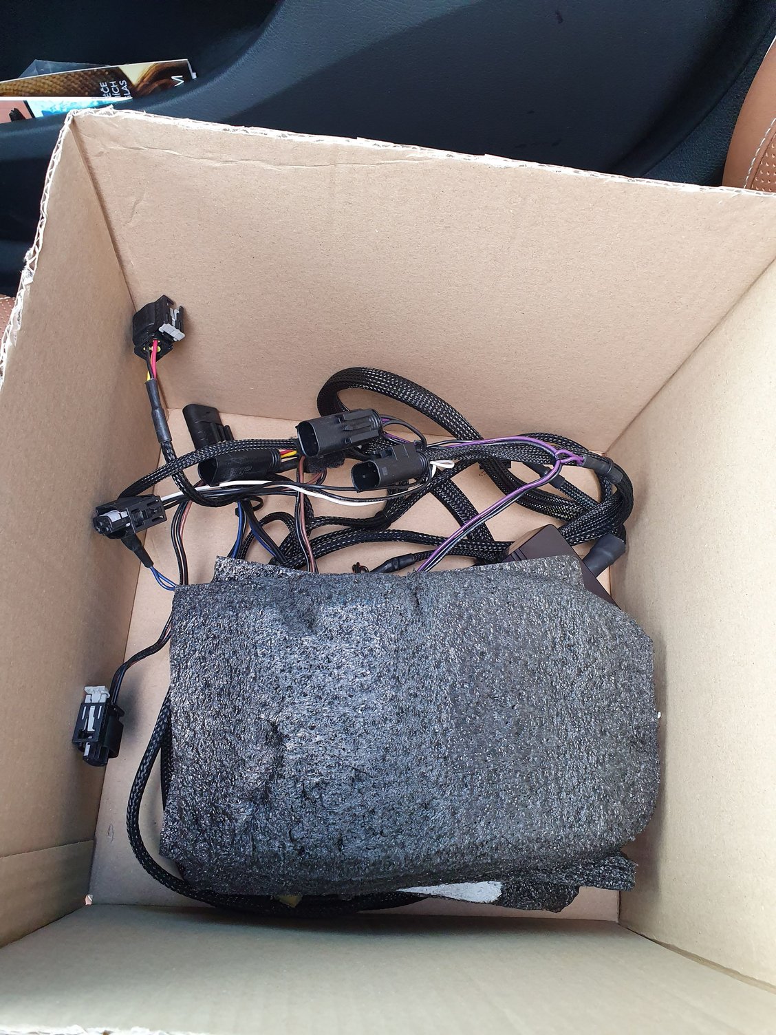

I had fully functional 2017 C63, since I installed JB4 I had problems.. after few days firtst misfire then CEL's, rough idle, sometimes weird behavior of rpms.. it was not right since I installed it. BMS said change plugs to new one which I did and I have to say shop didnt make it well so they fixed it at the dealership... Car was still putting CEL s, start stop not working, loud start sometimes not present, it was just NOT RIGHT.
It ended up with car running like **** pump, I was unable to drive so I had to tow the car to dealer ship where it spend 3days..they checked spark plugs, coil packs, injectors and even measured pressures in valve chambers.. when they out it together it was still not going well, but when they tried every piece separately problem was not present. so they decided tk remove jb4, reflashed engine software and car is running great.
All my problems started with JB4 install, all of then dismissed when it was removed.
Maybe I was just unlucky and my jb4 is faulty.. (I was one of the First in the beta and after received jb4 I got email from them that I have to repair the board.. so maybe boars is wrong.. they think tha maybe some of the connectors are wrong.
I have to say that BMS sometimes commented in my post, but their solution to this behavior of jb4 was "use map 6 with 3psi".. but it was not good for the engine

Not sure why you have an injector circuit code when JB4 doesn't touch the injectors. Sounds like a botched install with something being unplugged in the process, but not replugged when buttoning everything back up leading to multiple misfires
