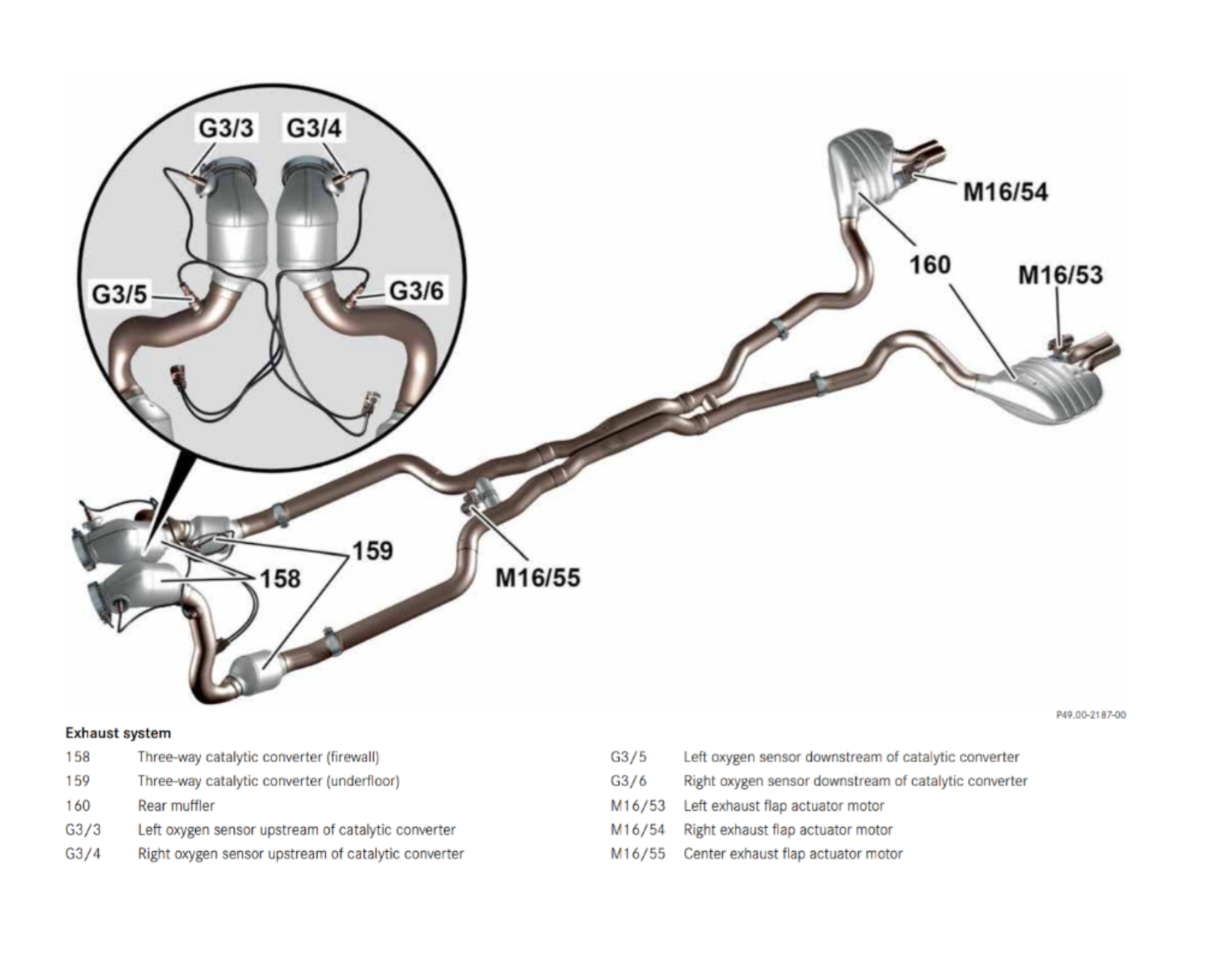

No. They simply cut them out and weld pipes in place. Easy.
Below is the exhaust diagram from the tech manual. Number 159 on the diagram are the secondary cats.

Maybe a dumb question - but how would they weld around it w/o dropping the exhaust...and if you do that they may have to drop the tranny to get access to drop the pipes ...if the tranny needs to be dropped to properly access the welds around the pipe than the quoted price is not so far away as that is a lot of labor and tranny fluid would need to be refilled too?

its a tough weld but its possible.. that is why not all shops will agree to do the job in the first place but speaking from experience you definitely do not have to drop anything for just a secondary cat delete.
